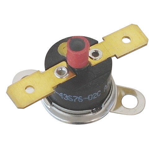

  2. SplashFl
    SplashFl Senior Member
    Feb 2, 2021
    729
    S. Florida _ Bertram 46

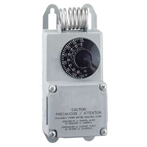

    Not finding Honeywell brand but these attic fan controls showed up. Either look like yours ? Not yet heard back from HiTide.

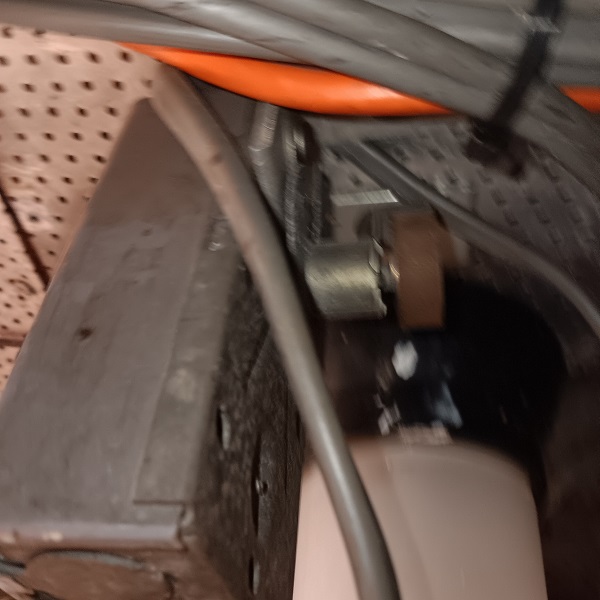

  3. Capt Ralph
    14,574

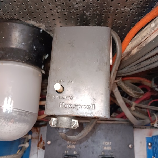

    Mine looks just like yours, just never noticed that thingie poking out.
    I'll be onboard later today. I'll try to get some pictures and part number.
    Found these;

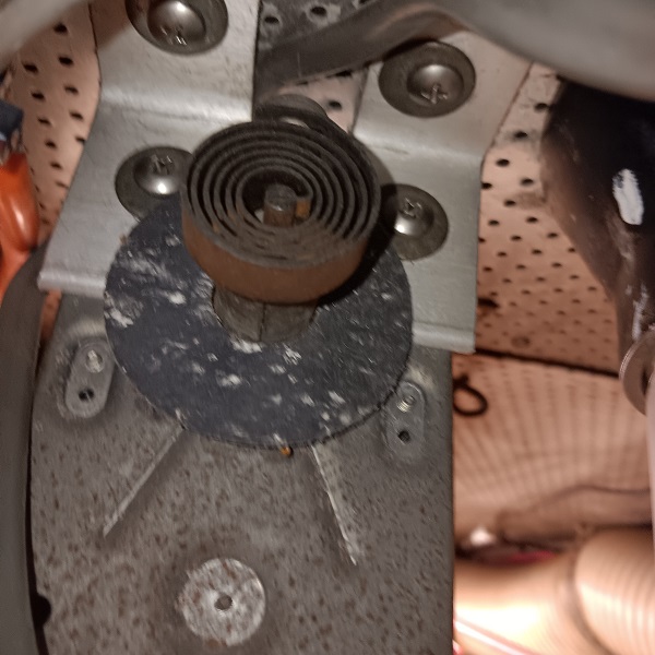

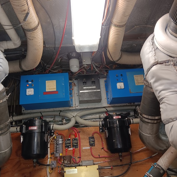

  5. Capt Ralph
    14,574

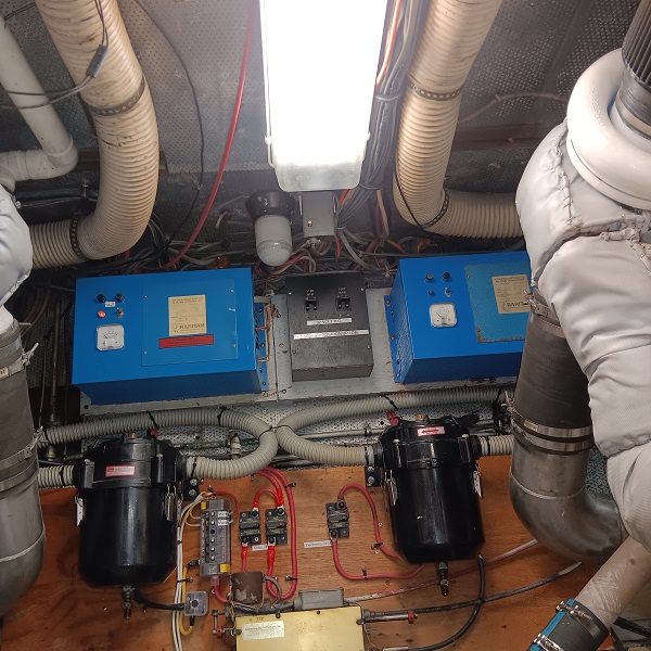

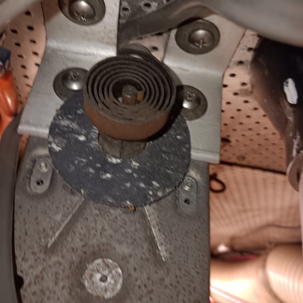

    Here is my thermo switch. Yep, the clock spring in the back looks like heck but after 46 years untouched, still works like a champ.
    Mounted high on the aft/center-line.
    The 4" duct you see in the last picture picks up from the overhead in the middle of the E R and goes to the thermo activated blowers.
    Please excuse the wire mess over the battery chargers. After replacing the mechanical engine temp leads to the lower helm and pulling other leads, I have yet to return here to clean up the spider nest.

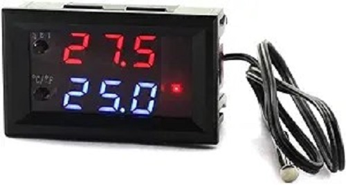

  6. SplashFl
    Feb 2, 2021
    729

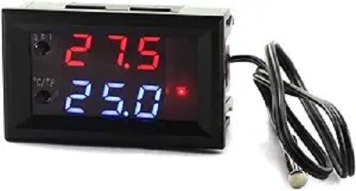

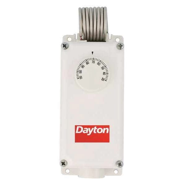

    According to HiTide, it's no longer made. Danny said hunt with Google which brought up the one with the long probe I removed. I did just find this digital one on ebay that's really cheap and may just work. https://www.ebay.com/itm/295066984965

  9. SplashFl
    Feb 2, 2021
    729
    I found several like my old one with the long probe but I hate rust so want one without that long probe my old one has. The digital one was already shipped and Amazon has a very easy return policy so I figure worth a shot.
