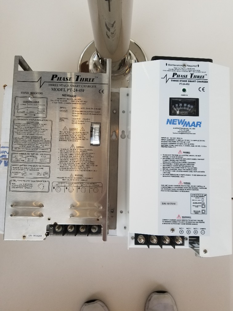

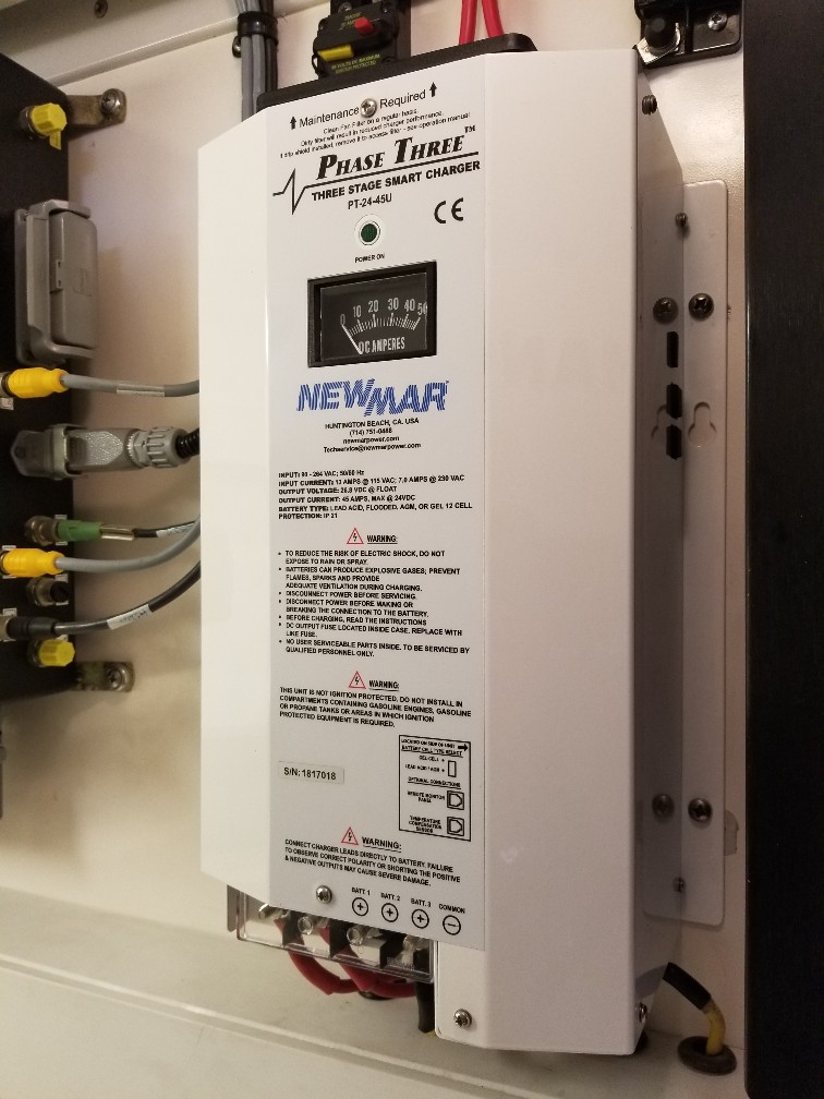

    My Newmar died last summer and I too chose to not have them refurbish the unit. After looking around I replaced with the replacement model from Newmar and have been happy. Only gripe I have is the replacement model mounting pattern is an 1/8th different. I mean really...
    Check Hodges Marine for pricing and if they carry the larger model you are needing. They have great pricing.
