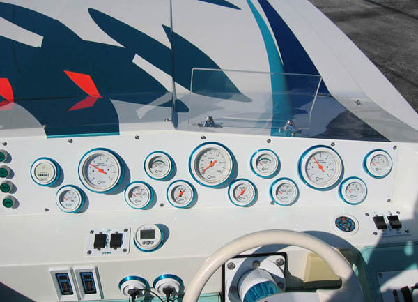

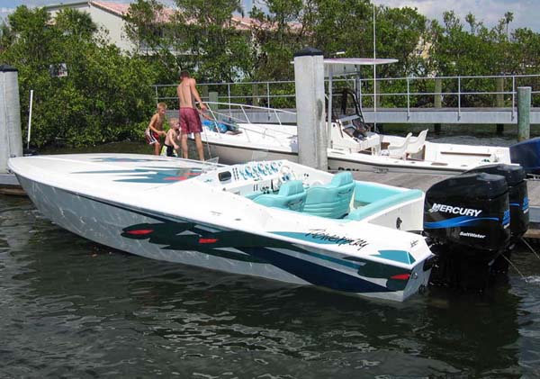

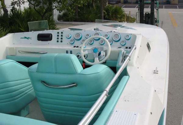

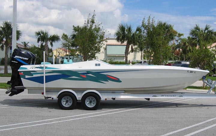

    $32,500 to a YF member. $34,500 to anyone else. I'd like to see it go to a good home. Here's the specs and a few more pics...
    A 1991' 25’ Powerplay Sportdeck purchased from the original owner in 2003. It had 200 original hours on the hull and motors and had been stored inside a hi & dry marina. In 2003, I had the factory completely re-rig the boat with a new instrument panel, Gaffrig gauges, stereo system and 2003 Merc 200 Opti's. The engines have now 250 hours on them. The boat has always been stored indoors or covered.
    Last year, I installed Mercury's new hi-perf steering system (like SeaStar, but more robust). This included a new helm and new cylinders, plus plumbing. The steering is silky smooth. The boat is perfect and needs nothing. I've had the boat up to 77 mph and it will cruise all day at 60 mph, sipping very little fuel.
    It is without question, the finest example of the 25' Powerplay in existence. I've maintained this boat with an open checkbook. I recently bought a 33' Powerplay, so it is time to let a new owner have my 25'. FWIW... I have about $60,000 into the boat.
    Equipment list:
    • 1991 25’ Powerplay Sportdeck.
    • Twin 2003 Mercury Optimax 200hp. Offshore Outboards.
    • 3-Blade, 24” Choppers.
    • Double Axle EZ Loader Aluminum Trailer w/ galvanized steel guide posts.
    • Mercury Dual Ram, High Performance Hydraulic Steering System.
    • Momo Steering Wheel.
    • Complete Group of Gaffrig Gauges.
    • Bennett Trim Tabs.
    • Jensen Marine Stereo & Speakers.
    • Latham Split Control Gear/Throttle Shifters.
    • Full Canvas Cover.
    • Full Cockpit Cover.
    • Bimini Top with boot.
    • Tripod Ski Pole w/ fittings.

    I like teal green and blue. Dash is well laid out. Good speed and great fuel mileage. The only thing I would change is install a wrap around windscreen. I got tired of racer face real fast with my Carlson.
    And best of all? It's a POWERPLAY. :)
