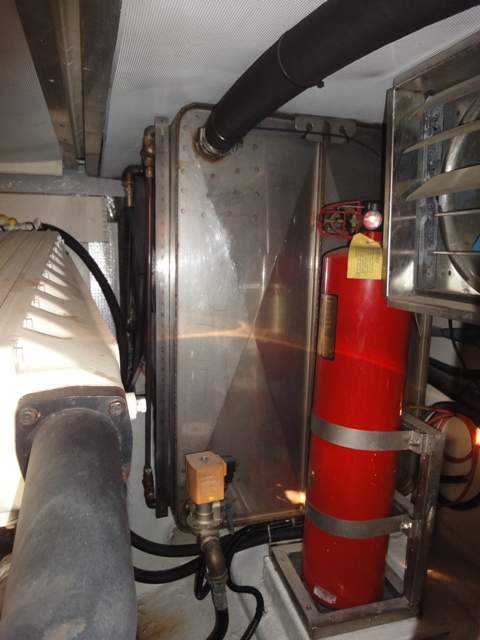

    I formerly owned a 2002 55 Evolution. I can definitively say the following:
    1. The drawings that were published in the Azimut manual are near useless. They were not only "very schematic", they were often wrong. I'll be surprised if there are any drawings that show how the fuel tank is installed.
    2. There were 2 fuel tanks in my Azimut, one on either side of the engine room. According to the manual, they were 330 gallons each. However, about 1/2 of the aluminum tanks were buried between the lazarette bulkhead and the hull. The fuel tank will come out a lot easier than many boats, but it will still be a heck of a project. The following photo shows the starboard side tank on my former boat. Unfortunately, I do not have a photo that shows how the tanks goes back in behind the bulkhead. I would think it would be pretty easy to see the source of a leak, unless it was behind the aforementioned bulkhead.
    I now own a 68 Lazzara, and the difference in detail between owner's manuals is like night and day. The Azimut manual (2002 Vintage) is mostly a binder full of quasi-useless documents from component manufacturers. There is very little that is specific to the actual boat, or the way the systems are installed. The Lazzara (2005 vintage) on the other hand, has actual design drawings, photographs (with labels) of the actual boat during the build, and great details, such as the make/model/serial number for nearly every system installed in the boat. Further, it gives customized instructions for all of the major operating systems in the boat. As an owner/operator, I can't tell you how much I appreciate a good manual.
