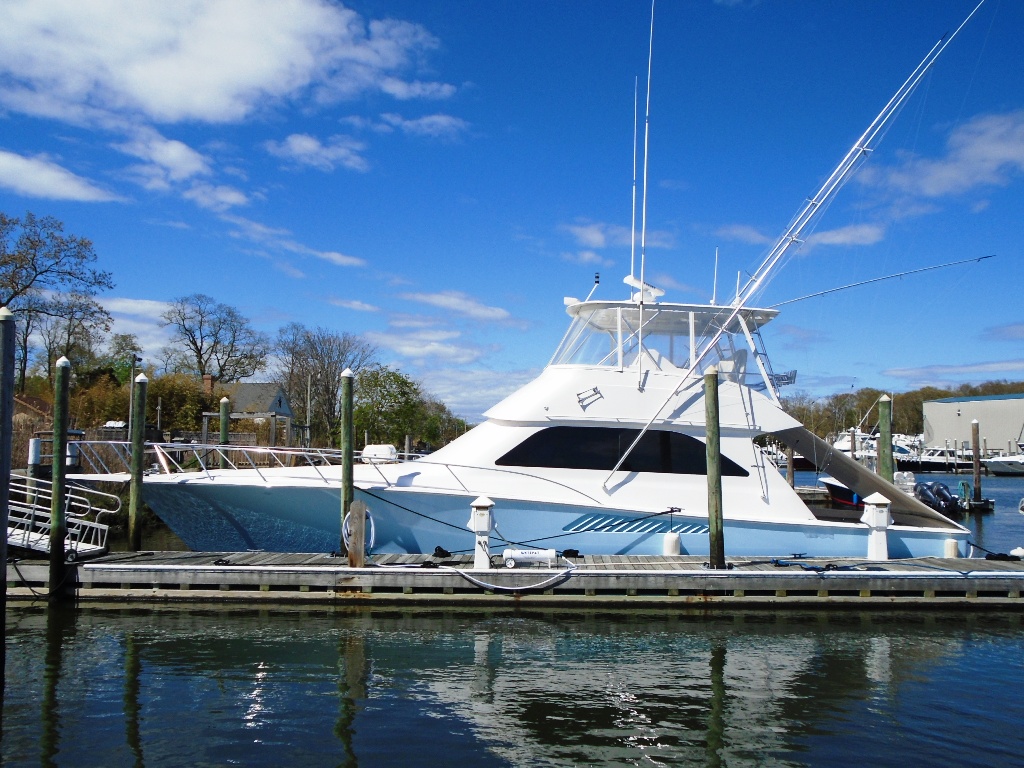

  4. frank lunati
    frank lunati Member
    Apr 4, 2017
    37
    long island,
    I saw you post in another forum that you have the man 1300hp engines... how do you like them? I finally found a boat, not a post, but 2003 viking 52 C with the man 1300's with 700 hrs... went out for engine survey today, boat seemed to run awesome... surveyor said all was good and would have official report in a couple days with oil sampke results..

  6. frank lunati
    frank lunati Member
    Apr 4, 2017
    37
    long island,
    awesome! thanks for the info! can't wait to see pics of your boat! I was/still am upset that the 2 post 53's I found wouldn't come down on price.. one actually went up after agreeing on an already high price.... anyway, looking forward to closing on the Viking within next 2 weeks! DSC06080-2.JPG

  8. frank lunati
    frank lunati Member
    Apr 4, 2017
    37
    long island,
    Thanks!! its a 2003, yes... full paint job in 2010 at Viking
