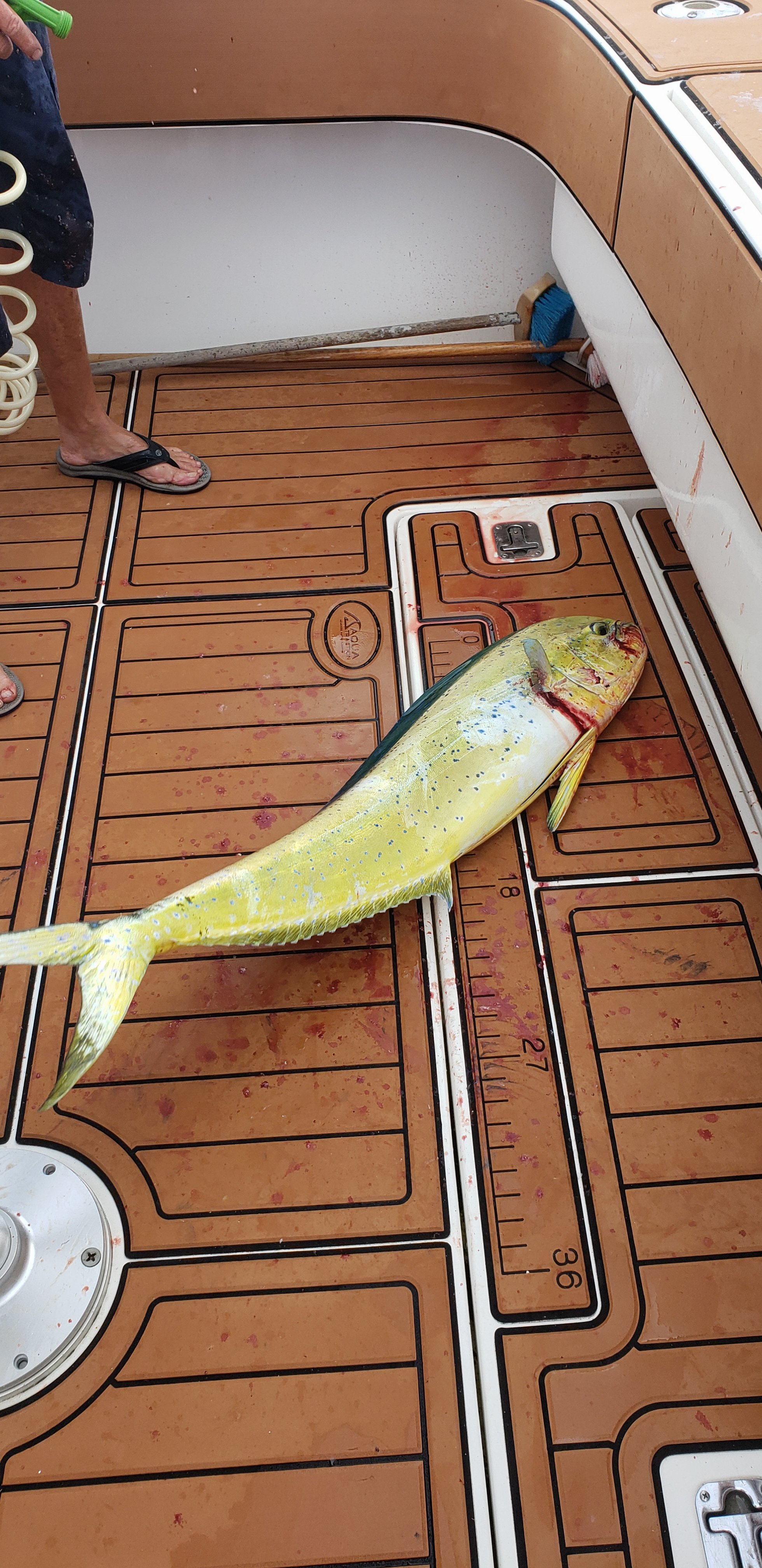

    Nice fish! But more interested in the deck? What product is that? How long have you had it?
  4. Bucksh0t
    Bucksh0t Member
    Mar 18, 2018
    76
    Morehead City NC
    AquaTraction, We are the dealer for NC
