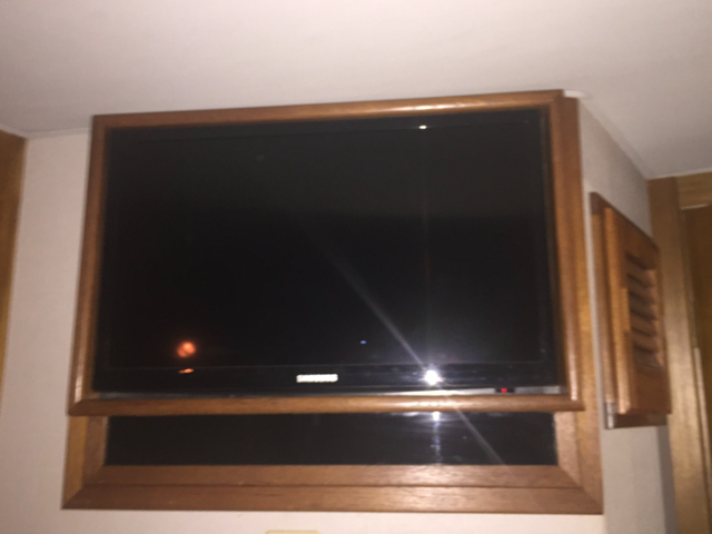

    We had the little square tv also, I had this surround built, and put a door to access behind. Note the bottom, the tv electronics are behind that plexiglass on the left 1/2...just covering the wall on the right but it added balance.

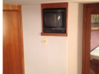

  11. My Affair
    My Affair Member
    May 23, 2006
    115
    Mystic, CT
    Here is the 1988 46 original...hope this helps.

    After I removed the old tv and trim. A tv surround was built to accommodate the tv, it looked like a glorified snack tray at first, then using a tracing of the tv back, cut outs were made, holes drilled to mount the tv. Surround once color matched and completed was then screwed to the wall, mounted the tv by reaching in the new cabinet door cut into the wall and installed, then power and sat connections were completed.
    Note: You should pick a TV with the inputs on the right side back as the left is blank and measure the total tv so that the four mounting bolts are inside the width of the existing cabinet. Enough space was left at the bottom for the directv receiver. The bottom of the surround was routed out for the plexiglass to hide up under the edge, the rest was trimmed out.
