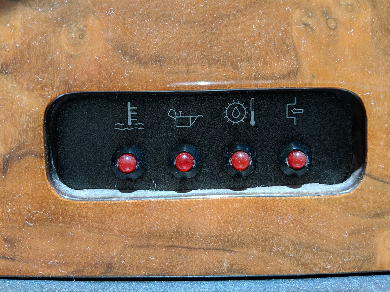

    I am the new owner of a 1999 Sunseeker Manhattan 48. I'm getting to know the boat but am a little perplexed by the warning lights on the helm.
    The fist two seem easy enough; Water Temperature and Oil Pressure. And the third one might be Oil Temp? but the fourth one I have no idea.
    If anyone has any ideas what these warning lights are for I would greatly appreciate the help.

    Both engines have these same lights?
    I assume no manual?
    Cats or MTU?
    My first SWAG is clutch / gear issue,, followed by transom door locked/un-locked.

    Agreed: 1) Coolant Temp; 2) Oil Temp or pressure; 3) Transmission/Gear temp; 4) No idea!! (sorry)

    Engines are twin CAT 3208s. Yes, this strange warning light is in two places at both the upper and lower helm.
