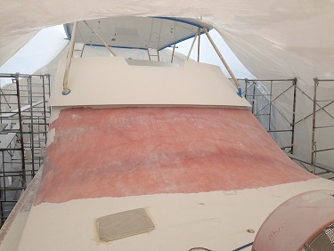

    I’m clarifying my previous post on the Gelcoat issue by requesting any information you have on how to treat the remaining superstructure . The hull and cockpit areas have already been completed by the current seller by painting. How much existing Gelcoat removal is necessary prior to applying awlgrip high build primer and topcoat to the remaining superstructure. The Gelcoat does not look to be crazed but rather long hair lines. Anyone have any experience with this?

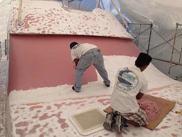

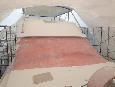

    Hi Dan,

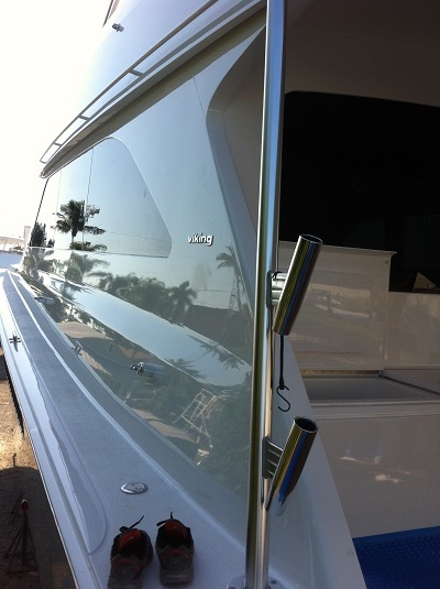

    The gelcoat in the affected area will have to be ground down to reveal the bare FRP underneath. Apply Awl Fair and rough sand and shape with battens for compound curves. Some applicators will mix 545 and ultra build 50-50 for the first coat and longboard down then apply a coat of high build and sand IMG_2793 - Copy (3).JPG again with short boards. Batten the area for highs and lows and sand again with a guide coat. Ive been involved with the early 2000's bad gelcoat with a couple of clients and the last was a 2004 65' Viking 2 years ago that came out perfect. Sorry, don't know how the photo wound up mid post?

    Looks gorgeous. Was it just the topsides and bridge or was the hull included? If you can share, what was the cost to do that Vik?

    This job took place in Stuart, FL. The stripping of the gelcoat was isolated to the exterior of the cabin trunk, fore deck and toe rails back to the cockpit covering boards. Our destructive testing and non destructive investigation and survey of the surfaces revealed that this gelcoats failure and crazing resulted from direct ultraviolet exposure and heat as it passed our boring and hardness testing in shaded areas like the fly bridge liner and under overhangs. Along with the gelcoat stripping and re-fairing the boat received a complete color change paint job from the boot stripe to the buggy top and some additional owner requested custom paint work. The all in number was $120,000 & that number is a soup to nuts with haul & launch, poly enclosure, yard hard time and shore side svc. etc. and it included having a coatings consulting company write the contract, job specification & warranty. Full time oversight with the applicators in the yard, progress reports going to the owner weekly, optical measurement's for wet and dry film thickness of applied materials during and after. Final findings reports with photography and measurements for wave (orange peel) and DOI all wrapped up on C.D. and flash drive for the vessels archives or re-sale use.
