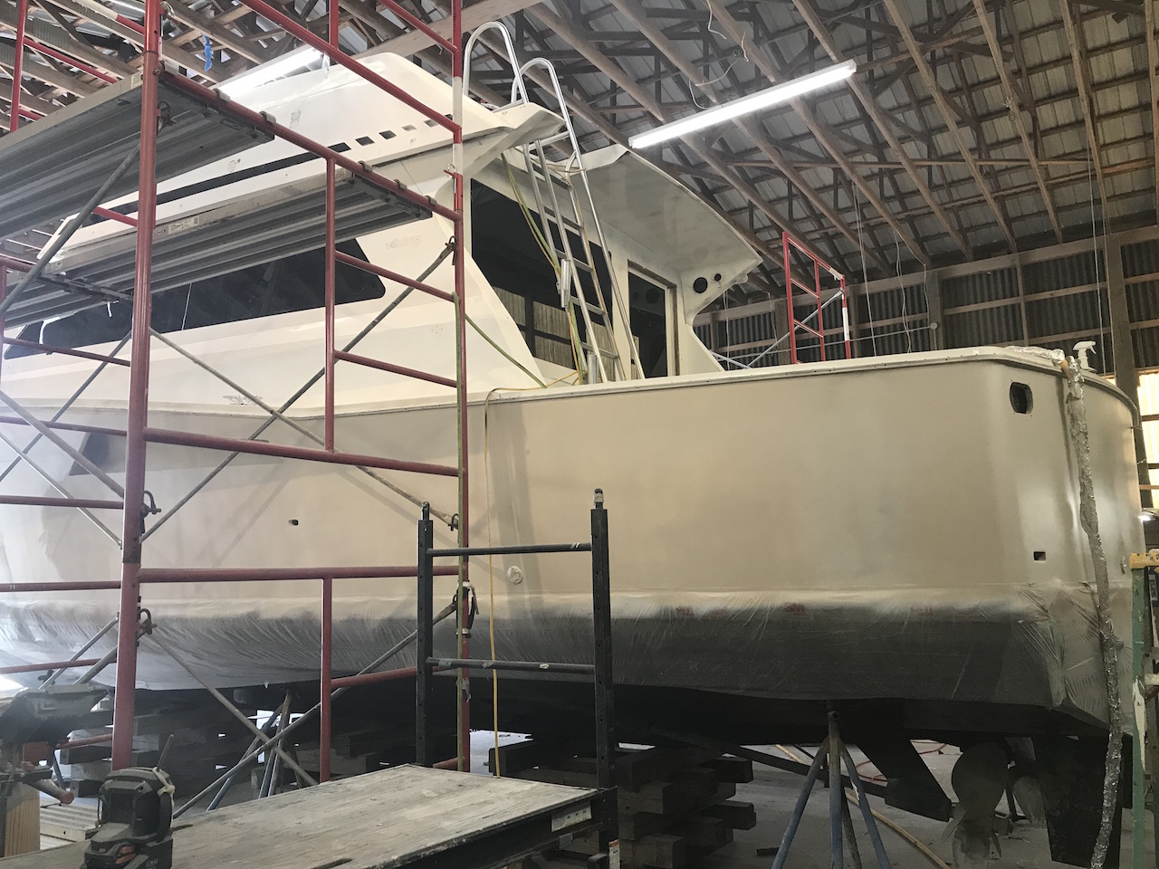

  5. petrel
    petrel Member
    Aug 31, 2019
    99
    Fredericksburg

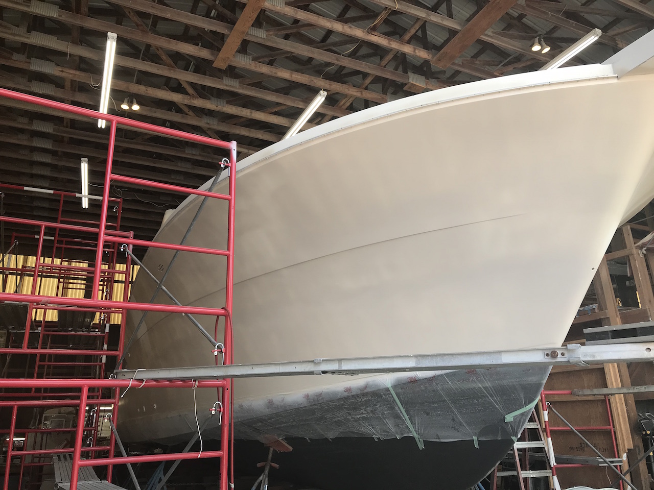

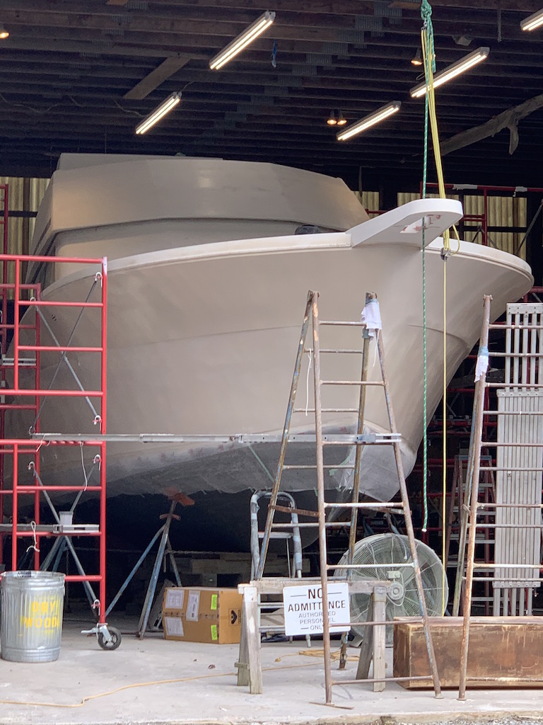

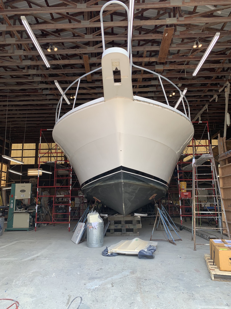

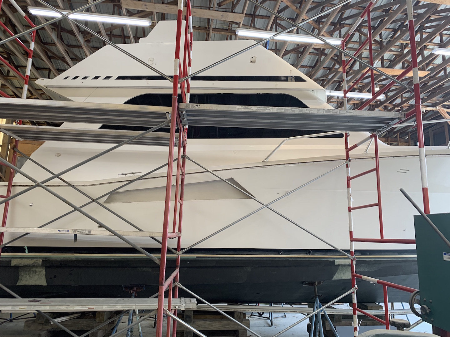

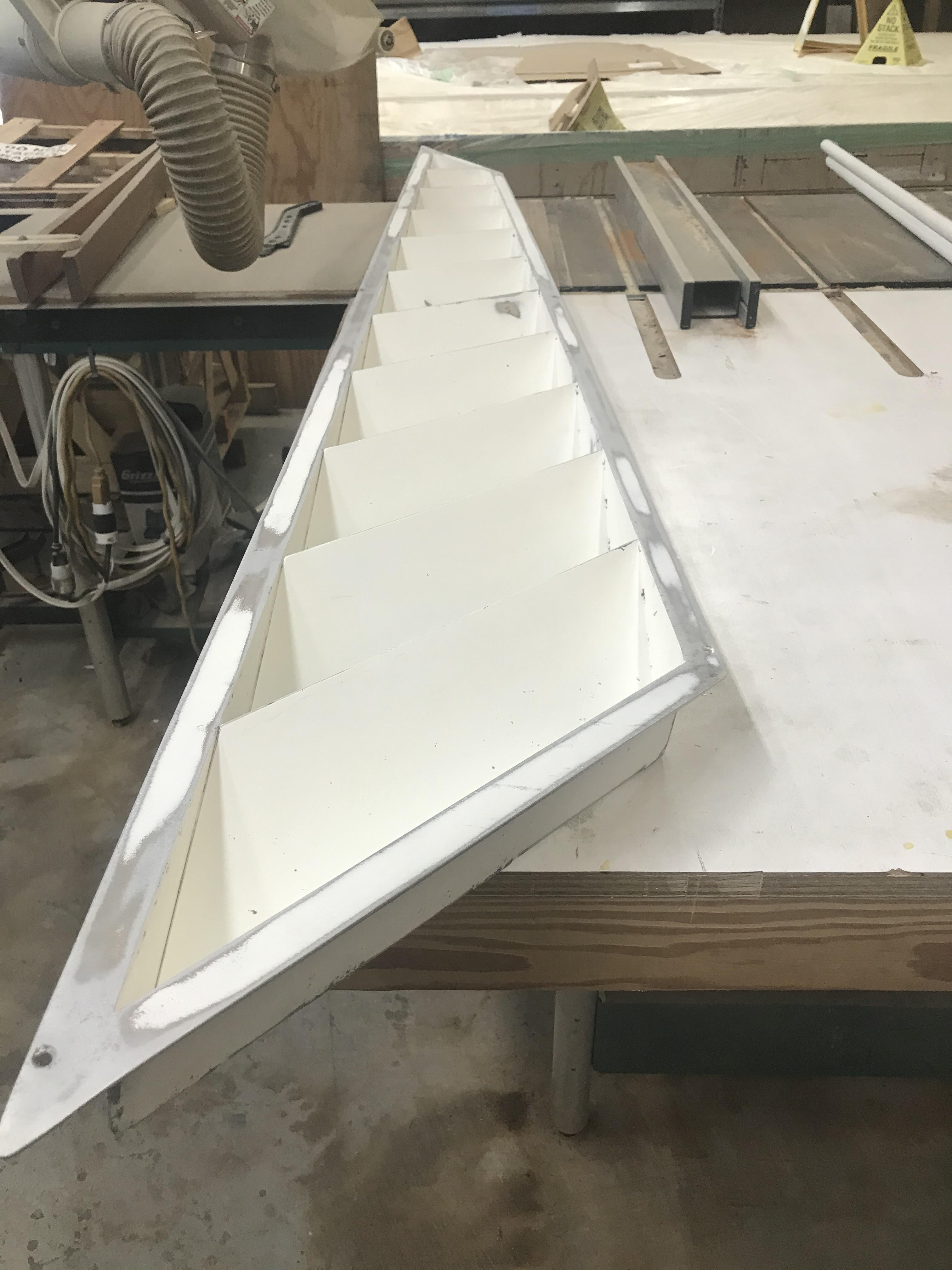

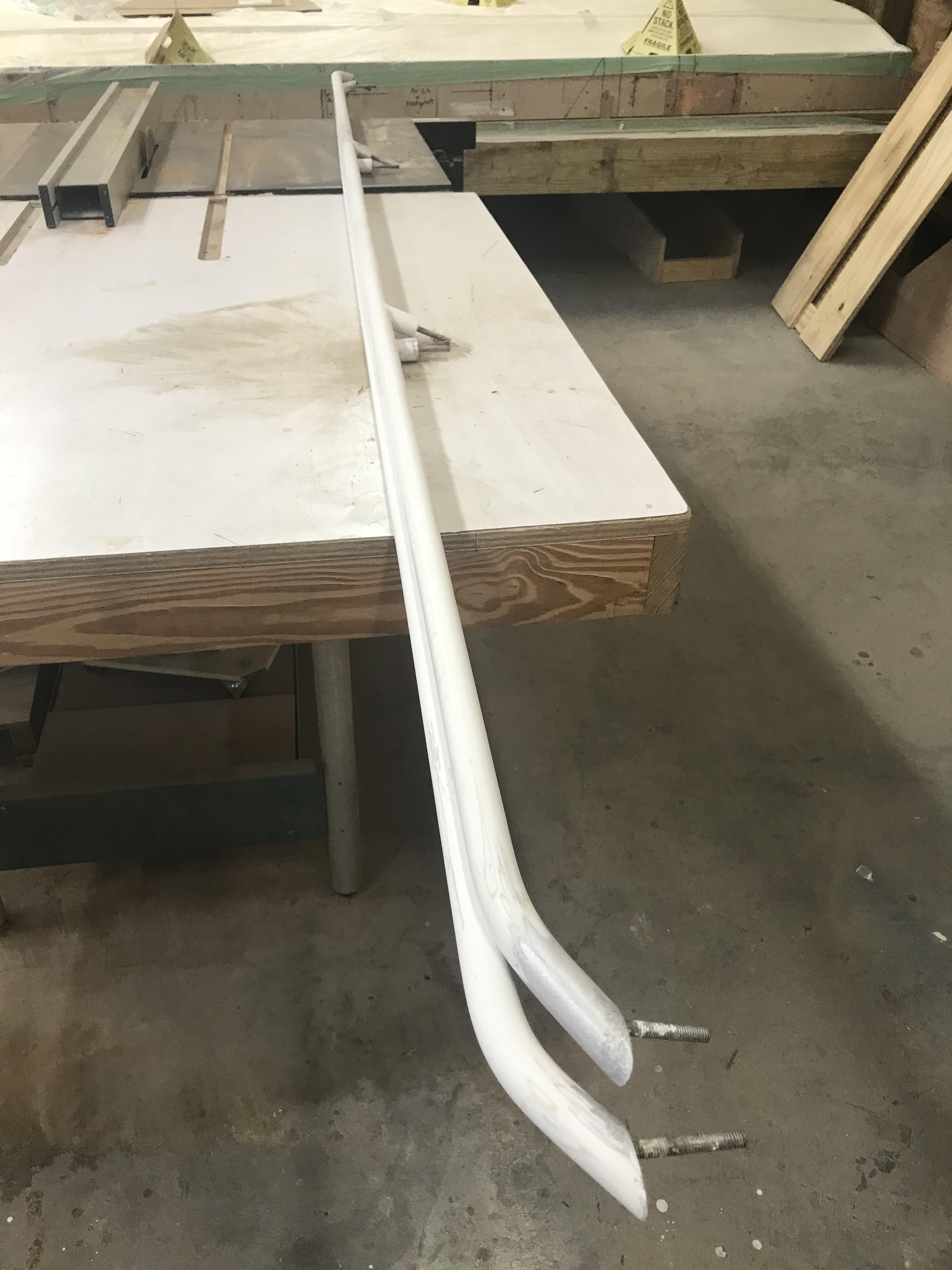

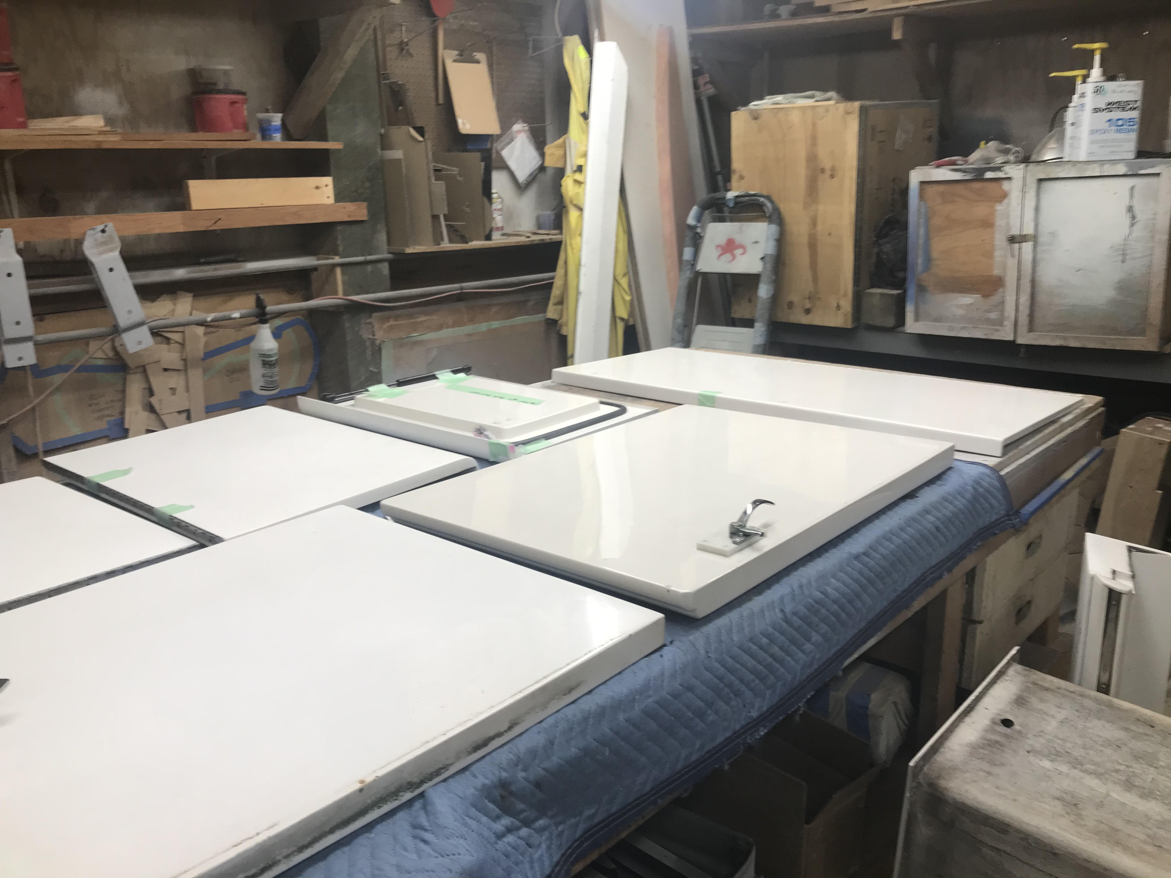

    unnamed-3.jpg A little more progress. Down to the details.

    Went down last week, for the first time, to check in on the boat. Up until now, I've just been receiving a few photos from the yard as the job progressed. It was quite a disarming site. The boat is in about a thousand pieces!
    I must hand it to these guys, they have the boat stripped down to the last bracket, handle, hinge, frame, fixture and panel. Sorry I was so overwhelmed that I forgot to take any photos.
    The lead technician gave us a tour of the project that was spread over one boat house and five other structures. As the boat is being disassembled and prepped in the main building, all of the parts are stripped, sanded and prepped in another area, painted in another, and ultimately stored in a shipping container to await reassembly. The hardtop is in another building still awaiting disassembly.

    They are finished with all the trim pieces, doors, handles, etc. and have started grinding and puttying on the hull and superstructure. Have started picking out new fixtures, lights, riggers, etc.

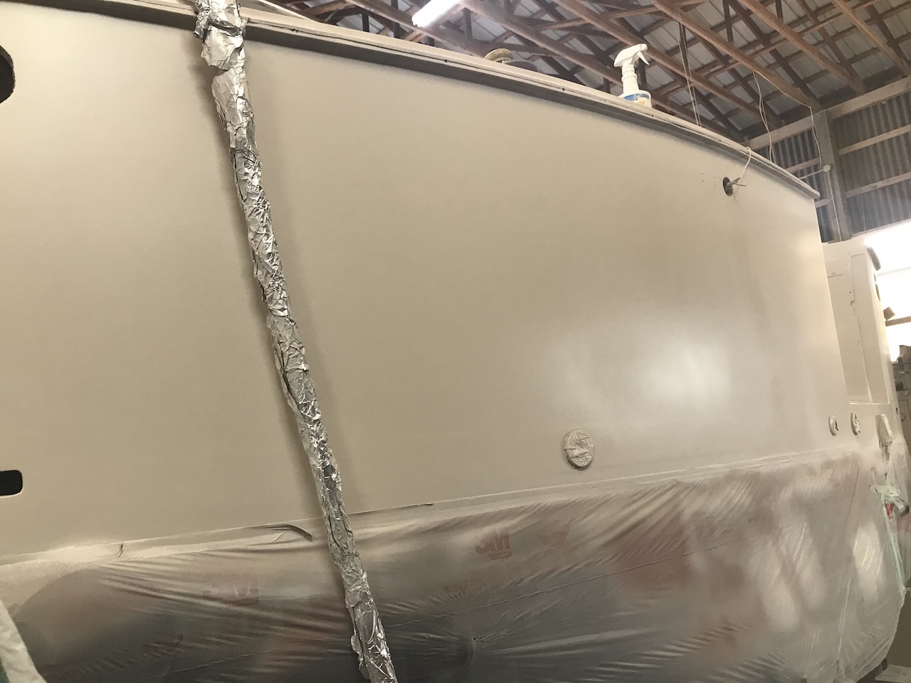

    Hull has been primed.
    On order: Maxwell RC10 Windlass, Aquasignal Series 34 Nav lights, and Buell Air horns.
