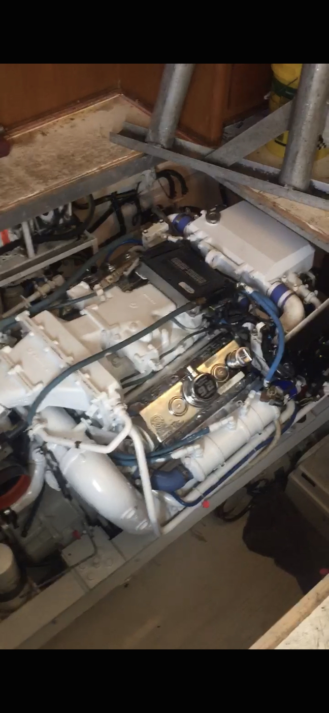

    It has been a slow winter. Didn't get much done. While on a trip to FL I managed to get the fighting chair traded out for a rocket launcher. I also got the couch base hinged to act as extra tackle storage where the sofa bed used to be, so it is ready to be reinstalled.
    Motor is almost finished. Hopefully a fuel pump issue will be worked out tomorrow, so we can seatrial again and head up the bay for paint.

    Finally got underway with two newly rebuilt engines and a freshly cleaned bottom. Boat really ran well, although I will not test top end until the motors have had a chance to break in a bit. Now we have about 5hrs SMOH Starboard, 4hrs SMOH Port! Went straight to the next boatyard where she is now being prepped for paint, and various small projects.
    I'm still deliberating on the flooring. After having had the floor out all winter, I'm sold on keeping the floor easily removable. Since deep drop fishing is our new passion, whether I go teak/holly or carpet, it must have another carpet dropped in to protect the flooring. Bottom fishing is messy business.

    When breaking them in you need to vary the rpm and not run at any one rpm too long a period, do not see any issue in bringing a newly rebuilt engine up to load/wot for short periods during break-in, would prefer it myself for proper “break in”.

    I've been varying the cruise RPM from 1600 to 2100 for the few hours I have on the engine so far. Unfortunately, it will be a couple months before the paint job is completed and the break-in can continue.

    Talk to some DD guys, I think you want to see wot for 15 seconds one or two times to properly set the rings.
  9. Capt Ralph
    14,547
    Those are the rare & famous DDEC 6V92TIABs, making over 100 HP per lung.
    IMO, go to loaded WOT once to prove correct propeller tuning and never go there again.

  11. Capt Ralph
    14,547
    This is the DDEC 6V92TIAB.

    Break in procedures?
    No.
    Desire to keep a high strung block together?
    Yes.
    Thru out this models life, one serial number was all needed. No changes for the whole model run.
    It is the tidder todder of DDEC, 92s and high power out put.
    This engine will offer great economy and long life to 450 HP. Past that think rebuilds soon.
    Even though DDC does not offer a comparable engine life/cycle profile, just think ; keep High Performance duty cycle down. Cruise at 1950 to <2000. Even if you luv screaming past that, please recall my works, keep HP duty cycle down.
    The more you stay off of 500HP or more, the longer your engine will last.
    So, This is why I suggest a different break-in schedule plan than PacBlue. Be in no hurry to rob life from your engines.
