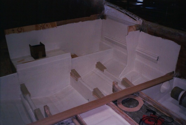

    I will ask my dad and also call our former plant manager Stan for you. Between those two I will try and get a definitive answer. I attached a picture of hull number 1, the box you see centerline should be on top of the water tank. Don't quote me on this as I was a youngster and don't remember the exact position but I believe that was where the water tank was.

    Thank you for the pic. The forward fuel tank is accessed by the teak and holly cabin access plate square in the middle of the salon. If the water tank is forward of the engine room, then it should be aft of the forward fuel tank. The salon hatch aft of the fuel tank access is for engine room access. I will check again for an access hatch in there.
    If the box in the picture is marking the top of the tank, it would seem much smaller than 100+ gallon capacity, but sometimes that is hard to judge.

    The box shown in the picture is what the batteries are mounted underneath of, or inside of rather.

    I do have a photograth showing the two battery boxes between the main engines just inboard of the forward engine mounts which would go along with the above photo graphgraph showing hull # 1 being built.

    I think the box you are thinking of C. J. are on the later model 40 & above boats where you have 5 or sometimes six group 27 batteries in a vented box forward on the centerline with a bilge pump below them behind another access hatch.
