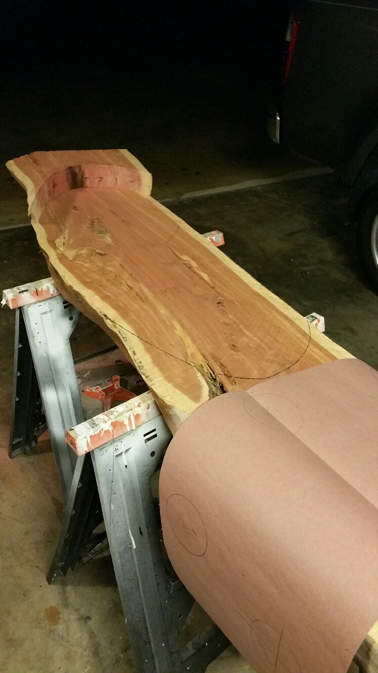

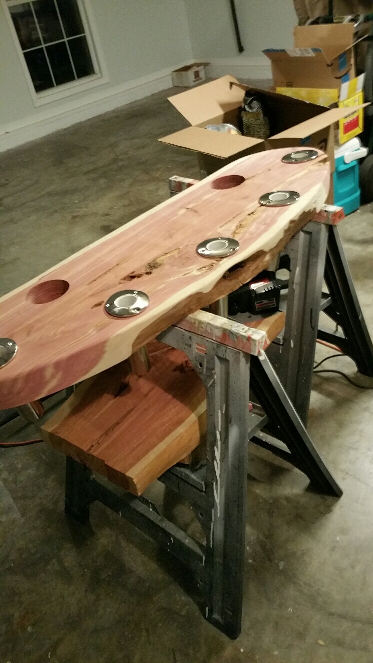

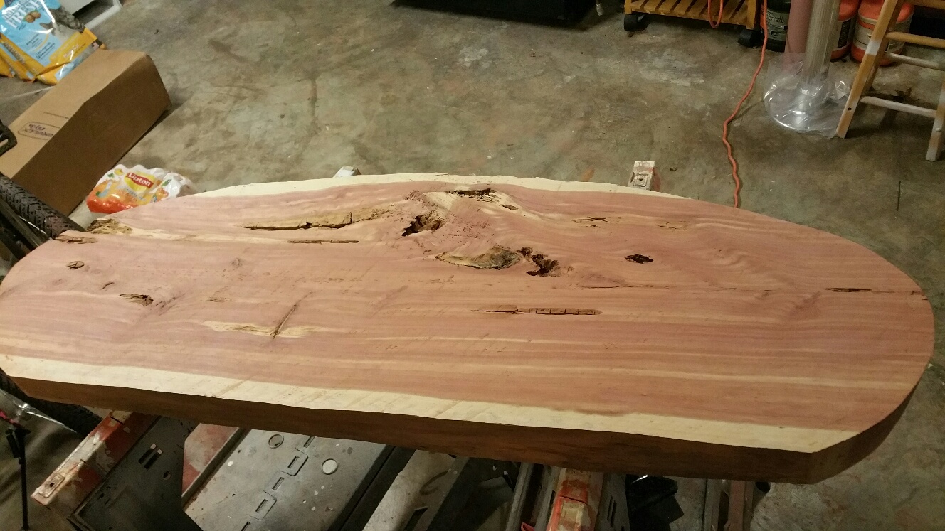

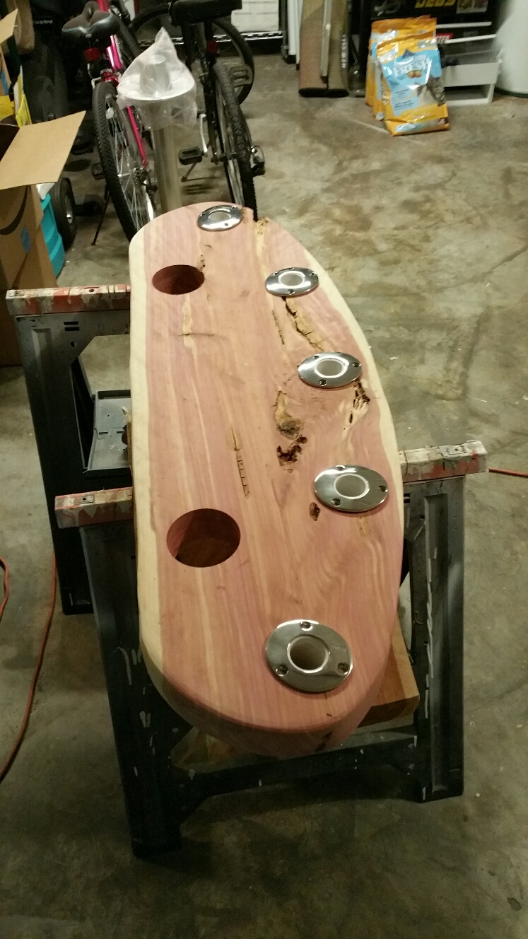

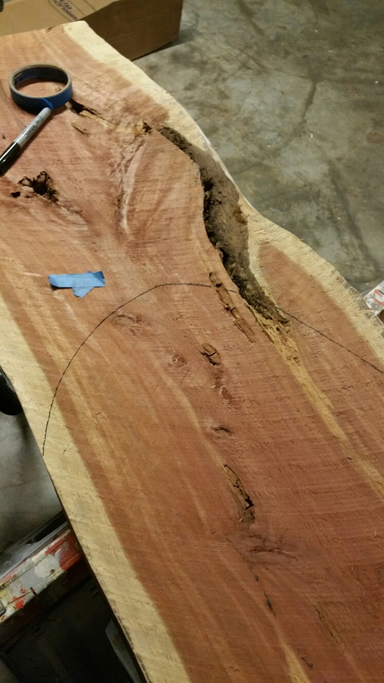

    I decided to try my hand at making a pedestal rocket launcher. I hope to have it complete next week.

    That looks great. What wood?
  5. ReelPlumber
    ReelPlumber Member
    Jun 14, 2015
    56
    Fort Pierce
    Thanks! Cedar

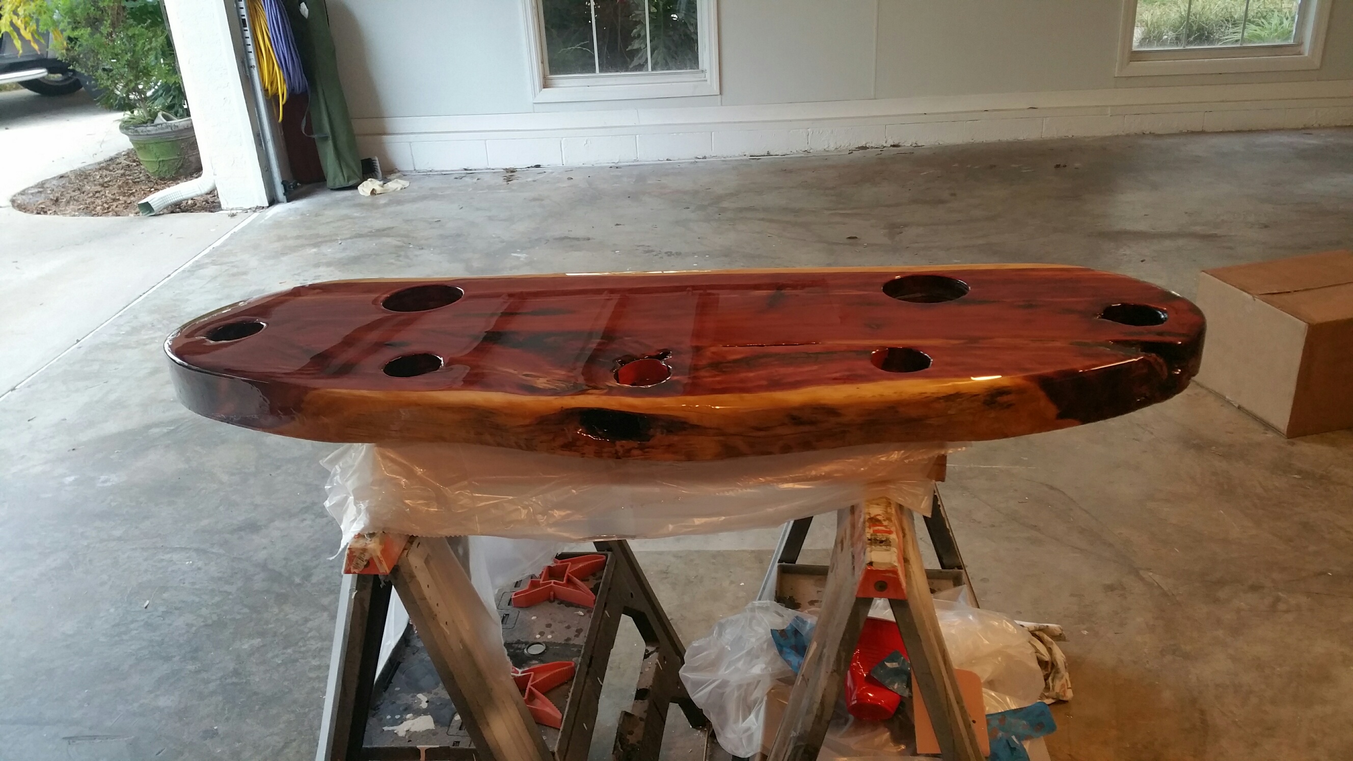

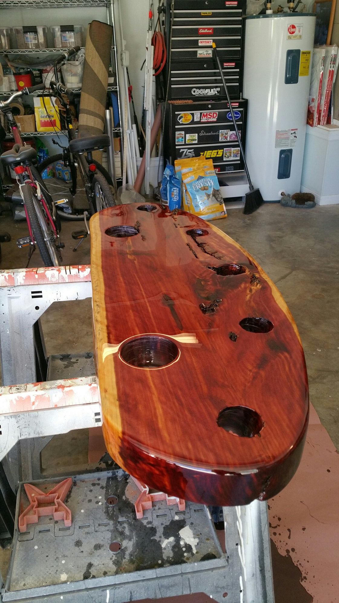

    I got the seal coat and the first flood coat on today. I am really liking how this is coming out.

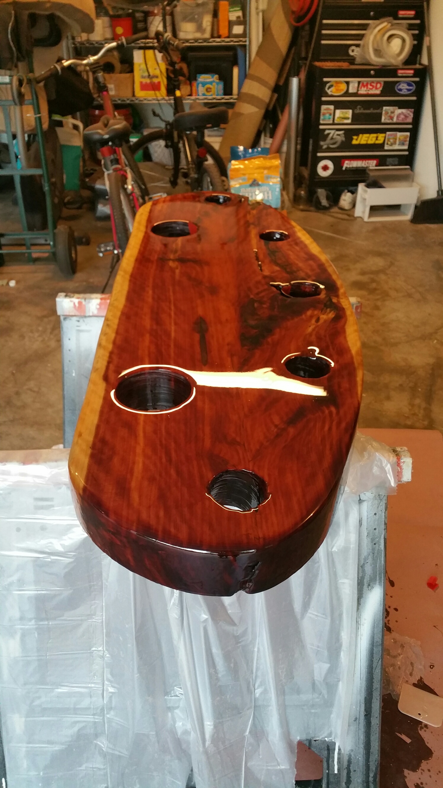

    Last two coats are on. Next comes the pedestal, rod and cup holders. 20170301_070856_1488376226888_resized.jpg 20170301_070913_1488376224283_resized.jpg

    Very nice! Maybe I'll see you in the islands sometime!

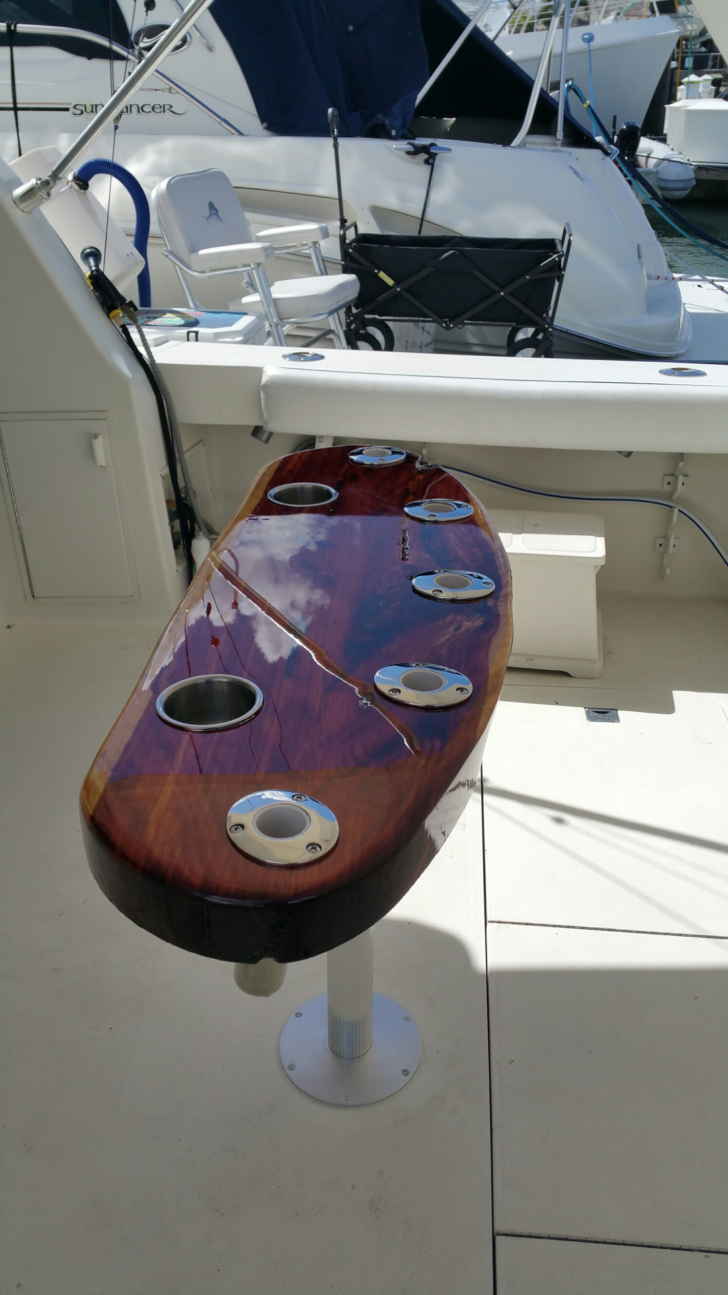

    I got it installed this weekend.

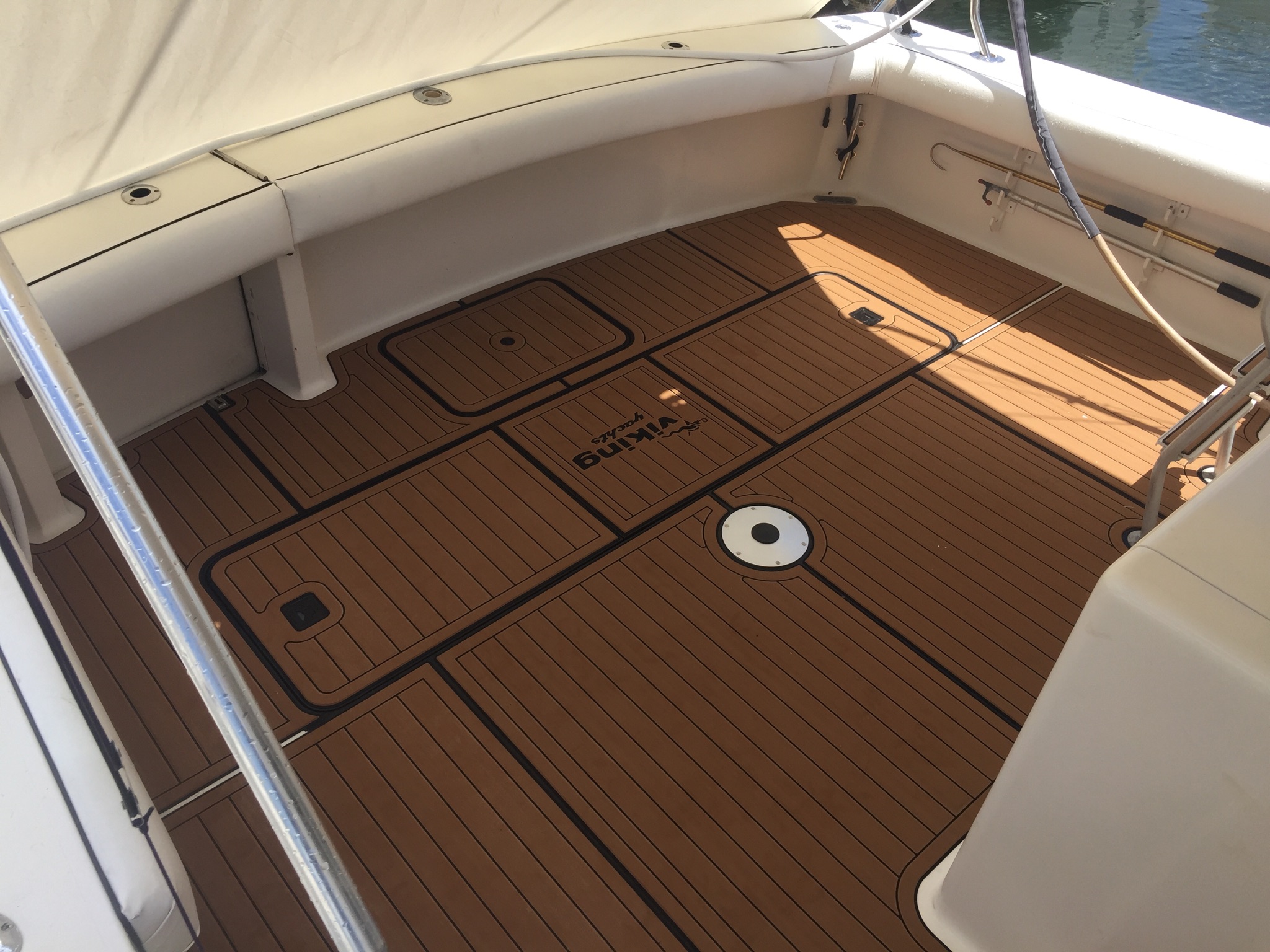

    I been wanting to have Seadek installed on the decks but I didn't like having the white show between the panels. I cleaned the areas where the panel lines and hatches would show and painted them flat black. After they installed the panels it looked awesome. Only problem was I missed 2 small sections but that will be easily fixed with an artist brush.

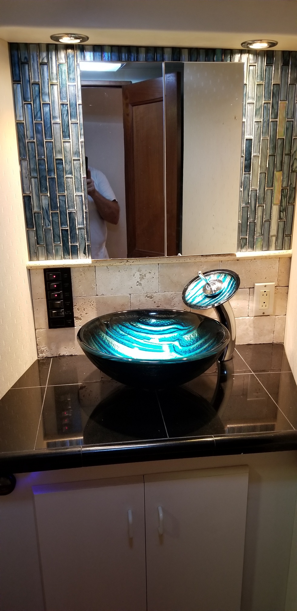

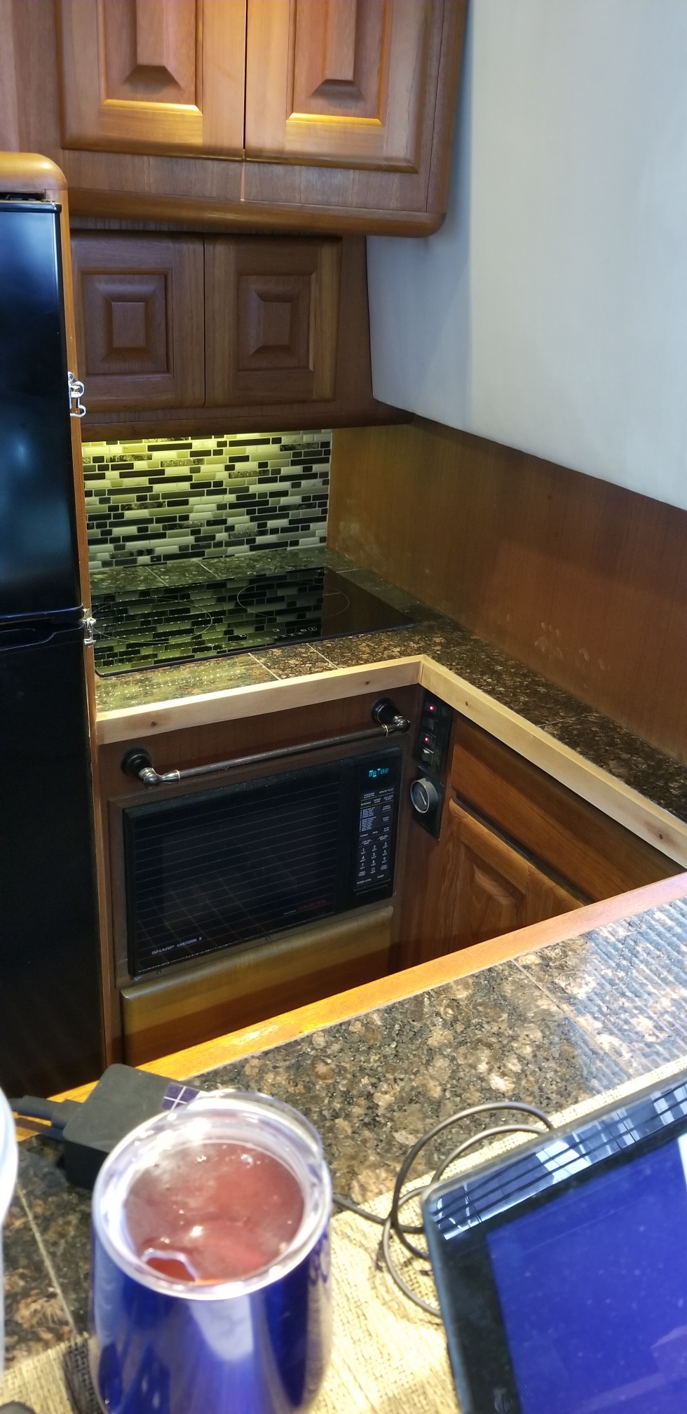

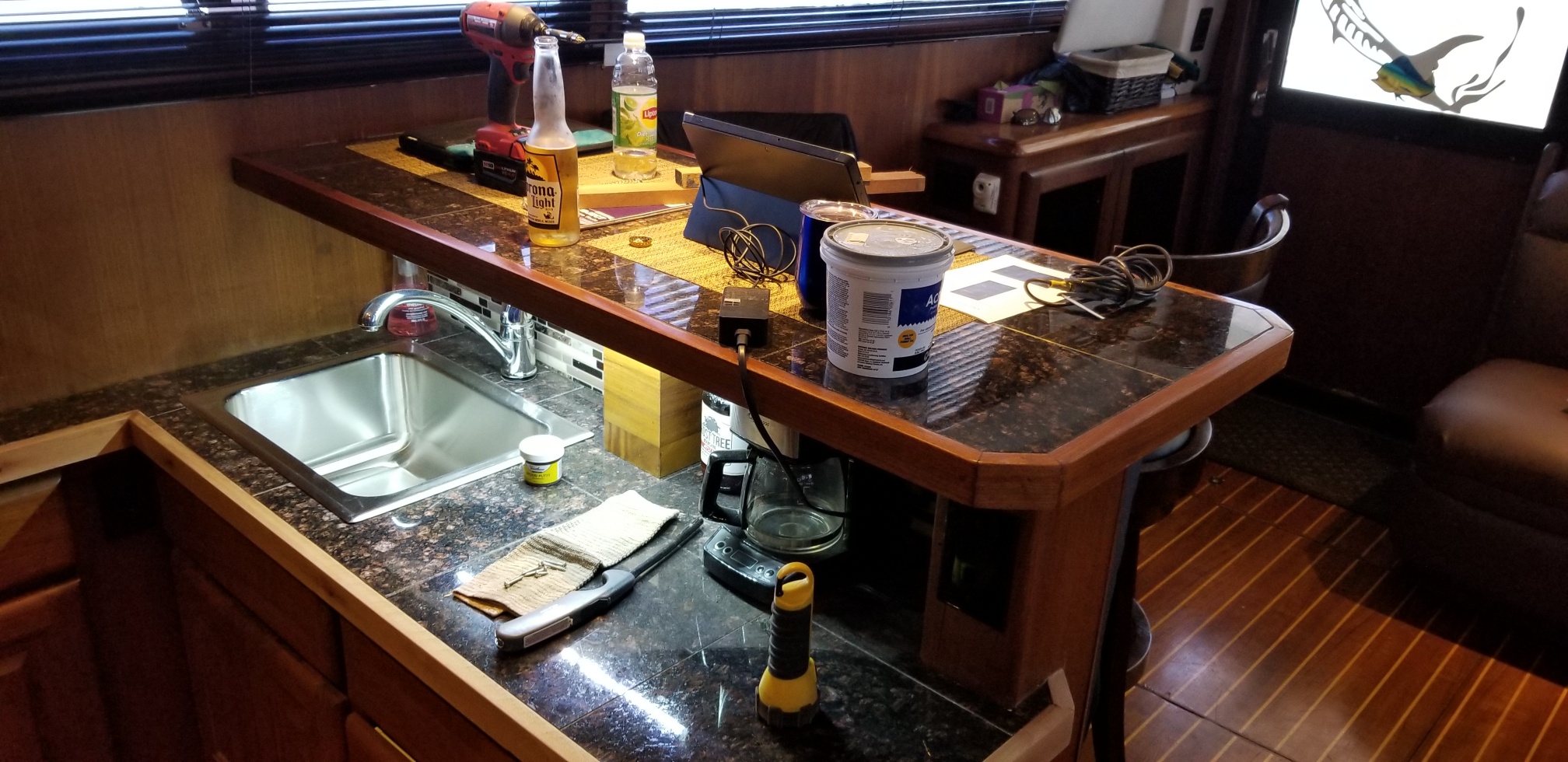

    This past week I've been updating the head and galley. I made some granite tile counter tops and installed new sinks and tile walls. I just need to grout and varnish the trim.

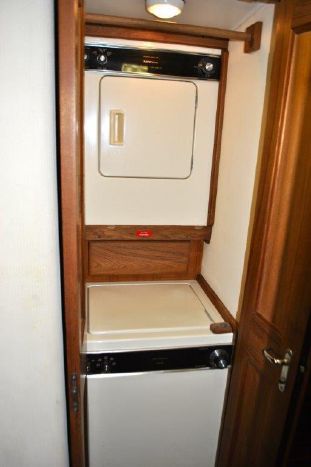

    20170401_140446_1491700759760_resized.jpg 20170408_181135_1491700756575_resized.jpg 20170415_105711_1492313993979_resized.jpg WD.jpg 20170401_140446_1491700759760_resized.jpg 20170408_181135_1491700756575_resized.jpg 20170415_105711_1492313993979_resized.jpg WD.jpg

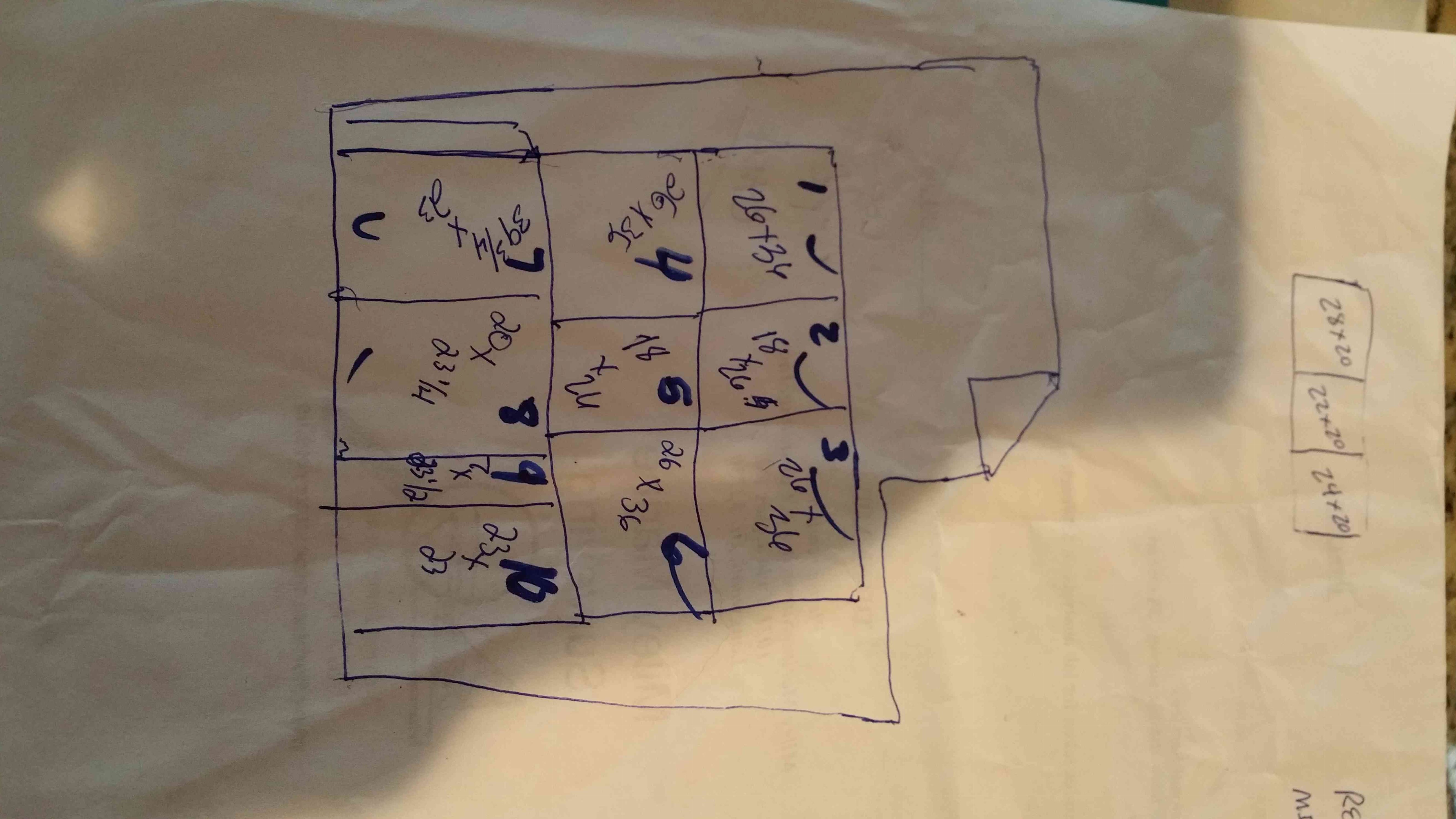

    floorplan.jpg here is the floor hatch/panel access layout and sizes.

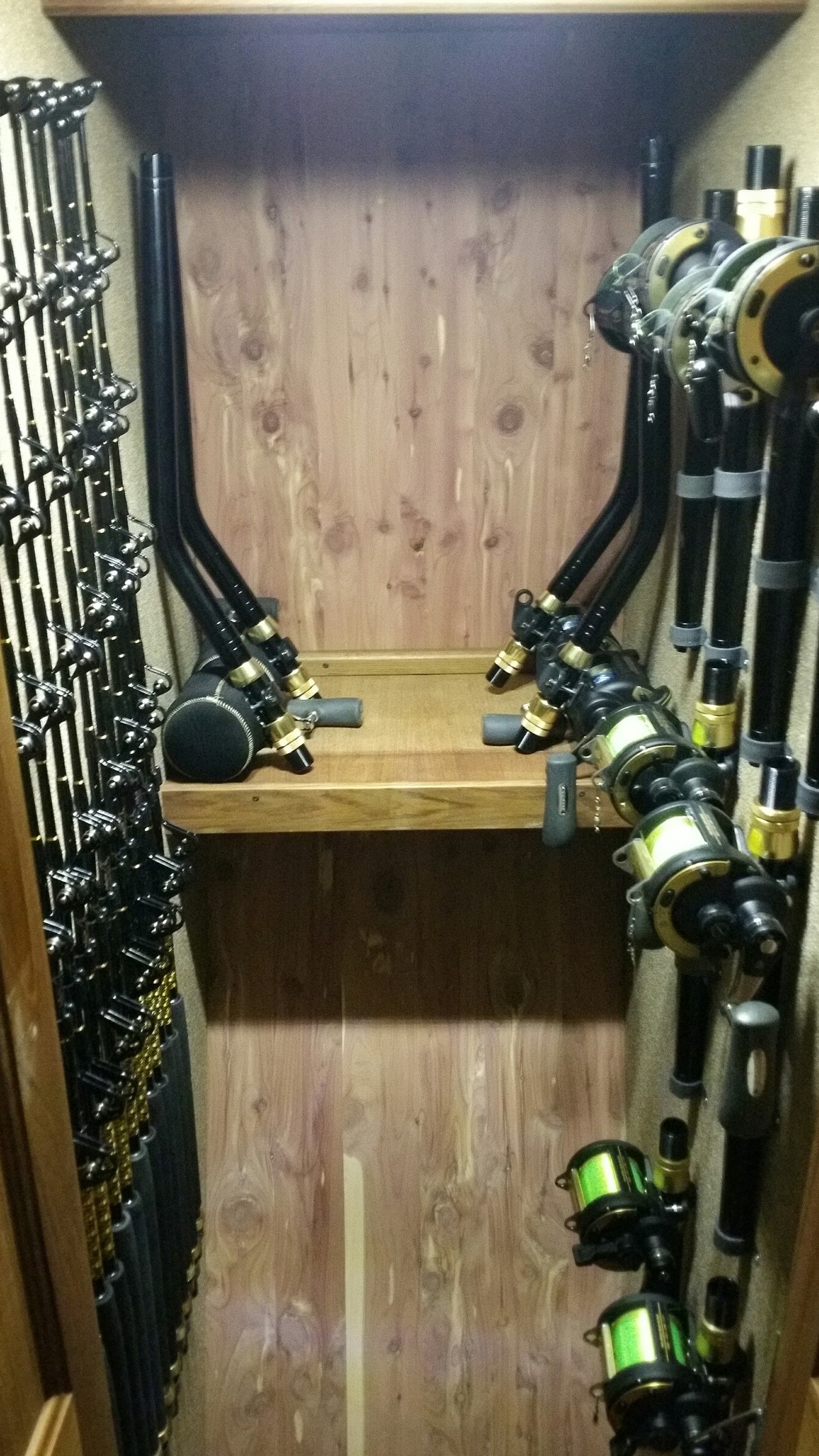

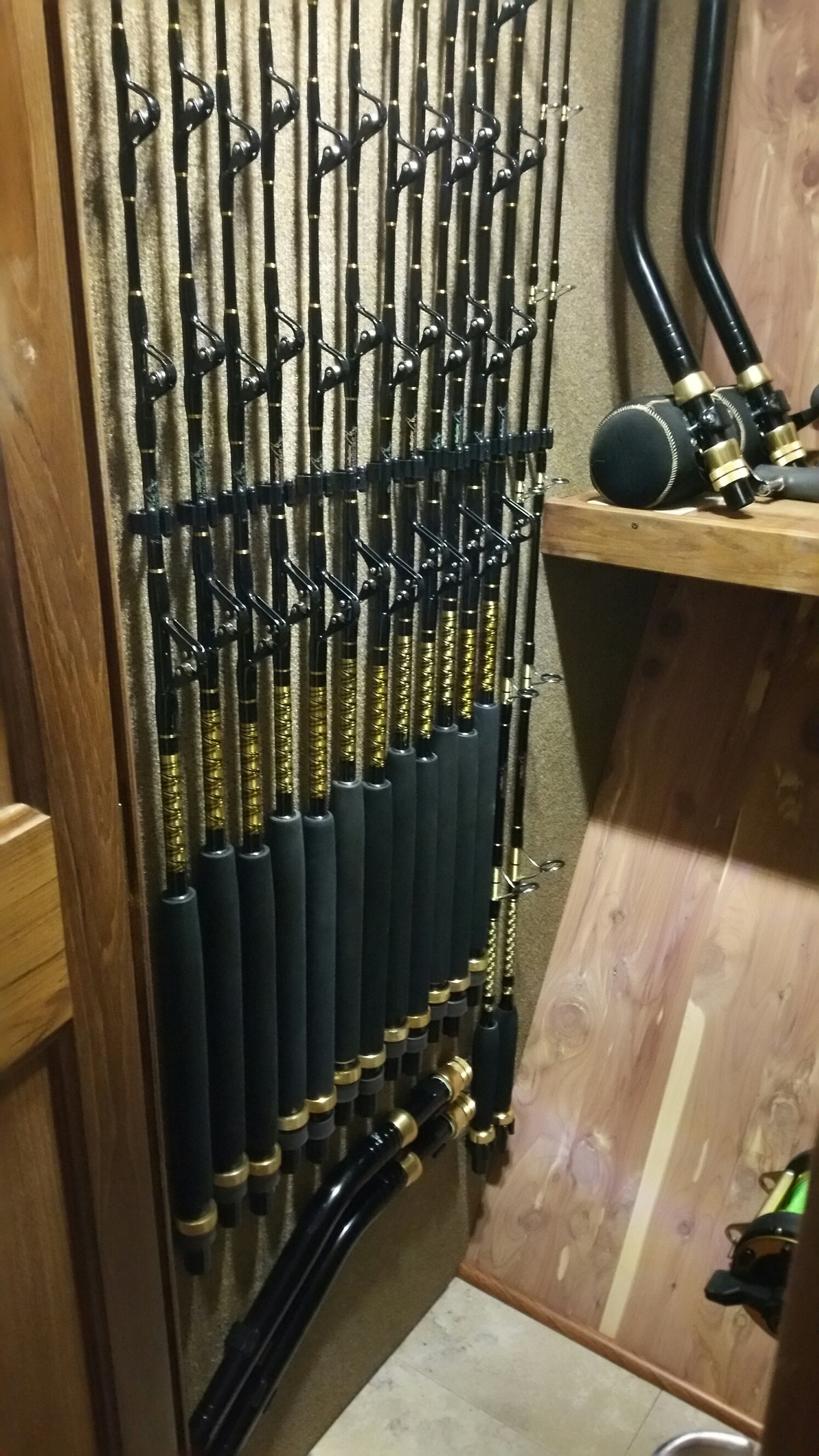

    Love the rod storage. That is really nicely done. Unfortunately, I was hoping to leave the rigs assembled. Was there not enough height, or do you just prefer to secure your rods once they are disassembled?
    My dear wife suggested that we convert that space and put a bait freezer on the bottom and a Splendide combo washer dryer on the top. However, that still leaves the rods to deal with.
    Thanks for the hatch panel layout.

    petrel there is not enough height for most rods and it only takes a few minutes to put them together.

    If my memory serves me correctly I had a price of 3100.00 to resurrect mine. I know there are some kits out there that seem fairly simple to install. If your compressor unit is in the engine room have the lines tested from there to the freezer box. if they are good and no leaks it may be a simple as a line vacuum and replacement unit installed.
    I chose to break my rods down as I have seen in many boats where the ceiling has marks all over them from people scraping the rod tips against them. Looks nasty.

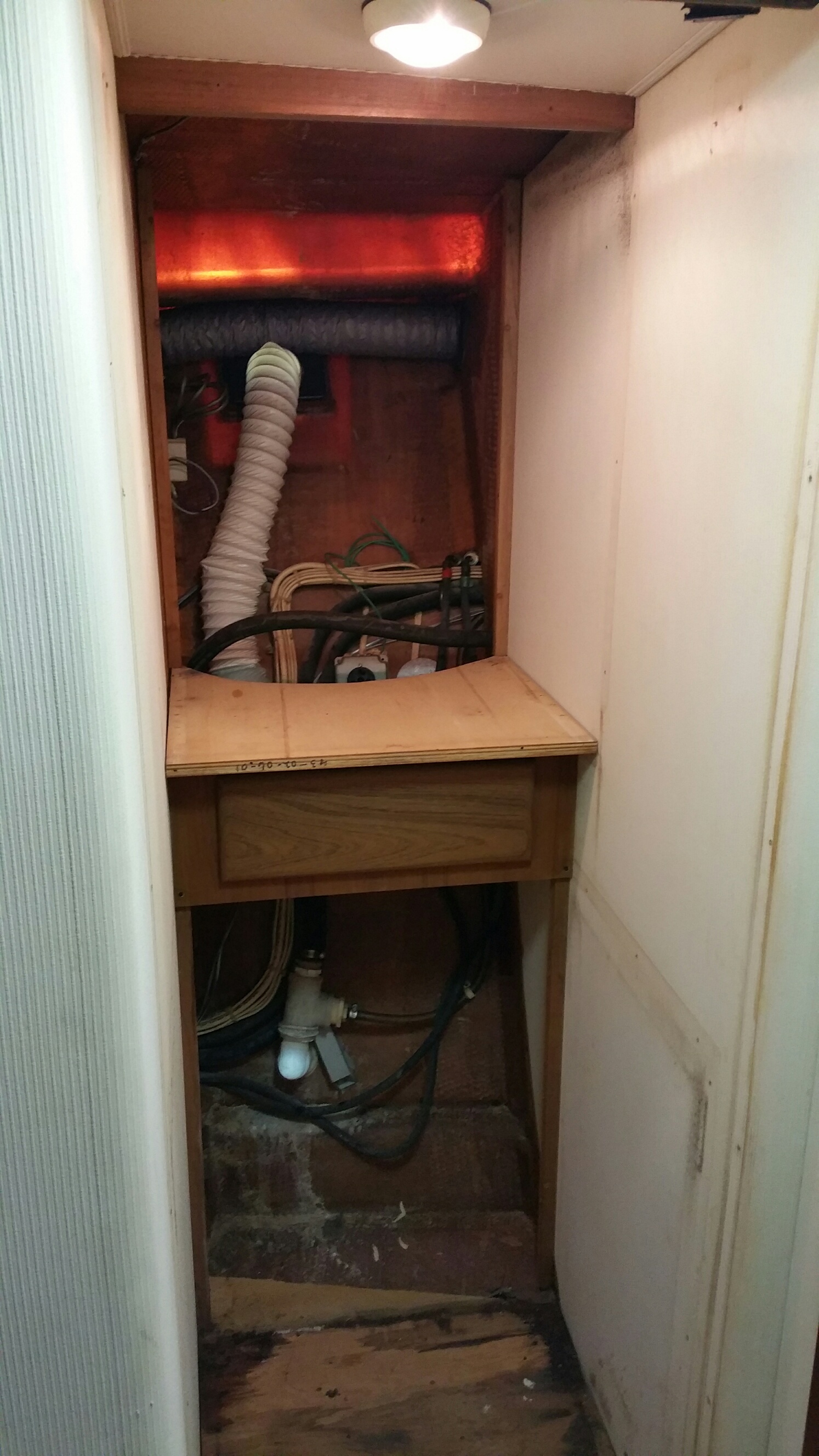

    I was keeping them in one piece at first and storing them in the salon sofa. It got to be a PITA digging them out:mad: so that's when I decided to take out the washer and dryer.
    Your wife's idea is great on the W/D combo unit and that may leave you enough room for an ice machine. Between fish and drinks ice is important!:D
