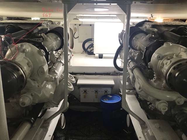

  6. motoryachtlover
    motoryachtlover Senior Member
    Jan 29, 2007
    725
    smithfield, VA
    I had egt and boost gauges put on my mans and am under egt is under 600 at a 2050-2100 rpm cruise. With everything clean max wot is 2400. But I have a concern that the location of my temp probe not in the right place to correctly measure egt. Would appreciate any comments on the location of my probes. Picture attached. Thank you. 47CFC4E1-F905-49B1-AC29-627E0661355F.jpeg

  12. mapism
    mapism Senior Member
    Aug 9, 2008
    2,241
    Sardinia
    Your location is correct, and is in fact the same where I am considering to retrofit EGT thermocouples on my engines.
    The alternative would be to place them upstream of the turbos, but there's nowhere to fit them, on those engines.
    And also the mandatory initial tests prescribed by MAN upon commissioning of new boats were done on post-turbo EGT, anywhow.
    PS: my only suggestion would be to fit a probe on both cylinder banks of each engine, for the reasons discussed in another thread.

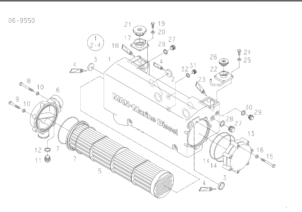

  18. mapism
    Aug 9, 2008
    2,241
    Sardinia
    It shouldn't, also because if you are talking of a check that you made recently, it can only get worse - possibly MUCH worse - when the sea water temperature will increase during the summer.
    When is it the last time the heat exchangers were cleaned?
    Regardless, it's probably time to open them, pull out the tube bundle and clean them thoroughly.
    And while you are at that, check for potential corrosion on the shell seat where the large OR under the side cover goes.
    That's critical, because that OR has a double function, sort of: avoid external leaks on one hand (which are easy to spot, if any), but also avoid internal leaks/exchanges between the raw and the cooling water (which are more critical).
  19. vic13r
    vic13r New Member
    Feb 11, 2020
    13
    Greece
    Screenshot_20200213-215314_Xodo Docs.jpg Do you mean number 7 and 14??
