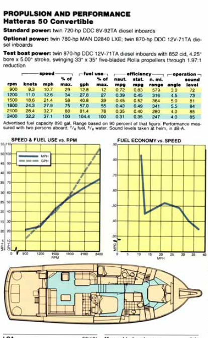

    Good morning to everybody.
    I live in Italy and I'm looking for a Hatt 50 C.
    I found one model (priced Euro 200.000,00), year 1991, with detroit 12V-71TA 2; 870hp.
    Does anyone have experience about this boat?
    Performance, fuel consumptions; any problems?
    Many thanks for your suggestions
    Luca M.

    I am not familiar with that age 50' SF Hatteras. I always seemed to run 52' etc. I would guess cruise speed would be around 23 knots with those engines. Fuel burn will be 90 GPH at cruise. It should be a good sea boat. I've run newer 50' Hatteras SF from the 2001-2004 era and they were a pretty good sea boat, but I don't think it's the same hull as 1991.

    Thank you Pac Blu it’s all clear. Engines have got 1600 Hours and the boat hasn’t got the tower... do you think I can expect a 2o-22knots cruise at 1900 rpm and 70 gph? This is what I hope...

    It all depends on the bottom and how much weight you add. I would expect given the age and everything 23-24 knots at cruise as the boat did 24 knots at 1800 new. Generally 5-6000 hours (or more) are pretty normal out of a set of 12v71 TA's in a SF if they've been taken care of. If it has 15 coats of bottom paint on the bottom that will definitely slow it down 1-2 knots. I had the bottom soda blasted back to gel coat on a 7 year old express MY and with a barrier coating and 2 coats of new bottom paint, the boat picked up 2 knots.

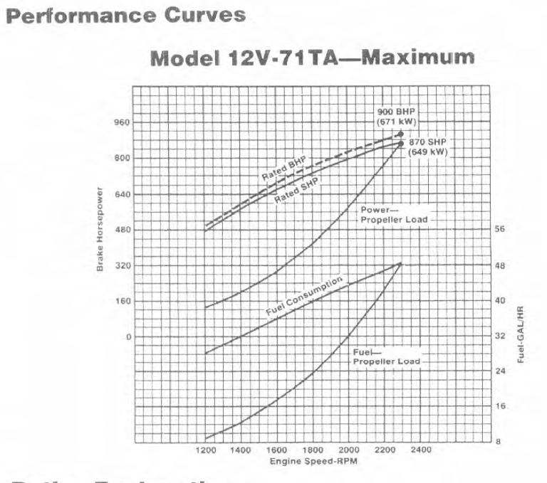

    Fill the boat up with fuel and water, empty the waste tank. Have your bottom cleaned and then check these two things: After a good warm up at the dock, check the maximum engine rpm while you are in neutral. This is the no load rpm and confirms that you have a good fuel rack position and good throttle linkage allowing a full thottle position. This no load rpm in neutral should be in the neighborhood of 2500 rpm.
    After doing this at the dock, take the boat out for a sea trial. Record what the maximum rpm is under load, you want to achieve something over 2300 rpm, preferably 2350 rpm to ensure you are propped correctly.
    I would then follow this schedule:
    1750 rpm for my light cruise, 1850 rpm for my normal cruise and 1950 rpm for my max cruise. If the engines are putting out their rated power you should be covering 21 to 25 knots in that range.

    In the states, we would typically have a Marine Surveyor for the boat and equipment and a separate engine survey done by a reputable Detroit Diesel servicing center. That means 2 different survey reports.
    The following is the Factory Performance Curves for a new engine:
    You take Fuel from the Propeller Curve to get the approximate gallons per hour consumption:
    1750 rpm > 22 gph each, 44 gph total
    1850 rpm > 26 gph each, 52 gph total
    1950 rpm > 30 gph, each, 60 gph total
    Older engines may not achieve these factory values exactly.
