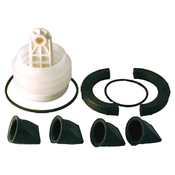

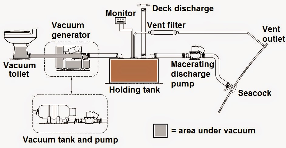

    There won't be any vacuum on that side of the system. It sounds like the diaphragm/bellow on the pump is broken or the duck bill check valves are not holding if no vacuum is being created. I am not sure what system you have but the pictures below should give you an idea of what to look for. A damaged bellow will also leak waste into the bilge creating your odor.

    Thank you, this is very good info! I was on the boat this morning, poking around, and was stumped trying to get access to the holding tank. Looking at my schematic of the boat, the holding tank is on the center line, next to the hot water heater, just behind the mid bilge pump. I can't get at it. What am I missing? There's a bulkhead forward of the generator, a bulkhead aft of the mid bilge pump, and bulkheads on both sides. Seems the holding tank is low in the boat too, likely right in the V. There has to be a way to get at it, if you ever needed to change hoses, sensors, etc. Any tips on that one? I also can't see the vaccum pump either. Of course I forgot to get a pic of the head. There's an access plate under the toilet though, that's part of it. I wonder if pulling that gets me access to the pump, and so I can check for leaks...
    For the life of me too, I still can't get the deck waste cap off. It's so flipping tight. My friend had a tool for the caps that was adjustable and about 6" long. I figured I could get some leverage. It's made of brass, and it just bent. The prongs are just popping out of the cap now. I'm thinking I may have to fabricate something using a breaker bar or something to get it out. Why it's so tight, I have no idea.

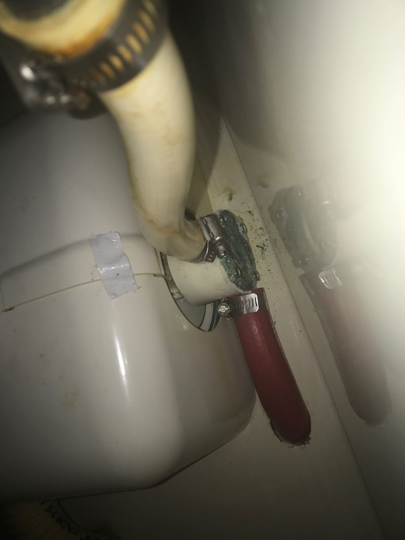

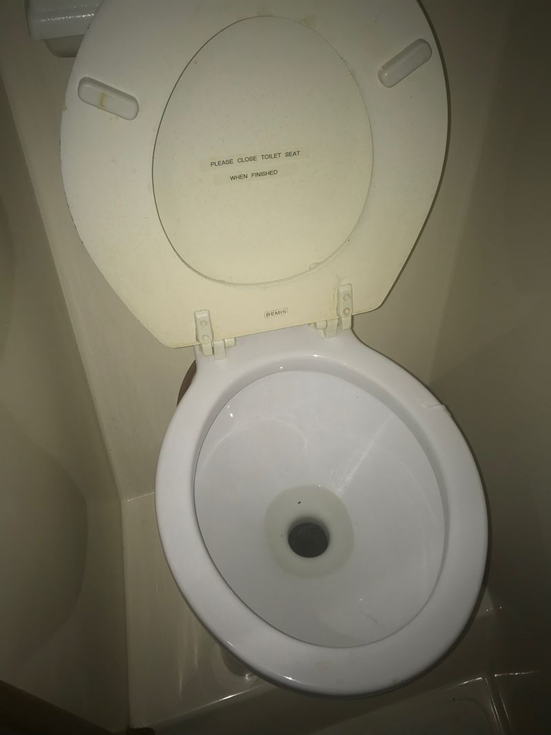

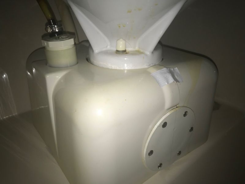

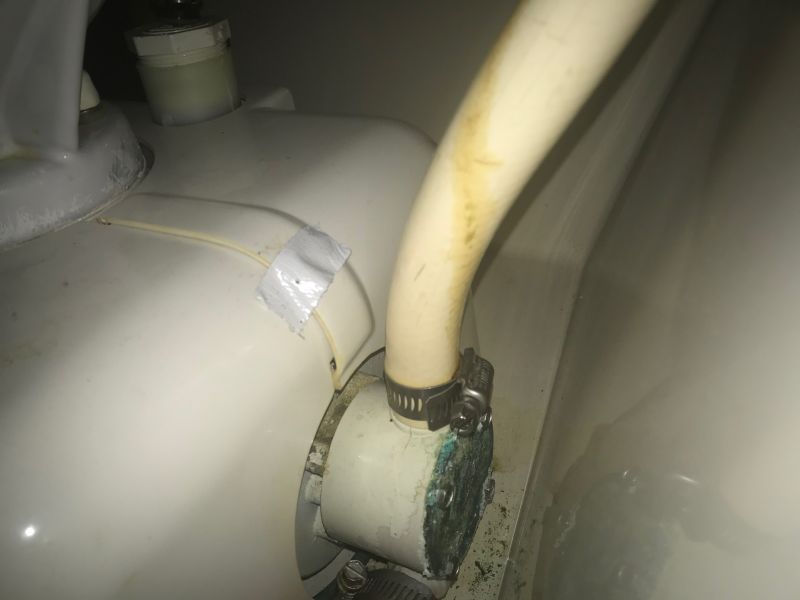

    Thanks. I had a buddy go in and take some pics of the head, hoping they would help. I'm a bit disgusted of the close ups, as the thing looks filthy. That's not from us! :) I will be cleaning that very well when I get back there in the next day or two.
    Anyway, here's some pics of the head unit. The pic with the red hose is the back of it, and that red hose goes to the salt water pickup/seakcock.
    Do these help with determining what I need to dig into to? If I recall correctly from the paperwork (it's in the boat), it's a Raritan head.

    In looking at this unit I do not think you have a vacuum system. It appears that your system grinds up the solids and pumps them to a holding tank. I cannot tell if there is a second pump for overboard discharge or if there is an actual pump out tube from the deck. Do you know if the pump is actually kicking on when flushed? There may be a safety switch the wont allow the pump to come on if the tank is full. Here is some info I found online.

    Thank you. There is a pump in the head and a separate macerator pump for overboard discharge from the holding tank. You can also pump directly overboard with just the head pump. I think it’s called the classic or something. And I believe you are correct. Not a vac system. Just pumps and sucks it down. Which isn’t happening. I looked at he raritan website to identify it and then found some YouTube videos. Just not 100% sure what the issue is. Still can’t figure out how to get access to the holding tank though. I’ll have to check the vanity access

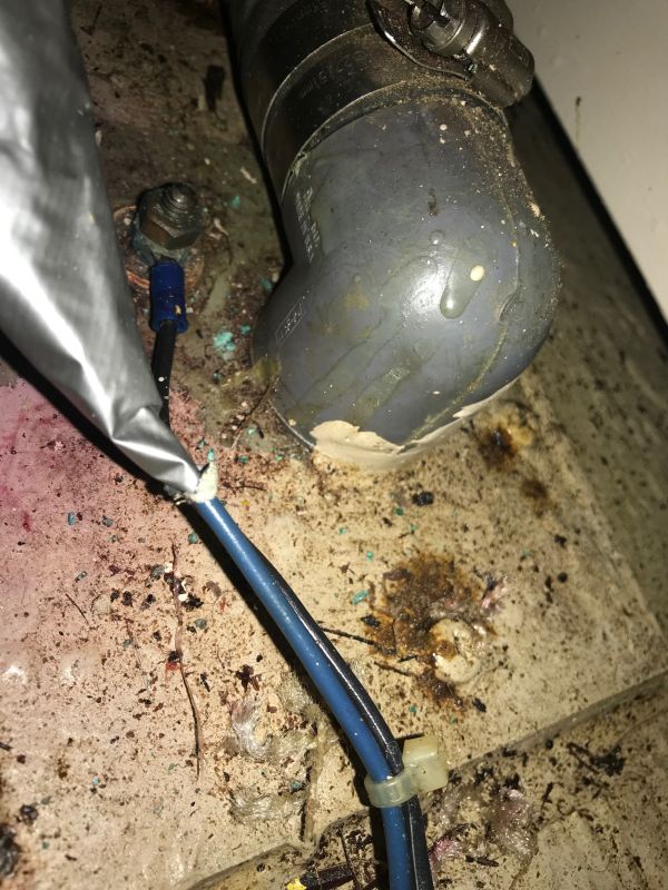

    I made some really good progress this weekend, finally. First I located the top of the holding tank and the related hoses. No signs of anything bulging or leaking. There is a wire on top that is taped off, not sure what that is.
    But this let me trace my vent line to the port side forward of midship. I thought for sure it was one of the vents on the starboard side. But nope! I don't know how I missed this before. Anyway, yes the vent was clogged, and my goodness when I unclogged it at the vent, it sprayed liquid and sounded like a soda can being opened. And the foul smell, ugh it was just terrible.
    This has solved the head not flushing problem. No vent was created too much pressure to suck it down. I also checked all around the head and took all the covers off. No signs of anything leaking there. So I'm in better shape.
