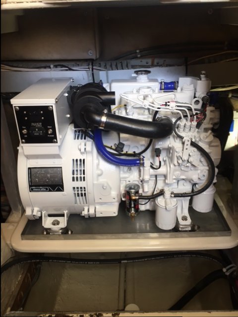

    You will be happy with the Phasor. I put the 8kw with sound enclosure in my boat back in July. I used it to the Bahamas and back and it worked great. I did add gauges to the helm so I can watch the temp and oil pressure. It very quiet and starts so easy.

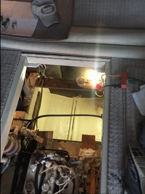

    Awesome! More positive feedback. Love it! A pic of the old Gen slid back between the mains , the gen plywood plate removed and a fresh coat of Moondust AwlGrip in the bilge beneath!

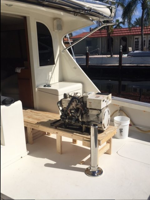

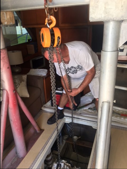

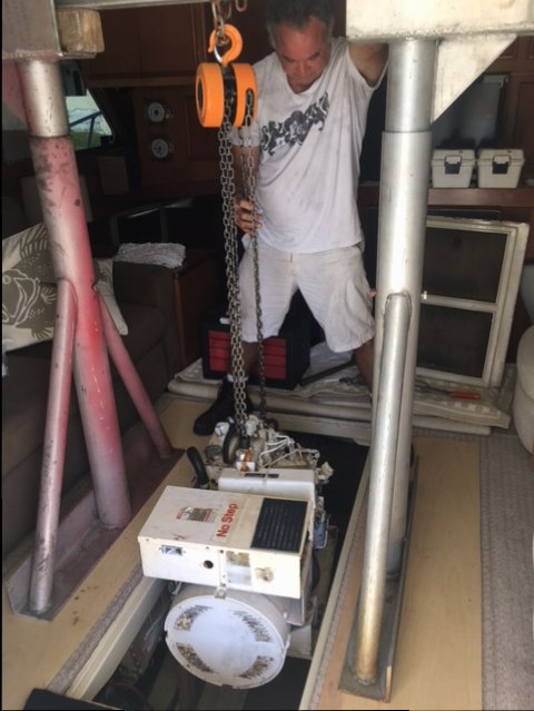

    This is what the last few days looked like. Built a platform at salon deck level
    A-Frame setup and ready to pick
    Coming out of the hole...
    Out in the cockpit Ready to pick and replace with a shiny new one....Just rolled it on a few 3/4" wood dowels on the plywood to get it from the salon out to the cockpit. Worked like a charm! headed over to the boatyard for a 45 minute pit stop
    New Generator and drip pan bolted in place awaiting this weekends electrical and plumbing connections. Also doing some painting and LED lighting in the ER. Amazing what a shiny new piece of gear will do to inspire you!
    I hope to be making power early next week with turkey time factored in. I had a helper for about 5 hours thus far. I probably have about 20 man hours into the project at this point +/-

    Sorry Bob! And Thanks Rcrapps! The new gen is all hooked up and making power. It is quieter than my old unit too. Just finishing some touch up paint and other picky work in the engine room but the Miss Pearl is ready for her next adventure. The Wahoo population off the coast of Bimini is getting nervous!! I enjoyed the project and would be happy to answer any questions that the forum might have. Happy Holidays!
