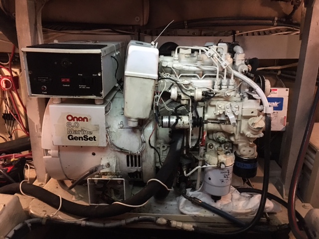

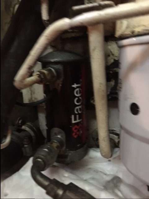

    I am seriously considering replacing my original Onan 8KW MDKD gen set. It has just over 4000 hours on it and works properly. Doesn't burn or leak any oil to speak of. I have just replaced the circuit board with a flight systems board for the 2nd time in 6 years. We love to spend time on the hook and I worry about another board failure while sitting in a remote Bahamian anchorage. Replacement Recommendations would be appreciated. I am looking at an 8.5 Phasor.... same kobota engine as the Onan with a less complicated control system. If I pull the trigger I would sell the Onan if anyone is interested. Pics attached. Gen is still in the boat here in Pompano Beach Florida. IMG_5130.JPG IMG_5137.JPG

    If it runs fine then just keep a spare board on the boat
    I will take Northern Lights any day over anything, with Westerbeke second.

    The Kubota D650/D750 are some of the toughest lil blocks out there. I was given the engine from a Onan 9 and bolted a bell and Stamford (NextGen) end to it.
    Life has been great for 3000 hours (4K hours on the motor). Shop for a SAE4 bell and 9+ Stamford end.
    Not a drop of oil used, Onan parts on the engine and makes power for weeks on end. Runs 3 ACs and chargers.
    Also use Shell synthetic 10w40 blend.
    We have an Isuzu based 30kw when everything has to run; 8 ACs, water makers, water heater and galley. 25% use.

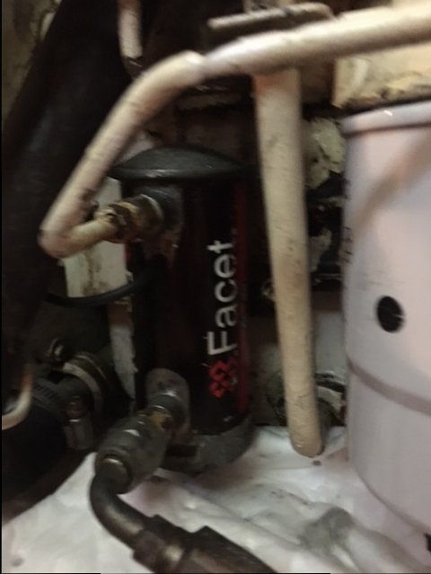

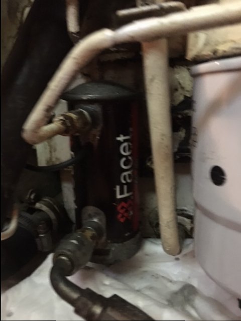

    In the pic, I notice the e-bay special fuel lift pump. If you ever think your not running well, here is your problem. I and my customers have been thru this.
    A real pump is required.
    I order the pump for the Ohno 20 (MDKB?). Same hookup but really delivers the fuel.
    Sadly, it cost a few more pennies but worth it.

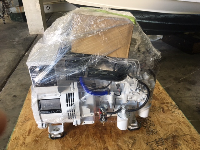

    No sound box. It was a $1500.00 option and I figured I would rather spend that on fuel! I did get a stainless pan for the new generator to sit on. I picked it up today and will be removing the old one and installing the new one over the next week to 10 days. So nice to have a brand new generator sitting on the warehouse floor waiting settle into it's new home!! I will upload a bunch of pics once the project is complete. gen~1.jpg

    I had an 8 kw phasor in the 38 ocean which had the same Kubota engine. Without a hush box. The unit was very quiet, eapecially compared to the westerbeke unit we had before. In fact The phasor on the old 38 ocean with no box is less noisy than the westerbeke with the soft hush box. I put 5000 hrs on that phasor in about 8 years with no issues besides changing the raw water pump at about 4500 hrs.

    I think it's the same (dam close) engine your pulling out. The xx05 family (905. 1005, 1105) from Kubota are tough and quiet. Lil oil and they last forever.

    Thanks Trinimax... makes me feel like I made a good choice. A couple bites on the old set but nothing solid yet. The 1st $1500.00 takes it. It will be out of the boat on Monday in Pompano Beach.

    Yes....Doing the work myself. I will post some pics and details of the process when complete. So far I disconnected all plumbing and electrical connections and moved the generator between the two main engines this past Sunday. I built a new plywood plate for it to sit on as the old one was delaminating....painted the new wood plate and the bilge area below the gen after a good deep cleaning. About 6 hours of labor thus far and it was just me. I will pick it out of the engine room and move it to the cockpit this weekend. The boatyard is a couple canals away. I will head over there on Monday so they can pick the old one out and place the new one in the cockpit. More updates to come!
