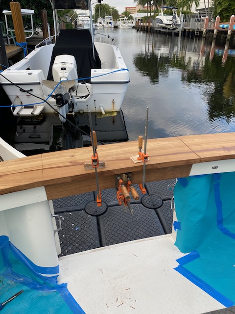

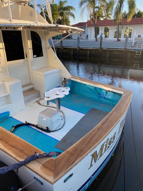

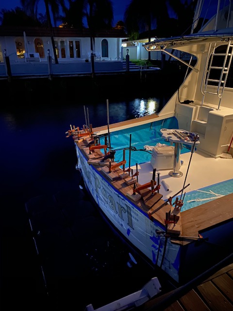

    After gluing up the Starboard side similarly to the Port... The transom board was dry fitted. We built a new hatch cover for the transom door out of teak. the old one was badly water damaged and deformed. That new piece was wedged into place and temporarily secured. We used wax Fillets to fill the seams (Hinge side and inboard side) in this new door hatch where we didn't want the epoxy to stick when gluing up the covering board. The hinge was also preliminarily laid out and a new stainless backing plate for the hinge was fiberglassed into place. There is a pretty good crown across the transom so lots of clamps were needed. We left a big notch at the quarter on both the Side boards and the transom board that enabled us to pull the seam tight in that area. Again... lots of ooze to chase for about an hour after clamping down tight. It was dark by the time I stopped cleaning up Oozing glue!
    After removing the clamps, the covering board at the transom door hatch was cut with a hand saw. A new coaming board was cut and fitted to match the existing (painted) coaming boards on both sides of it. All coaming boards will be primed, faired and painted as a final step.
    All overhangs were trimmed appropriately and block sanded. Surface got a quick preliminary sand as well
    Coming up next - Hinge will be fitted and rub rail removal and installation will commence.
    Stay tuned!
