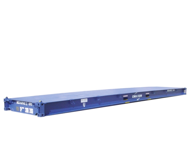

    Even some people calling the Atlantic Ocean a pond, it is not the navigational area for an 22 Meter, 27 year old, wooden planning pleasure boat. IMO, this boat will not survive this minimum 3 year long almost half way around the globe trip, if at all, without major damage and wear and tear beyond any reasonable repair. And I doubt, the officials in Scotland or Island will let you leave the harbour, when getting informed about your next destination. They do not want to spend so much money on SAR actions.
    A yacht transport with DYT from southern Italy or even Gibraltar to the PNW will be far more expensive than 100 K $. It will exceed the value of the boat several times. Only crossing the the Ocean with DYT and the rest of the trip on its own keel, will leave so much distance and running time on the boat, it will make it a complete write-off at its final destination. It is just not a passage maker or circumnavigator.
    My personal advice, as running on its own keel and yacht transport via DYT type transport do not make sense for this boat and your budget, go to the "dark side of live", the commercial freight shipping business :)
    First step, buy two of those things (40 ft flat base (rack) container), old and beaten but good enough for this purpose for less than 2 K $ each. Most bigger container harbours in the world have a dealer for used containers in their vicinity.
    Second step, have a local metal shop weld some supports on to those flat racks and turn them into a cradle. And buy some descent tie down straps and some canvas. Some carries will even provide them.
    Have your mentor teach you driving this boat around on the beautiful Amalfi coast and enjoy your time while asking for a quote for shipping of two flat racks with outsized cargo and a weight of max. 80 metric tons on top from, lets say from Neapel or Catania to Seattle via the Panama Canal.
    I know of some scheduled PANAMAX sized box carriers going from the Med via the Canary Islands and the Panama Canal to several ports of call on the west coast of the US of A up to Seattle.
    If the box carrier is equipped with loading gear and the flat racks are placed on top of the stacks, the carrier will charge you most likely only the shipping costs of two 40 ft boxes. If placed between boxes (for wind protection) most likely, maximum the shipping costs of six 40 ft boxes.
    Being slightly involved in this business :p, I assume, the complete transport of this woody to Seattle could be done for less than 20 K $ including the purchase and modification of of those two flat racks and would not take more than 5 to 6 weeks. It just requires some preparations and timing from your side, as the completed flat racks have to be available on the quay and the boat has to be on Stby in water on the other side of the ship. Timing is paramount, as a scheduled box carrier will not wait for your boat.
