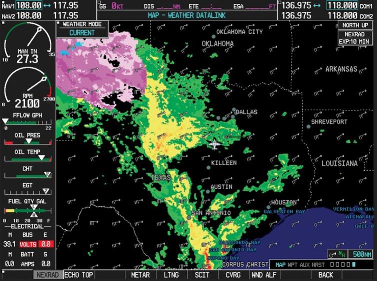

    You guys have probably seen photos of the Garmin G1000 that is available on even the smaller general aviation airplanes running 180 hp 4 cylinder engines. The system is totally integrated. Radios, engine gauges and alarms, autopilot, airspeed, satellite radar, onboard radar, traffic avoidance, terrain warnings etc. This is one of two screens large displays in a typical G1000 installation and just one of the many pages of data available. It's just far more advanced that what is currently offered on the sub multi million dollar marine market. Not sure why. Adding to the complexity of the marine market are the many different engine choices. This could have something to do with it.
