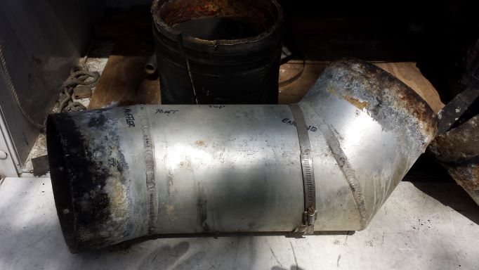

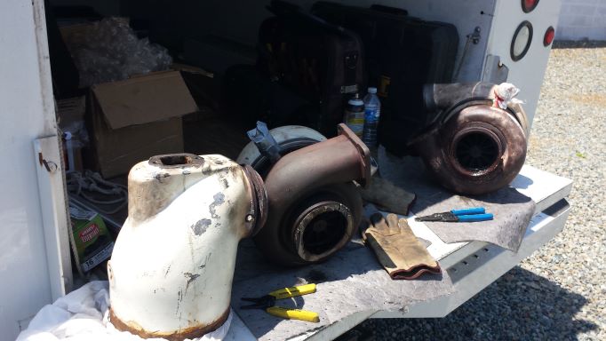

    Thanks so much for the reply , and if you get a chance please send me a photo so i know what im looking at .
    Unsure who you were asking for pictures from but here is a picture of an offset tube and one of a mixing elbow next to 2 old turbos.
