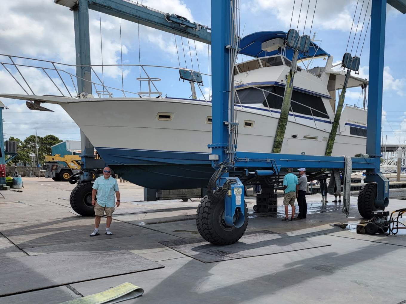

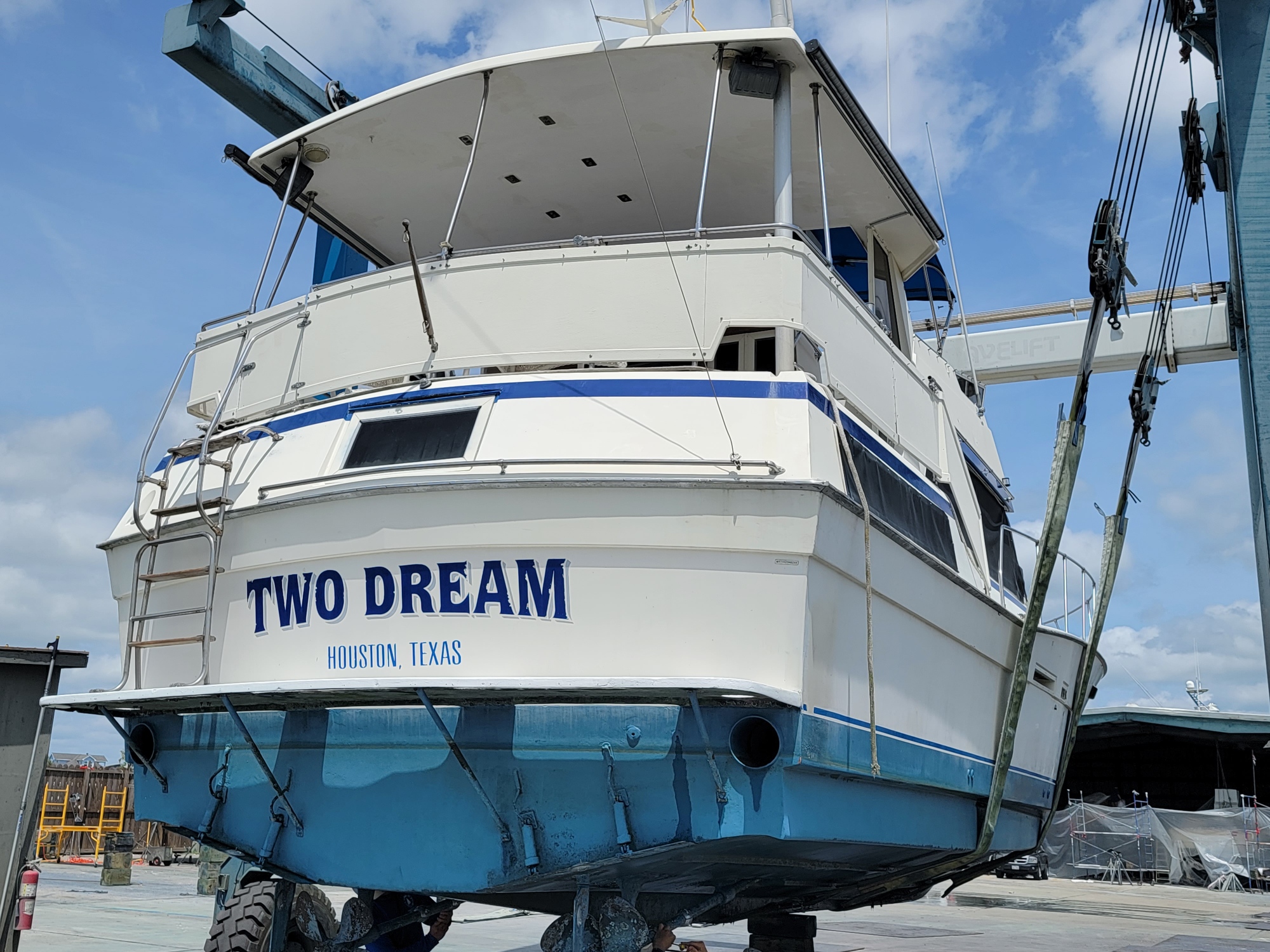

    Good advice , ill call the mechanic # I have but may try to find someone else . The boat was hauled out a month ago for Survey and was very clean on the bottom . about a 15 minute pressure wash and new zincs were installed .
