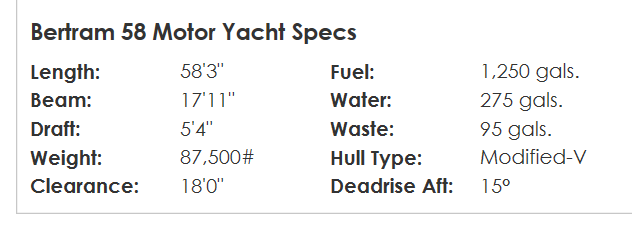

    With a 15 degree deadrise, not really in the "deep" - vee category, more like a 'moderate"- vee hull.

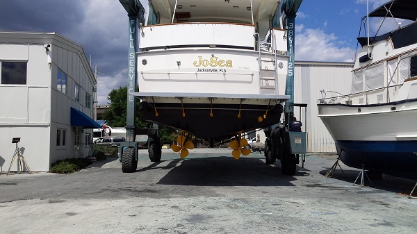

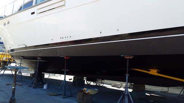

    No, she is not a 21 x 8 foot deep V with 20 degrees deadrise in da butt, she is a 58, close to 17 feet wide stern, that's a V butt.
    And it requires fuel to move.
    Usually you would find near flat butts on Hatteras & Vikings, Ole Berts still had a V in da rear.
    For a any 58 x 18, that's a Deep V.
    Yes, I see the Modified V comment.
    I've shown you mine;;;;;
    Your near my LOA, what's your ships rear look like. :D

    Send us some pics. I was not aware a 58my was on the market out there.
    Brokerage ad web site address?

    The Vikings of that era ran 15.5 degrees deadrise and their Motoryachts were at 15 as well. The Hatt’s were the flat “butts” but had deep forefoots and deep keels. The later Viking MY’s ran up to 19 degrees.
    The deadrise angle is part of the story as is the chine submersion at the transom, you can see it from the amount of bottom paint from the chine at the transom to the waterline . That is the “deep” part, but you know, a 55 Hatt Convertible of that era is just about as deep in chine submersion and will throw an impressive wake as well, even with a flat “butt” deadrise of less than a couple of degrees.

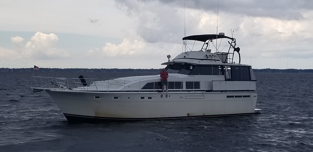

    Well, Just before a squall line, we found our new sister ship of the St. Johns.
    Scott has brought his new ship all from Panama City FL, thru 10 footers in the Gulf, thru the locks and as perfectly timed, we found each other off of NAS Jax.
    Sadly the weather was about to come down on us and could not raft up. Scott was also on a time frame to make the north end of Lake George tonight.
    I'll find him and his new Bert 58 MY in Sanford FL in a few weeks.
    Darn these 58MYs look good. Not to bad for a 42 year old design.
