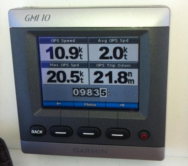

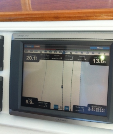

    With Quarter fuel and water and just myself on board, I have achieved 20.5 knots coming back from an anti-foul (bottom paint).

    Kafue,
    I have a few GMI-10's on my boat. I haven't seen that specific display page that you're showing. Was that a "canned" page, or did you create it?
  10. Kafue
    Kafue Senior Member
    Nov 29, 2006
    1,165
    Gold Coast Australia
    Hi Scott, that is the Garmin on Navigation with custom settings.
    I don't know what you mean by "canned"?
    Cheers
  11. Scottbee
    Scottbee Member
    Sep 18, 2012
    54
    Okauchee, WI
    "Canned" means it is one of the factory pre-configured screens. I don't remember seeing a "factory" screen with the odometer displayed like that. I'll have to take another look.

    Got it.
    BTW, I thought you were referring to the large Garmin, didn't read the GMI 10.
    I worked with the GM10 until I got the combination I wanted. There is a menu where you can select what features you choose in the combination.
