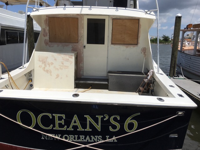

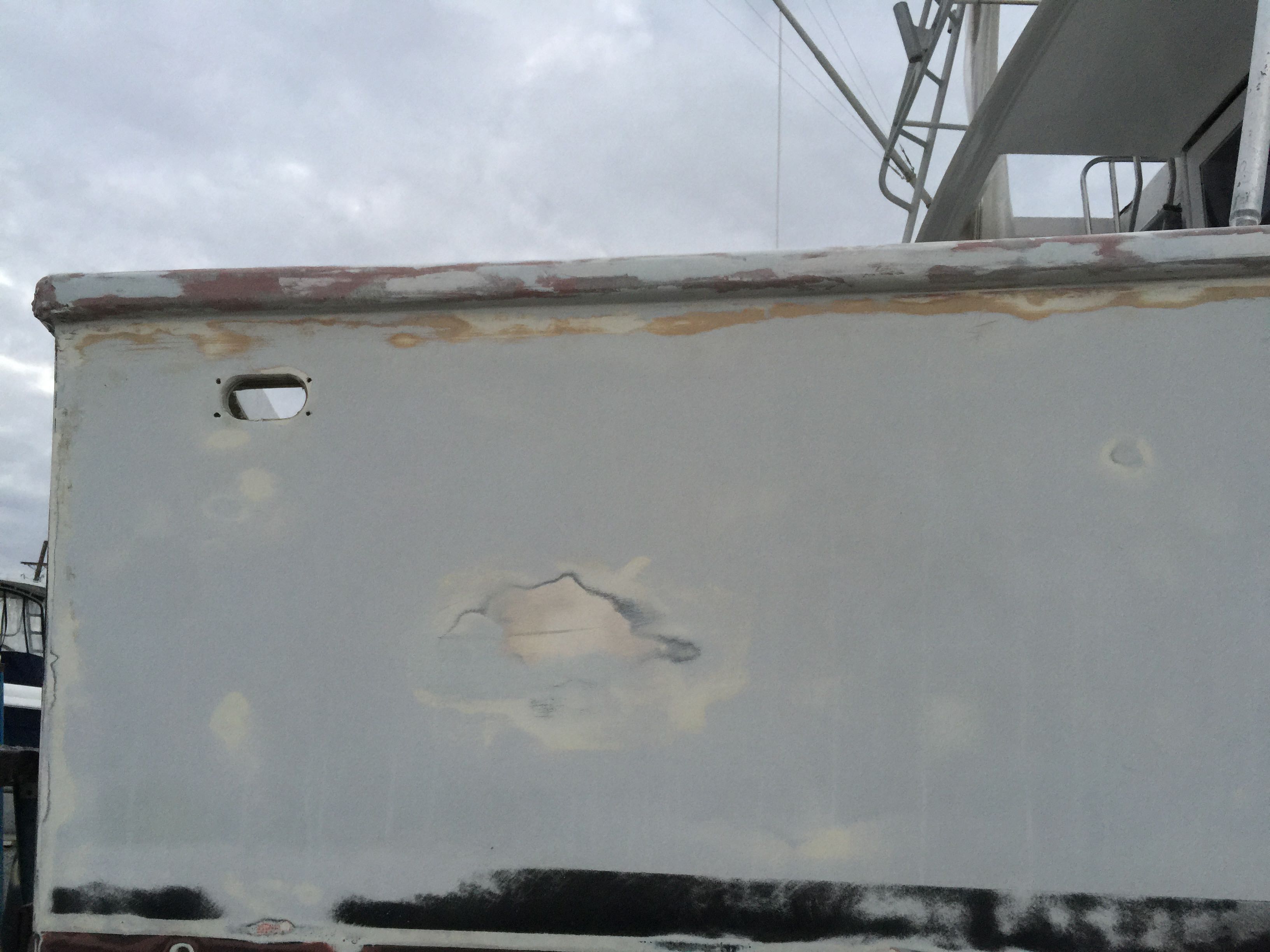

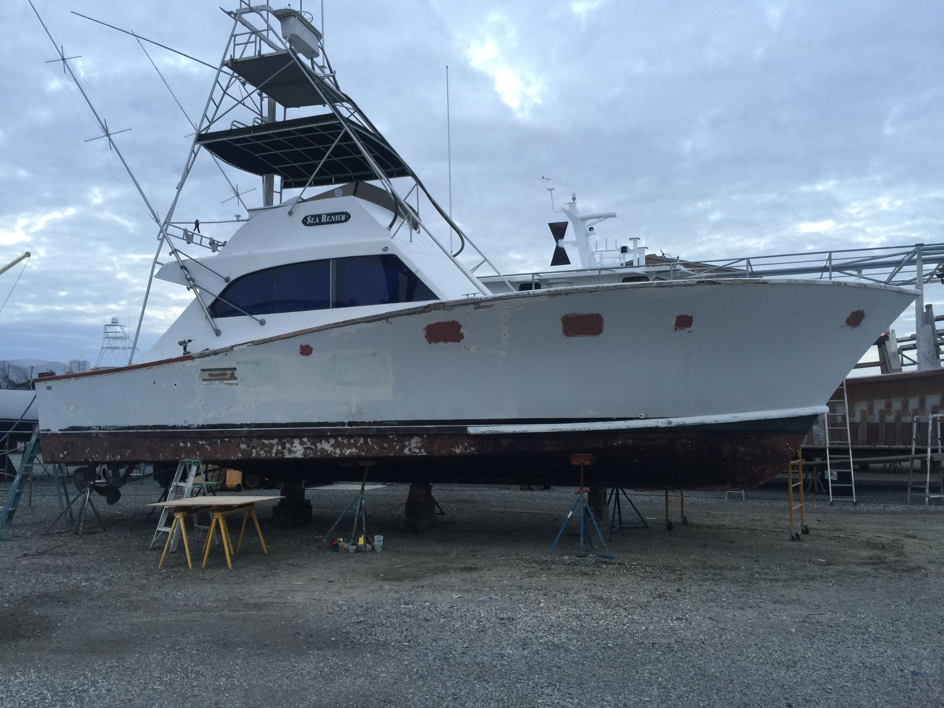

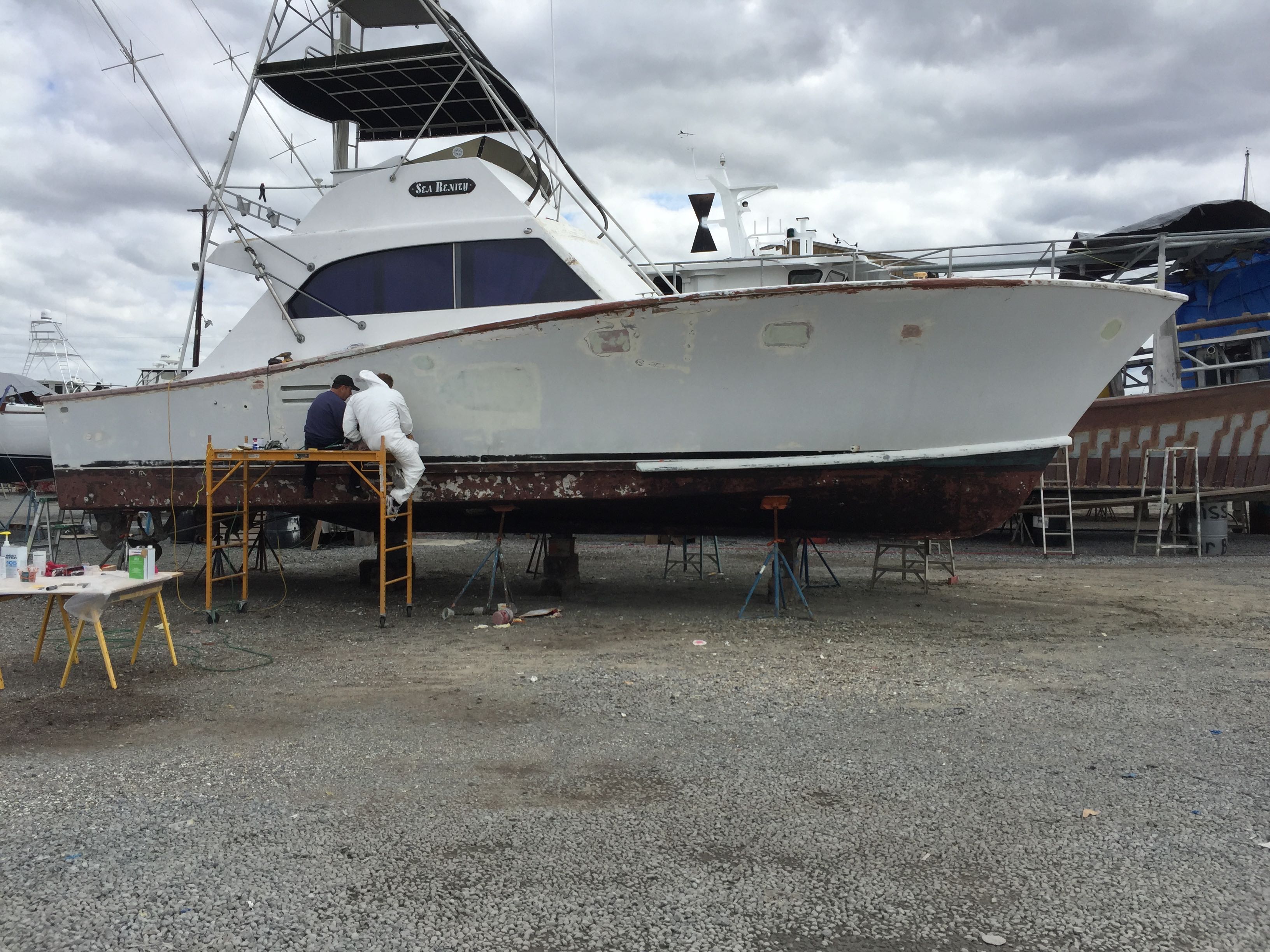

    Some updates to our progress!
    Getting ready to glass in new mahogany (aft rail) and finish fairing and filling the closed in windows and vents:
    Glassed in mahogany and most of the initial feathering done. My father-in-law and friend referencing a photo of a "newer vent":
    Close up of new rail section, ready to be sanded and shaped:

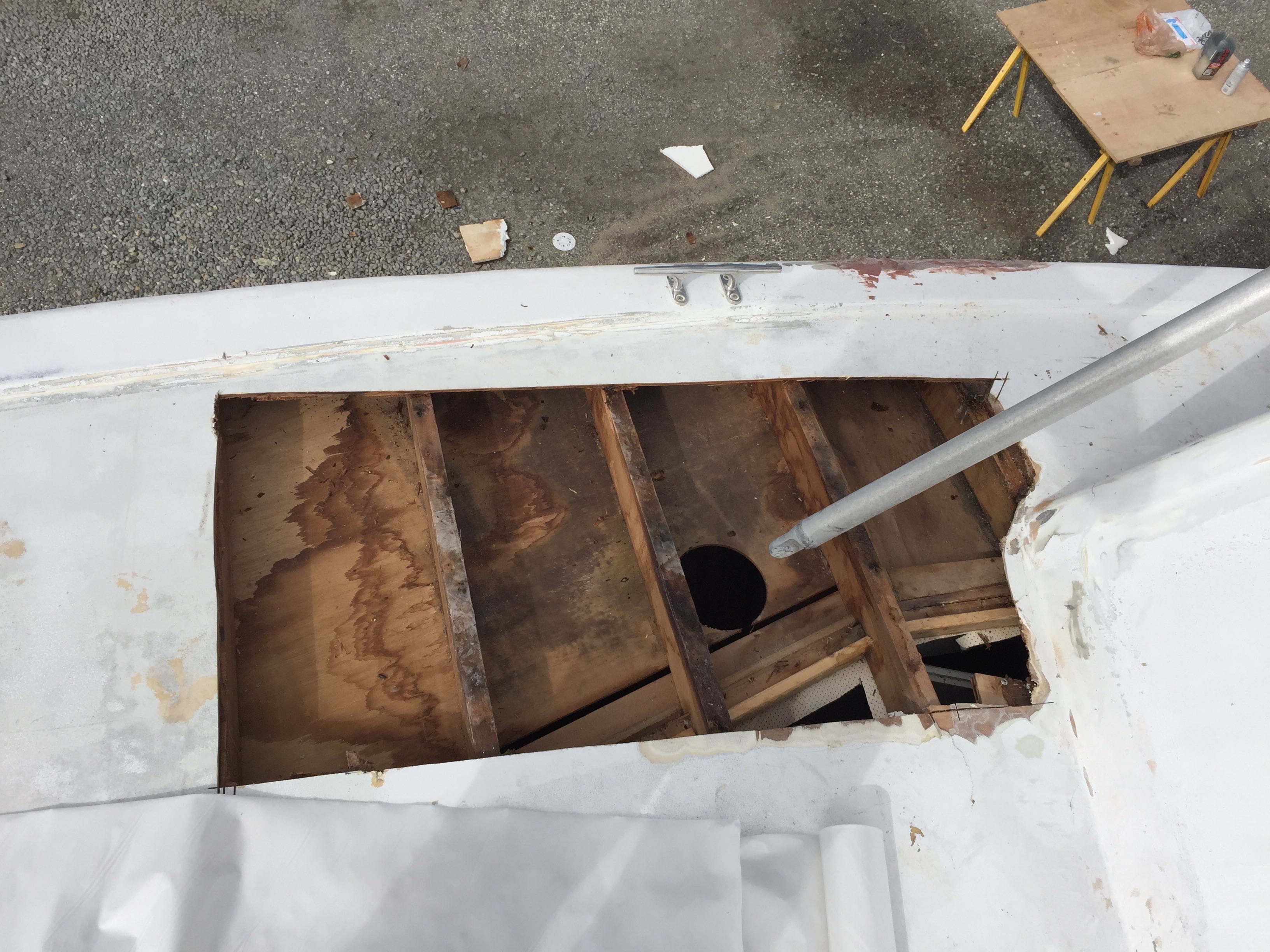

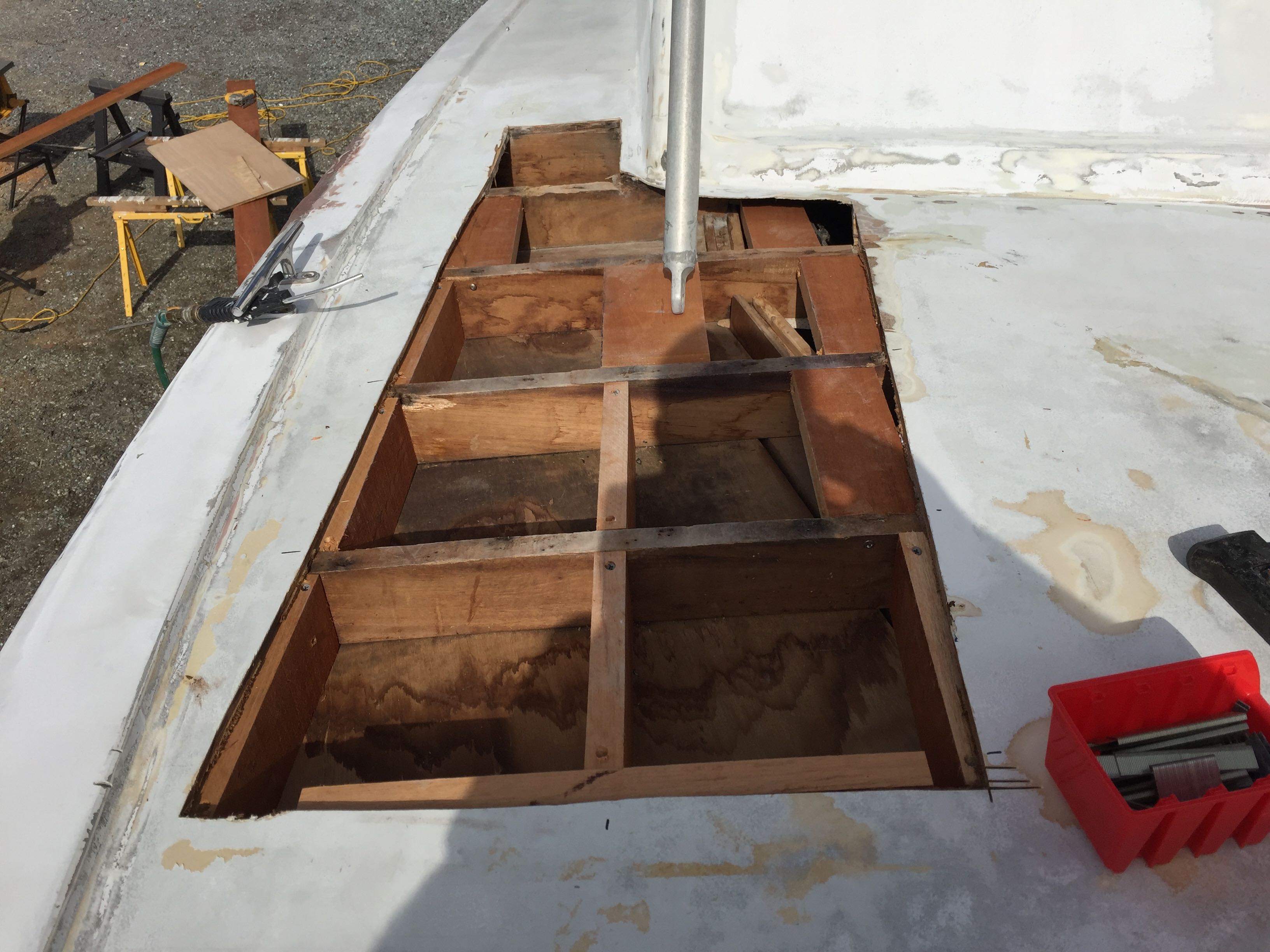

    Found some rot in the fore deck! By the way, the plywood is not 3/4" in the '75...it's 1/4":
    New 4/4 rough cut mahogany scabbed in to reinforce this heavily traversed area:

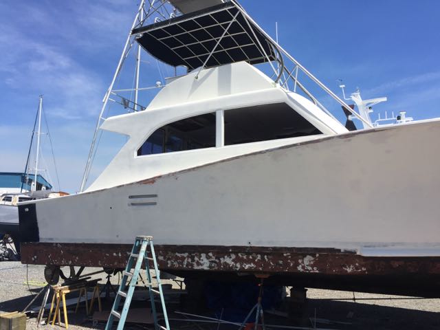

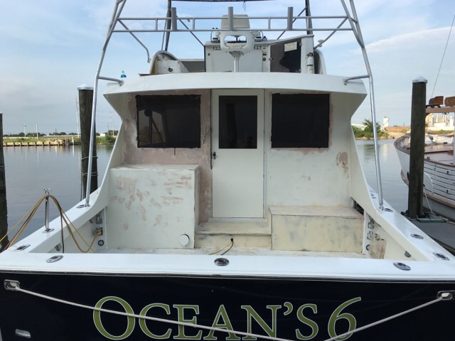

    Some updates. Had to replace the salon windows and I ended up building flanges so that I can go with out a frame:
  4. Daniel Walker
    Daniel Walker Member
    Nov 16, 2015
    65
    New Orleans, La

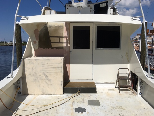

    New windows in:

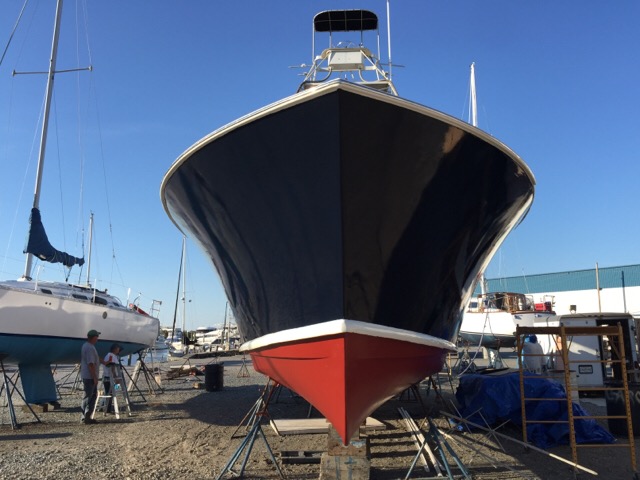

  6. Daniel Walker
    Nov 16, 2015
    65
    New Orleans, La

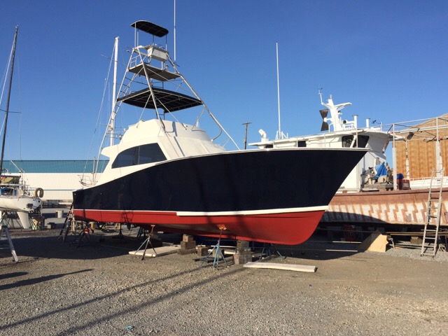

    Some updates! Had a few days of afternoons under 40% humidity. Just getting the running gear serviced and should be ready to get back in the water before Memorial Day weekend.

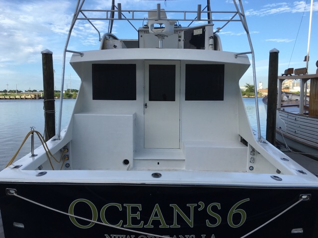

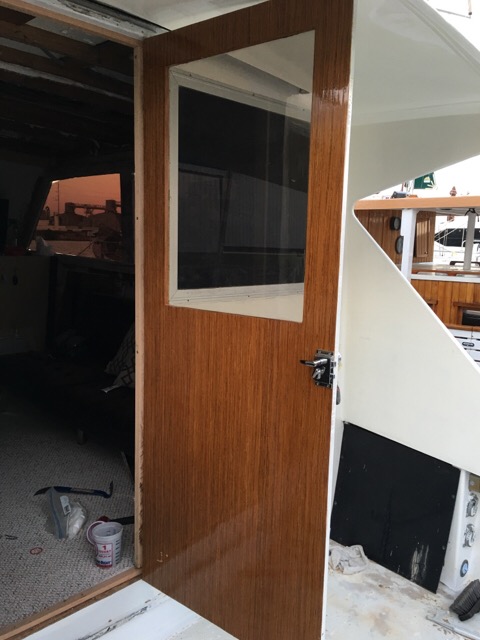

  10. Daniel Walker
    Nov 16, 2015
    65
    New Orleans, La
    Been a hot and busy summer, so slow progress on the project....but here are some updates:
    Newly built salon/cockpit door! image.jpeg
  11. Daniel Walker
    Nov 16, 2015
    65
    New Orleans, La
    New door installed: image.jpeg

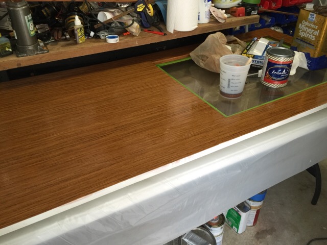

  16. Daniel Walker
    Nov 16, 2015
    65
    New Orleans, La

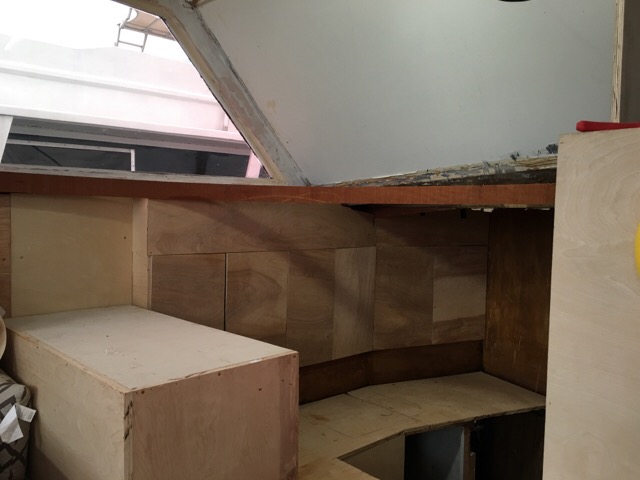

    Working on the new galley cabinets: image.jpeg

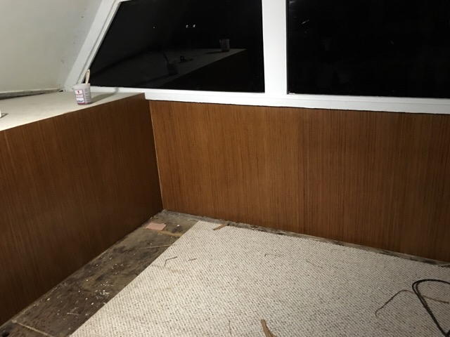

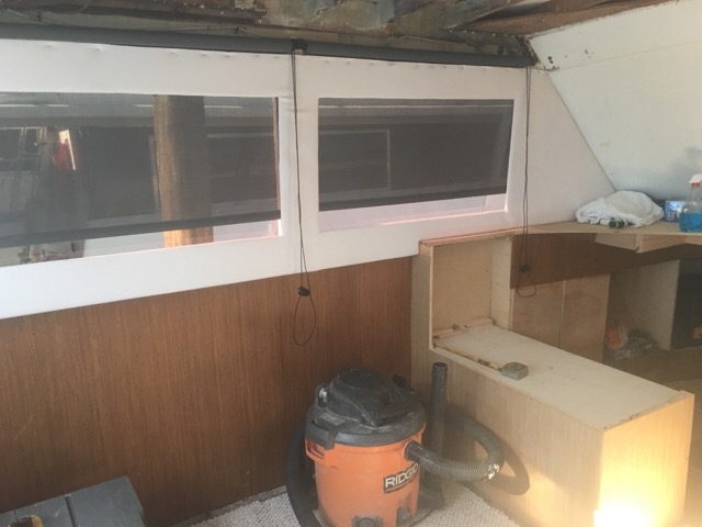

    Finishing out the port side salon window shades and window covers and wall veneers:
  18. Daniel Walker
    Nov 16, 2015
    65
    New Orleans, La
    Starting on the starboard side: image.jpeg
