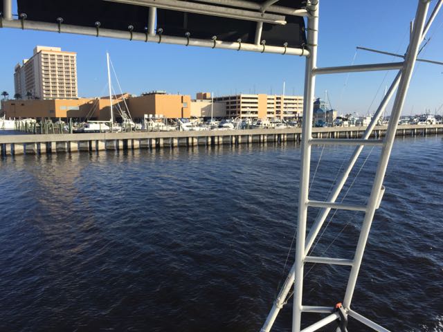

    As much as I hated to put her back into the water before I had the hull finished, I brought her back to New Orleans so that it will be easier and more convenient to get to. We (father-in law and I) primed up what we had done and set her in for the 158 mile trip.
    Except for a dead battery after splash the trip went very well and she ran surprisingly well. We ran the Gulf ICWW and it was a beautiful day on Saturday. We made our way Pensacola Bay in a 1' chop running the 671Ns @ 1850 RPM with a 16 knt cruise.

    Leaving Point Cadet Marina:
    We made our way thru the Mississippi Sound in 15 mph winds with 20+ mph gust and the temp was a chilly 45 degrees (cold for us southerners). This netted 4-6ft seas once we got out to deeper waters. We found a quartering sea, but the boat ran the same at cruise a steady 16 Knots with a little more work at the helm to keep us on course. I was please to find how dry the ride was with only once did I notice spray over the bow. With that said, I still wish I had curtains on the fly bridge....it was cold!

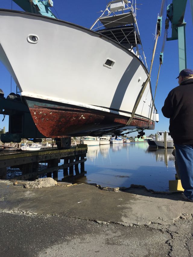

    And finally getting put back on dry dock:

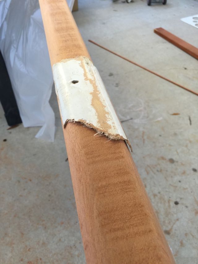

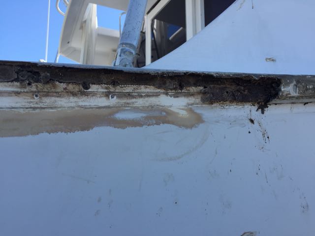

    I had a chance to pull off the old rub rails and found some rot on the starboard side. Most likely due to whoever installed the rub rails didn't properly seal the fasteners. I also found a few drywall screws were used for fasteners. Here is a pic after removing some of the mush/rotted wood:
    Will clean this up and will have to glass in new wood!

    New mahogany "core" to replace whats rotted. I'm having to shape by hand to get a perfect match of the original wood: IMG_1168.jpg
