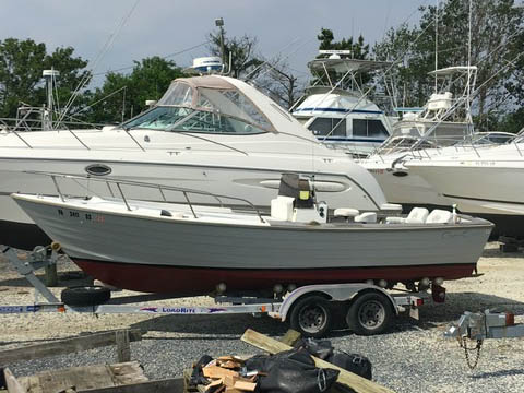

    Father’s day launch , my CC Dory rustic but I don’t mind .
    I’ll restore it when I get time.
    Still has the 1974 gelcoat on the whole top side it polishes out OK.
    Heading out this afternoon the first time this year.

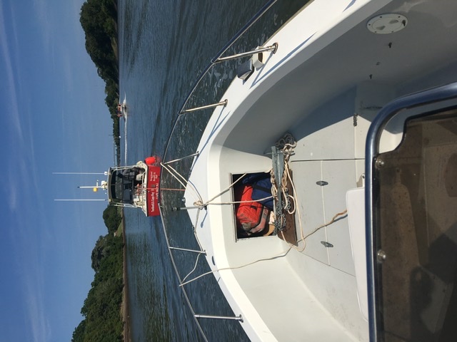

    56B9FCF7-0F12-4C26-B669-655F09E2D6E8.jpeg The old velvet drive gave out…today

  14. MBevins
    MBevins Senior Member
    May 23, 2008
    1,236
    Windsor On. Canada
    That's gonna hurt. !

  16. chesapeake46
    chesapeake46 Senior Member
    Jul 26, 2009
    1,850
    I feel your pain. Towing insurance is worth its weight....
  17. cleanslate
    cleanslate Senior Member
    May 29, 2018
    1,661
    Cherry Hill, NJ
    Yes it is. First time that I’ve had to use it.
    And my anchor…on this boat.
    Never use it.
    But I pulled it out from the hatch quickly, swift current and boats galore on the CM canal.
    Was anchored in less than a minute.
    Towboat and Captain were very good and quick.
