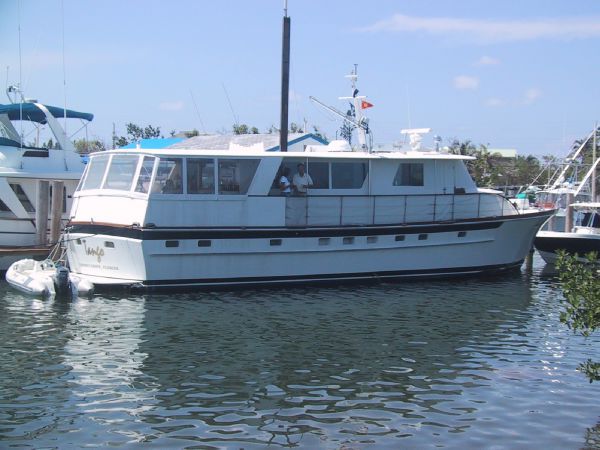

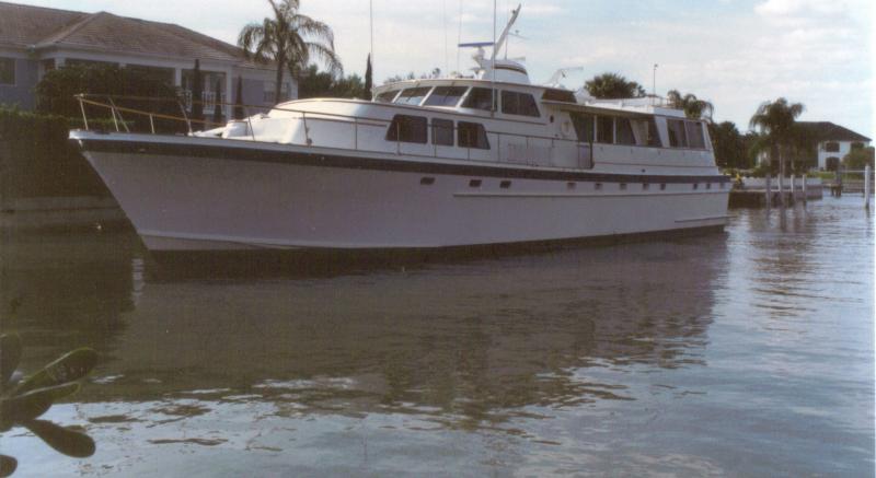

    Does anyone have any knowledge/opinions re: the houseboat style yachts built by Bertram in the early '70's? One of them has been listed on Yachtworld and it is very different for a Bert.

    She is a Bertram International, built in the late 60's or early 70's. I believe they were built in Japan. They seem to have employed a fiberglass over wood construction in the deck and house. I think the hull is solid glass. The construction and interior finish of the Bertram International bears no resemblance to the Bertram Yachts built in the US in that same era.
    The yacht in the photo is a handsome craft. I have seen her previously in Punta Gorda Fl.
    Highlandscott likes this.

    I did some research. The Bertram International yachts are built on a solid fiberglass hull. The decks and superstructure are what Bertram describes as "sandwich" construction. The sandwich consists of two layers of 5 ply Philippine mahogany plywood. In between is a criss-cross framework also of Philippine mahogany. Slabs of sound deadening foam fill the 12" x 18" spaces formed by the framework. The assembled fiberglass coated sandwich is then covered on the underside with an acoustical nubble finish.
    This construction is used for the weatherboards, sides of the deckhouse, deckhouse top and hardtop, and the main deck itself.
    For many years there was a 56' Bertram International Motor Yacht kept on my same dock at Piney Narrows in Maryland. I was aboard that boat a few times. The decks always seemed a bit spongy to me under foot.
    With knowledge of this type of construction, I would survey carefully.
