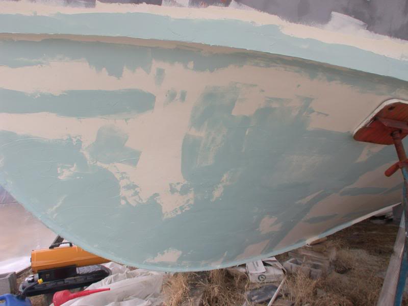

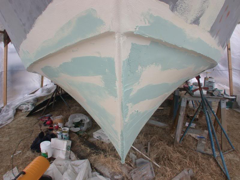

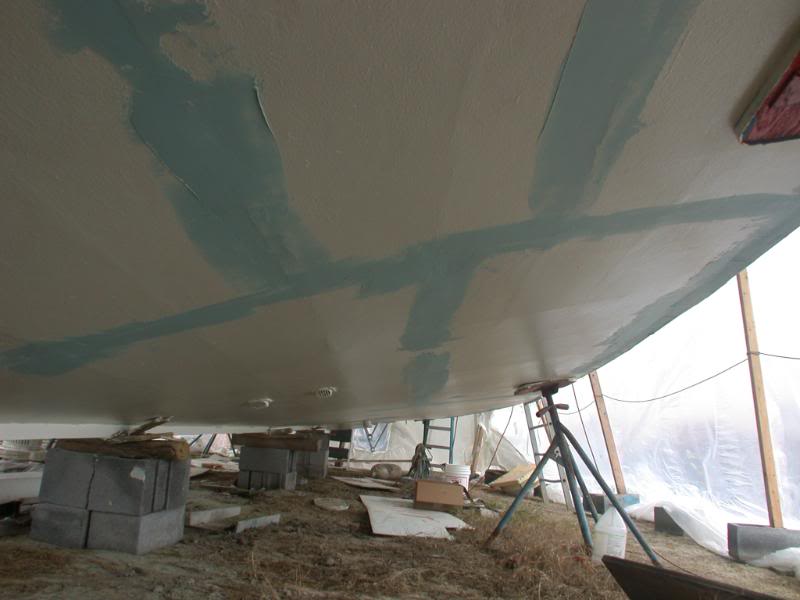

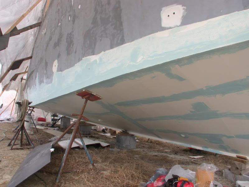

    q240z fairing post
    I forgot about the awsome job being done on a 46 footer by q240z. I refound his activity surfing the otherday but his posts here in the Roamer forum are more in depth.
    Qouting from his post here is steps he followed including fairing the bottom. As expected pretty penny to do so but u then have a a top of the line effort. Maybe on Roamer number two in my future I do my best to match this level of quality. No "boatamalans" for me though as even beer wont budge my friends into work.
    q240z
    "Also, for what it's worth, the following is the schedule I've adhered to for this boat.
    1) Sandblast to near white metal except where original fairing compound is in good condition.
    2) Alumaprep & Alodine to all exposed aluminum (possibly not necessary with appropriate "tooth" on the aluminum, but who wants to take a chance?)
    3) Three coats of Devoe 236 Bar Rust epoxy primer from the keel to a foot or so above the waterline.
    4) For underwater filler work, I recommend Interlux VC Watertight Epoxy Fairing Compound over Devoe 236. When applied within a few days after the last coat of 236, you get a fine chemical bond between the two epoxy products. The theory being that Devoe 236 flows much deeper into the pores of the metal than a paste filler can, yielding the best mechanical bond from aluminum to epoxy. Then, you have the outstanding epoxy-epoxy chemical bond from primer to Interlux filler.
    5) For above the waterline, I recommend LBI vinylester fairing compound in the 5-gallon pail. I was using 3M Premium Marine Vinylester, but one gallon of 3m is $88 wholesale and 5 gallons of BLI is $168 retail. They look the same, they smell the same, they spread the same, and they're both vinylester.
    6) Decks get the same treatment as below the waterline--Devoe 236 primer then Interlux VC filler.
    7) Finally, the whole thing will get three more coats of Devoe 236."
