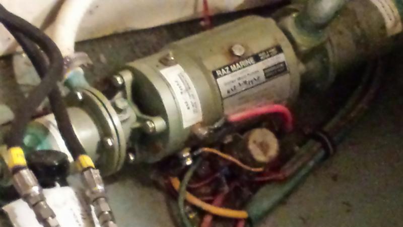

    We're on a 56, but our forward pump is on the ledge under the floor in thst stateroom, the VIP is under the floor panel in the front of the stbd engineroom
    and above the floor in the back outboard side of the stbd engine room for the master. pump.jpg

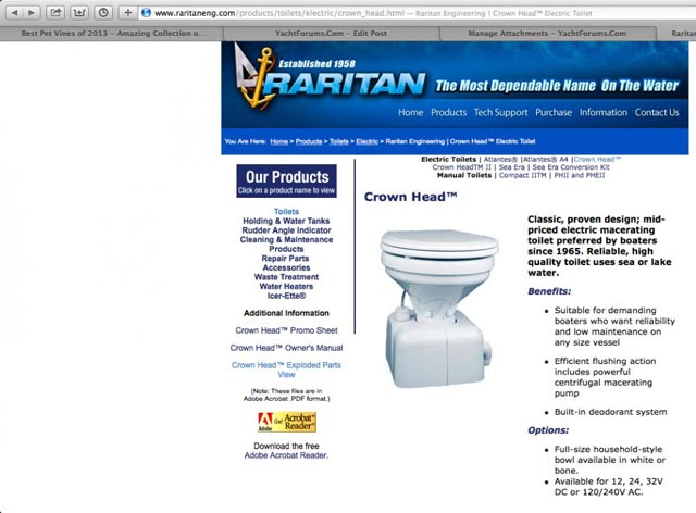

    Ok, I found out it is a Crown Head made by Raritan engineering company. We have been in the engine compartment and can only find big black rubber sewer hose connected the holding tank. We cannot find any valves anywhere on the hoses or near the holding tank. Yes when we flush there is a pump running, the stateroom head works but it is a different one than the one by the kitchen area that is giving us trouble.
  9. franzmerenda
    franzmerenda Senior Member
    Mar 3, 2009
    120
    La Spezia, Italy
    http://www.raritaneng.com/pdf_files/crown_head/L91v0307 Crown Head CD Series Manual.pdf
    http://www.raritaneng.com/pdf_files/crown_head/L193crownheadv0900.pdf
