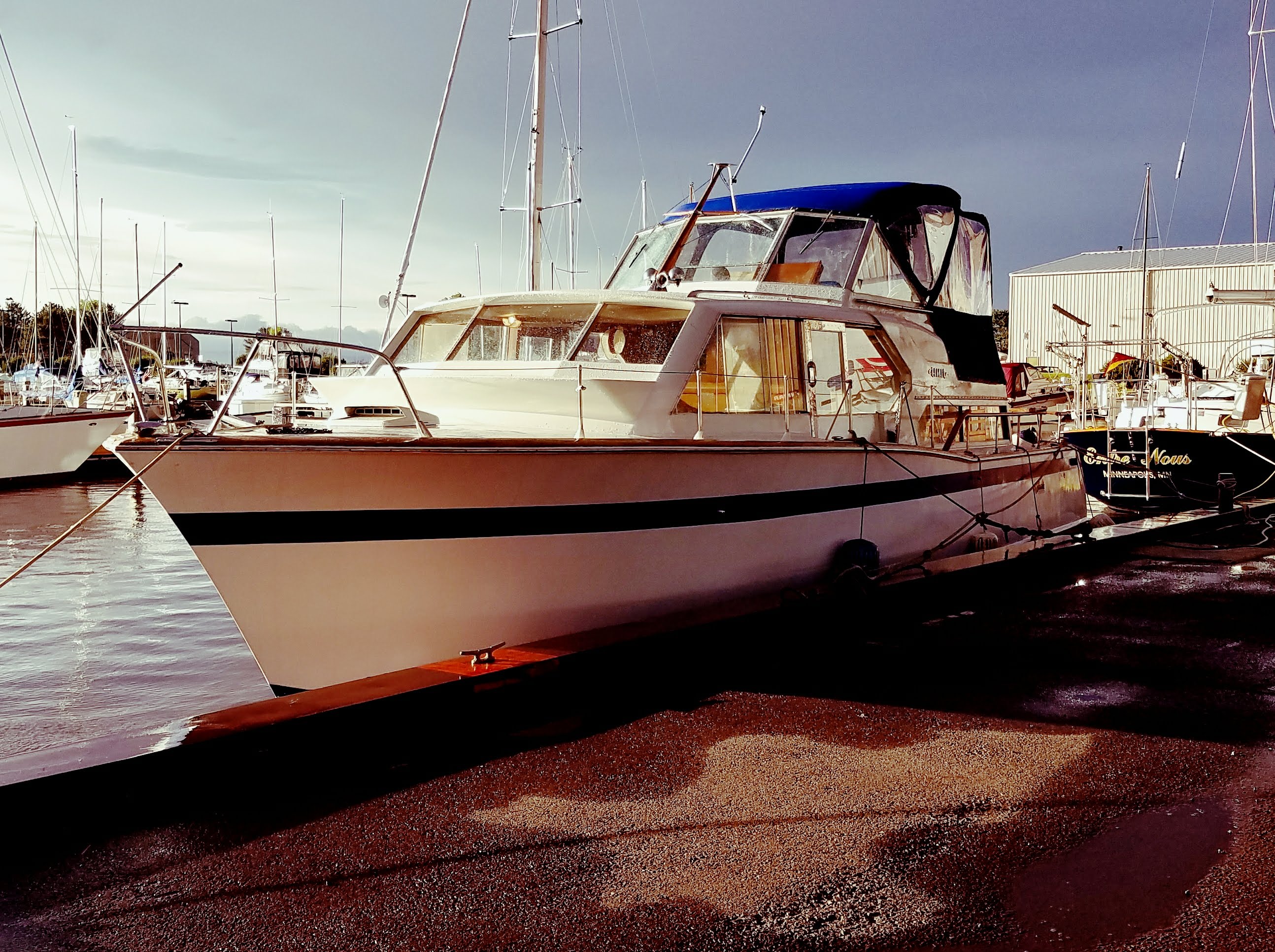

    Not many of these aft cabin 38' Commodore Roamers were made apparently. My Commodore was renamed "Buzzards" in 2017. The boat was known as "At Ease" prior to 2017. The boat has been used out of Bayfield Wisconsin continuously for at least 20 years. Power is twin 430 Lincolns and runs great. The hull was restored with about 10 small patches welded on in 2017. Also a paint job on the bottom. This year 2019 is the first year that we won't be in the water. I have decided to bring the boat to my farm and work on it close to home. I find that working on the boat at the marina, either in or out of the water is not very efficient and somewhat frustrating. This is a big boat to haul and I'll post how that goes. I'm a new member and will take a while to get up to speed on using this site.

    Your boat is big, but pretty typical for a big boat hauler. We used Boat Logistics out of Montegue, MI. I can recommend them. Rusty is a pro, showed up on time, moved our boat right on plan (58’ x 17’). The big thing is getting the vertical clearance down. In Michigan all utilities are supposed to be 18 feet or higher. Overpasses can be a problem. We loaded out at 15’ 6”. He can haul the boat with the keel about 12 inches off the pavement.
