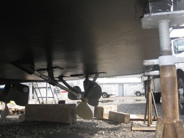

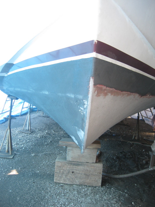

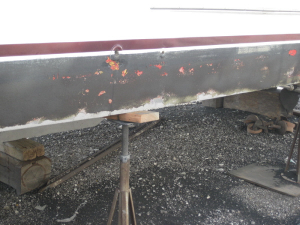

    Careful with that blasting! If you get down to orange primer, thats a pretty decent barrier coat they used at the factory. When the blaster comes around and above the chine, be prepared to enconter fairing compound (bondo) which it IS NOT!! Dont think about blasting the hull sides unless yer a good body man... trust me on that! If theres a little spot or crack in the fairing here or there, spot blast that clean down to the steel and then make a repair. Make sure all the doors and windows are closed up tite! Even some tape over the window joints will keep a ton of dirt out of the inside.

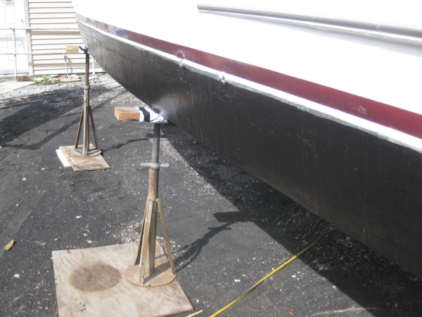

    I just did mine last spring, used 2000 + lbs of black beauty and finished with two full coats of coal tar epoxy then bottom paint. The coal tar is about $40 for a gallon (two part) and is an excellent electrical barrier coat. r n

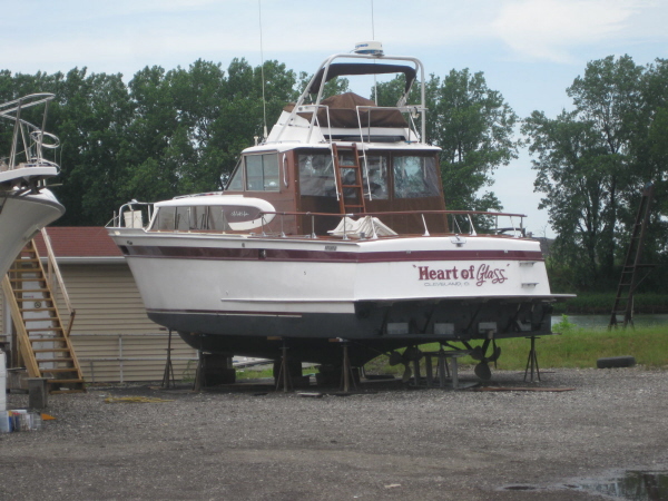

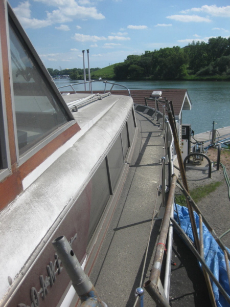

    Just a shot showing the coal tar (immersion grade) and, the finished project! r n
