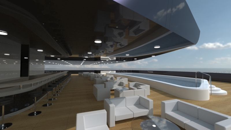

    Hello everyone,
    My diploma...

    more renderings...

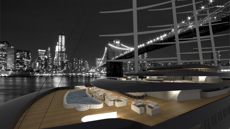

  3. Lovely, mainly the last 2 pics about the chicks women aboard. ;)
    They are really so tricky, you got right. This pic I loved most.

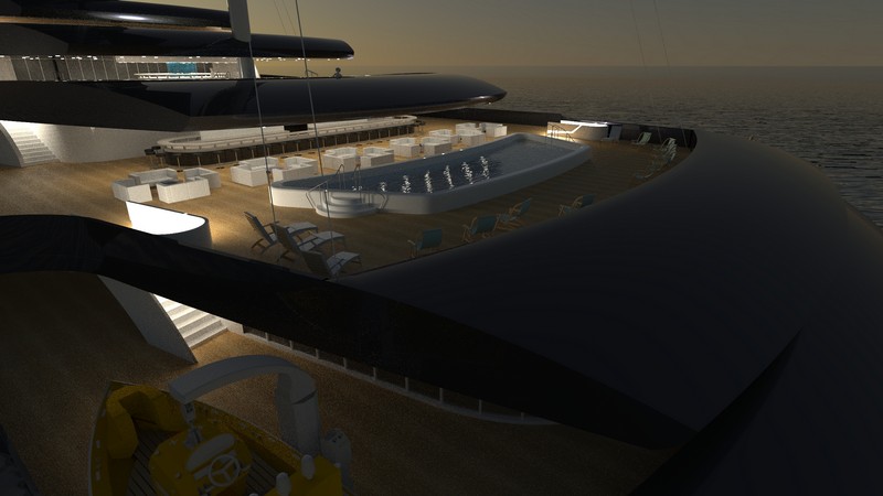

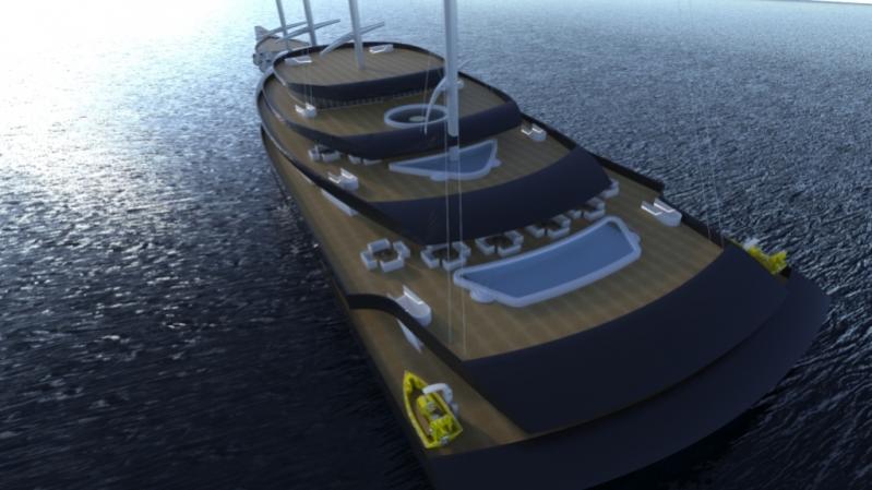

    few more...

    What makes you so sure about that?
    Given the position of your lifeboats on the forward part of the ship I doubt you have any NA experience or Qualifications so your current renderings will remain just that.
    Given that,they are very good so your drawing skills are very good so don't take what I wrote as a criticism of your personal skills and abilities in that direction.

    Thank You for comment but could You explain me what is a problem with those boats?

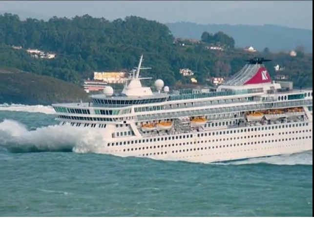

    The way the Lifeboats appear in your rendering makes it look very likely that these would be damaged or destroyed by a big sea, if there wasn't so much sticking out the side it wouldn't be as likely to occur.
    They need to be better protected from the sea.
    Here is a picture found on a You Tube clip of stills, this should give you an idea of how vulnerable the boats are that far forward. Also note how high and well protected the boats are in the photo.

    Well you need not to look any further than the Oasis class of ship. Their boats are very low to the water and the forward boats are close to the bow. In fact, I think "Oasis of the Seas" had one of those forward boats damaged by big waves coming off the bow in heavy seas. They had to construct a metal shield to help protect them.

    I have life rafts at the aft area of ship so it is not such a big problem.
    Whay I made this chose...... I wanted to separate 2 functions- technical (life rescue) and recreation. I don't want to see situation when passanger must to look at huge life boat next to the bar. Thats why I moved them forward where I created technical area where i have: ewacuation area; storages; workshops, etc.

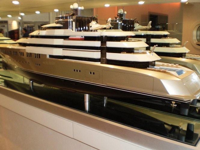

    Can I recommend to try and keep things like lifeboats in a practical location/s as well, as K1w1 has stated. A boat of this size will be carring 100+++ crew and guests, (when needed) first everyone has to report to the muster station, and crew then forward them and them selves to the lifeboats. The muster station could be the main dining, then everyone has to proceed to the lifeboats... that could be 100m+ away by the look of your design. You could hide the boats in the side of the hull with ease (see attachment), you'll only need two of those boats as well...?
    I'm currantly developing a 170m and 200m boat, both will have lifeboats at amidships, as the heli, vehicle etc hangers will be situated up on the bow, cause there not really (practically) needed. The lifeboats are actually half covered by a design feature, otherwise it would of looked fugly, right. I also did a two day delivery last month (free), to get a better insite from the captain, and how the boats design formula worked.
    When you go in for your first meeting with a builder, managers, owners etc, and the builder ask why something is where it is... you can't say cause it looks good, especialy with a new concept. All that boring stuff DOES count, cause a lot of that stuff has a huge impact on where your pencel can and can't go. Talk to the engineers, Nav Archs, captains, deckies, and trust me - listen.
    Hope I was a help. Cheers
