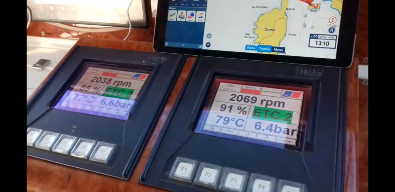

    We usually see anywhere between 80 and 90c.
    More like 83/ 84
    I'll let you know the warning levels later.

    Warning level is 212. At 1850 rpm I’m at 181 f. I have 12v2000 trying to find out if that is normal or if my thermostats are 182 or 175? At 1650 rpm I’m at 173F.

    I would say your readings are in line with mine. Normal to me.
    But cold sea waters will lower the engine coolant temperature for sure. See the picture taken in the winter.

  12. ArielM
    ArielM Senior Member
    Jul 8, 2010
    179
    Los Angeles
    ya for sure. I’m running in 82-84F water temps lol.
