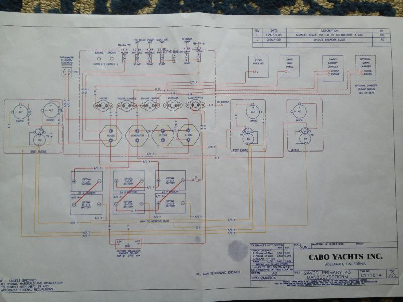

    15kw westerbeke gen wiring diagram
    Thought some of you would like to review the low voltage wiring diagram on the boat.
      62.2 KB
      1,515
  4. Capt Ralph
    14,557
    Wow
    OWO, The read I get, Both mains and gen-set run from the same (smaller) bank. Stb main has two alternators to charge the house and starting bank. Port main and gen-set also charges the same starting bank.
    Windlass runs from the starting bank also. There is a parallel solenoid for the only two banks. Some other notes are fuzzy when I expand the schematic.
    Question one; What drugs were involved when this was designed?
    Two; Do you have any room for another set of batteries?
    Three; Would you like to improve this design? Remember q 2.

    Ya know, This does reinforce our thoughts; Batteries were not low to shut down the gen-set.

    Thanks but think I will leave it alone.
