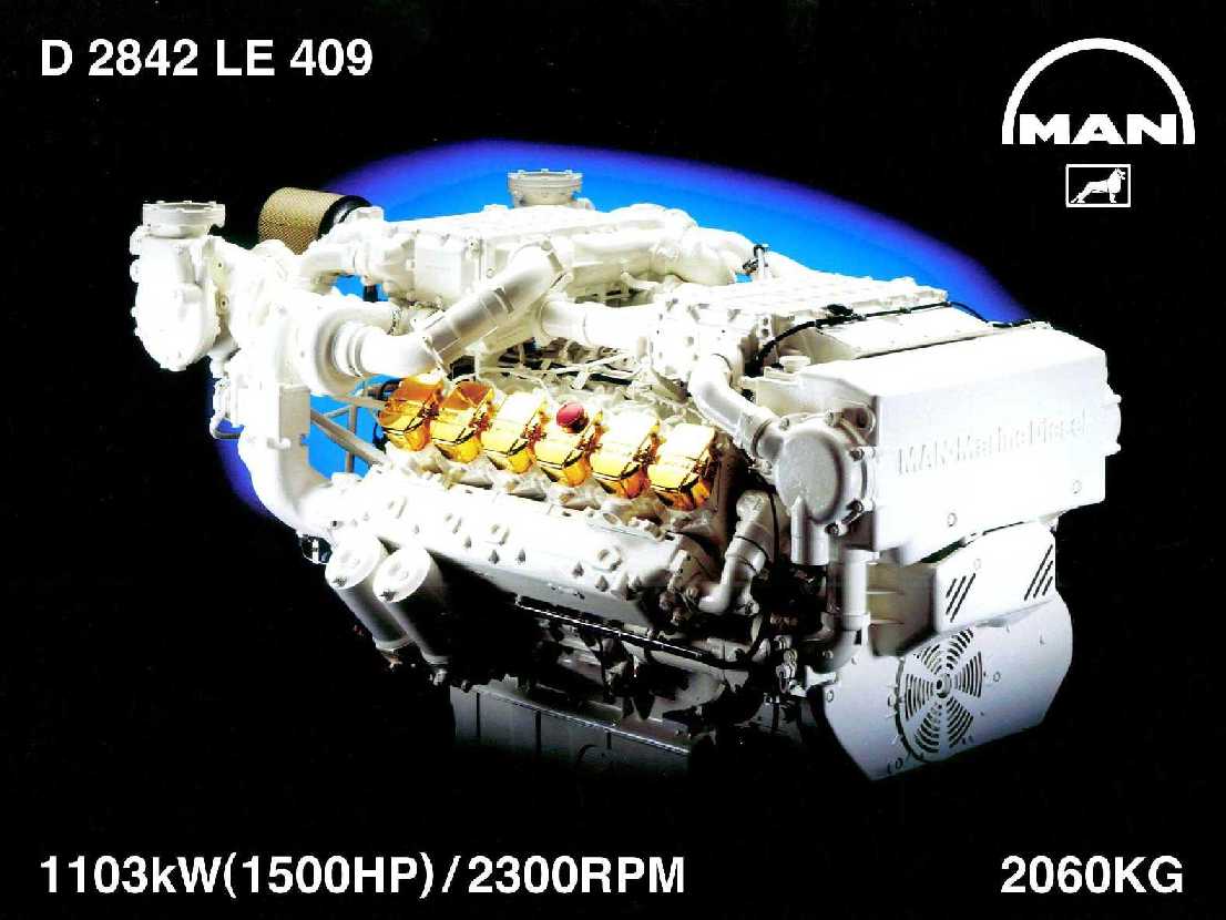

    I have been reading up on the 1500 hp V-12, is this the one that came out right before the common rail motors and thus has 4 turbo's per engine, with sequential stage boost?
  6. CaptPKilbride
    CaptPKilbride Senior Member
    Mar 16, 2004
    587
    On the water
    The 1500 hp MAn engine of that vintage is the D2842LE409
    Two stage turbocharging with twin aftercoolers.
    Wow.
