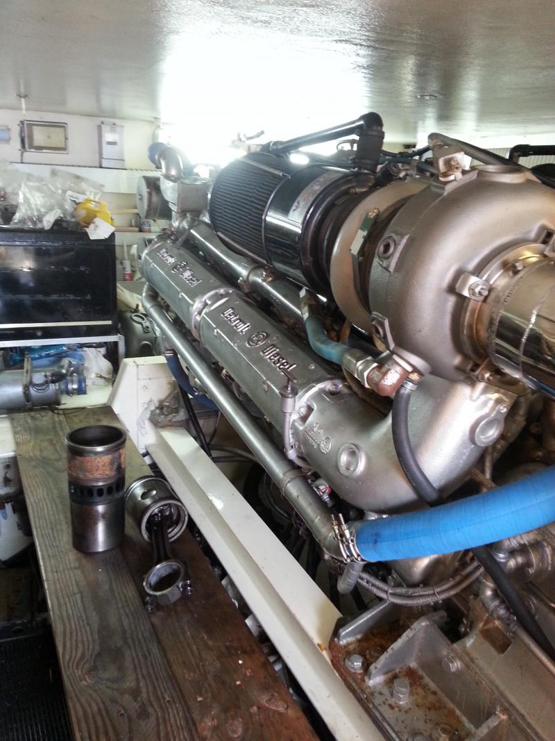

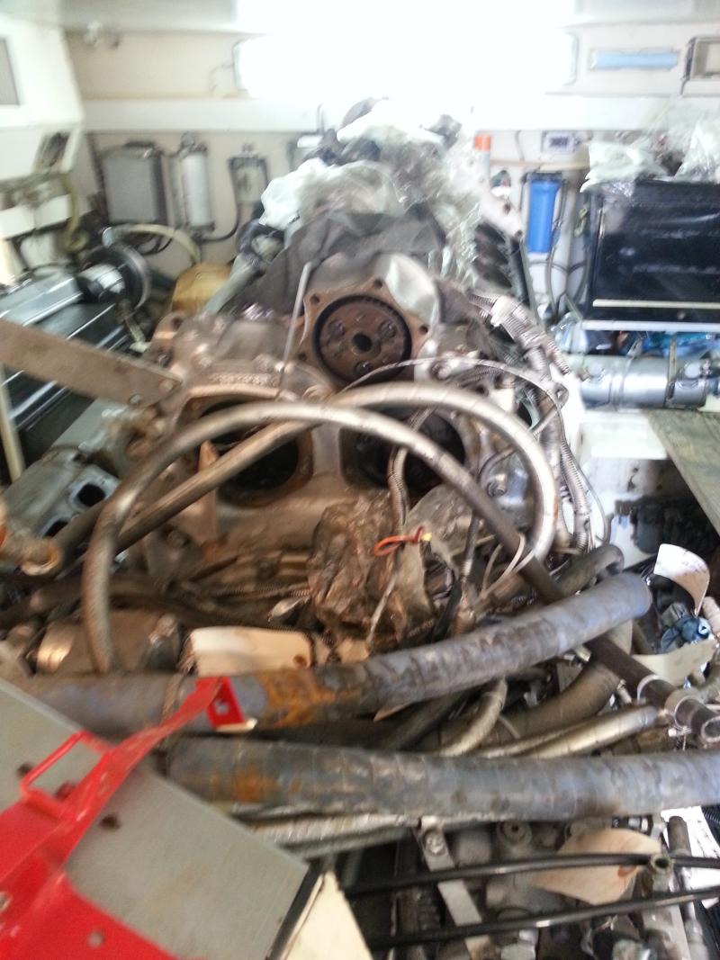

    Hi All:
    I'm currently rebuilding 2 12V-92's in a 58 Viking. The owner bought the boat with 1 (sorta running) engine. After taking a bath from some previous idiot and 10k into it he decided to find someone who could do the job right. The boat came up to Stockton from the Bay Area on 1 engine. The port engine was torn completely down before we got it. A total disaster, parts everywhere. One of the cams had failed. We took a compression test, then pulled down air box covers on the starboard engine for inspection. Compression was low and the wear grove in the top rings were gone.
    The owner decided to rebuild both engines. New kits, rods, heads with new new valves and springs also running gear (cam followers, rocker arms), vibration dampeners, rebuilt blowers, governors, turbos, water pumps and injectors. Main and rod bearings. The four cams were replaced on the port engine without removing the rear flywheel housing. The cranks were in good shape.
    The owner will be in at approx 125k for both engines.
    I would not hesitate to overhaul those 92's in the boat as long as the cranks are good condition. It would be another thing if the seized engine is from lack of oil, spun bearings etc... Then you have another huge expense getting the engine out.
    Your biggest problem is going to be able to find qualified DD techs, not many of us around any more.
    As a side note getting ready to pull 2 8V-92 DDEC's out of a Sea Ray for complete overhaul. The owner bought the boat right at 25k with 1 engine full of coolant.
    As to someones comment about doing the other engine at the same time, if you have money it would make sense. Now you know the history!!! Not relying on someone else's BS.
