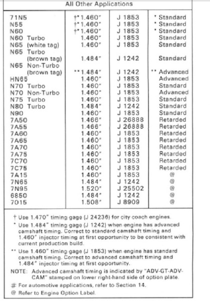

    Those settings are for generator sets (see the very top of the page), however I did run a 75' Hatteras with 12v71's that used the generator set setting. There is a seperate section in that same DD book, that is for marine engines and the same injectors for the same engine will sometimes have a different injector height.
  2. Capt Ralph
    14,572
    Top of the page is for generators, just below that it states "all others"
    ,rc
  3. Capt J
    14,896
    Yeah, but in the same DD book, there should be a seperate section for marine applications. I don't have the book here, but I've seen it in there. But also over the years, J+T, Convington and others sometimes used injector settings that did not match what the factory DD book said so sometimes you've got to be careful. If it's running good it's best to measure what the injectors are currently at and compare it to the book.

    Does anybody know the reason for the injector height setting?
  5. K1W1
    7,453
    Timing

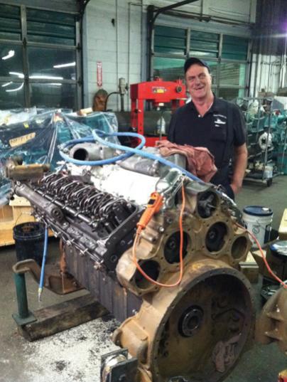

    As Gary knows, (because we discussed this on another site), my 12V71TI from my Bertram 54 was just overhauled on the stand in the shop by one of the masters of the trade. John Carey of Carey's Diesel in Leipsic DE. My engines like most of the high output 12V71TI engines in the Bertram's were Key Power conversions. Mine use the 9215P injectors and John set the injector height to 1.500
    Attached is another chart with some additional information on Injector Timing. As you can see, the 9215P injector was not even made at the time which adds to the difficulty of interpreting the book!

    Tony Selby at Johnson & Towers initially agreed to take the job. Then, when he found out it was a basket case of parts left by Central Marine, he flat out refused to get involved.
    Central Marine took a year and $25,000 to remove the engine from my boat and leave it as a pile of parts. Ultimately I had to sue Central Marine for replevin just to get my parts back!
    John Carey took my engine from a basket case of parts left by Larry Cress at Central Marine to properly overhauled and back in my boat in 35 days. John is a good man.
