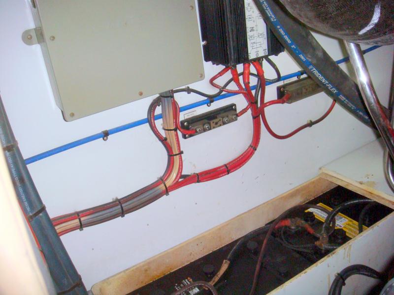

    Yes.. If you look at the schematic, you will see that there 3 12 v batteries on each engine.. 2 are in series for the 24 volt system.. and the other is for the 12 DDEC system.. The "House" batteries are the 2 located in the fwd/center...
    From what I can gather. the constavolt sends the power thru to the 12's in series... and the 12 constavolt sends power to the 12's for the engines and the "House" batteries...
    Also tied into the system are the 2 "Load Equalizers" on the hull above each set of batteries. This with the constavolts power the 24 and 12 volt batteries for the DDEC system....
    Kinda of like going around your assh*le to get to your elbow.. But it did work good at one time.. I would love to upgrade my 12 DDEC to 24.. as I understood they did later on because of that 12 power drain problem for running the DDEC..
    Someone correct me if I am wrong...:)

    So if I get this right...you are relying on the generator and a battery charger to charge the 12v battery needed to run the DDEC?
    If so, this is just plain stupid... There should be a 12 v alternator on the engine to charge the DDEC battery.

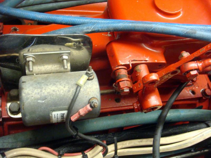

    Have not been able to see where my alternators kick in .. Have not been able to run them at that high of RPM yet... Here is my emergency shutoff solenoid.. It is the old style w/ the rack rod to connect the 8+8 cylinders.. Newer style has 2 solenoids...

    Get rid of this battery equalizer asap. I know of at least two instances where they've gone bad and burned the boats they were in, most recently in a 2000 54 Bertram that I had.
  12. captsam54
    captsam54 Member
    Sep 30, 2008
    63
    Somewhere in the Caribbean
    WOW.. I will have to do some serious research into this.. I wonder if I can just disconnect the leads without disrupting the DDEC system....
