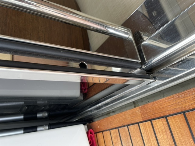

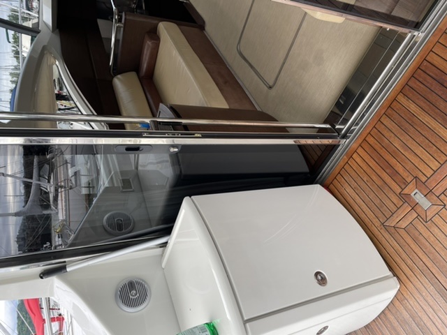

    Hi, I currently own a 43S. Very happy with the vessel. i would be glad to answer some question. Got VOLVO IPS 500 in it. On my end - i got only question. How do you lock in place the portside patio door ?

    While were waiting, can you send some pictures of the door, latches and description of what is/is-not happening when you try to secure the door.
    Is there a stb side door with similar hardware? Con you comment on how that door is working?
    If another owner does not come onto this thread, maybe we can figure out the hardware and figure out your issue.
    Also, MarineMax used to support these boats. Any communications with them yet?
    As many of us have learned the hard way, factory manuals (with details) are non existing.
    But, just in case, do you have any data on these doors or hardware involved?

    Hi
    So the portside patio door is always sliding. I bought the boat like this.
    i have to lock it into place with foreigh object everything i use the boat
    I beleive someparts are missing
    wish someone can post there patio door so i can see the difference

    Here s a close up

    How does the stb door stay in place?
    Have you tried to contact Marine Max yet?

    Stb door with floor pin
    no hole or pin on portside

    There should be a latch on the bottom or a hook to hold it place. Probably something you need to add your self. What year is the boat?

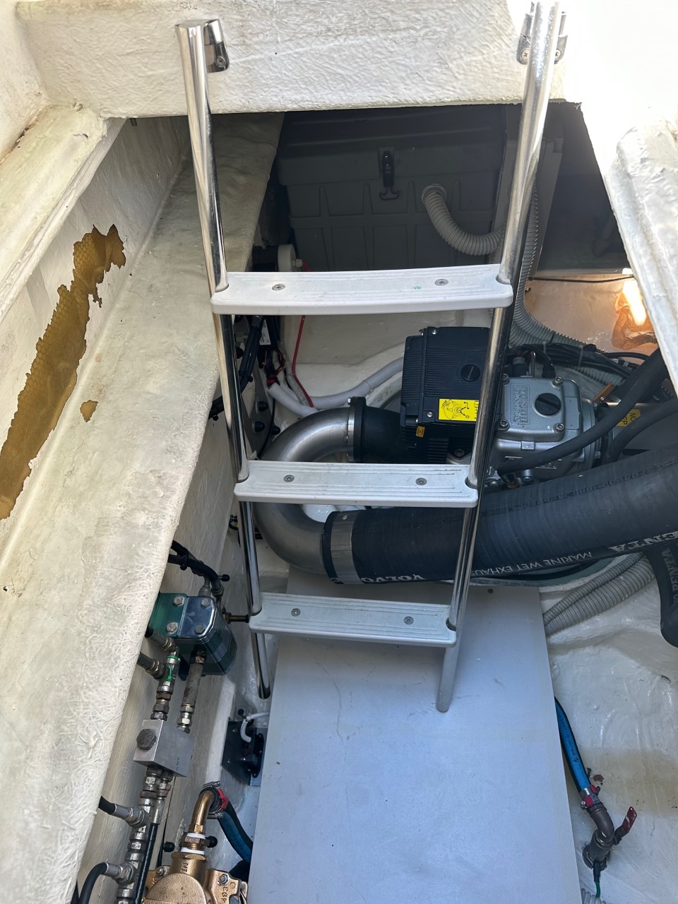

    Dear Friends
    I have this 07 Azimut 43S and my rear engine room access ladder, the one that you need to open the seat to go inside the engine room
    So, my ladder have the steps in angle and one of the ladders feet don't even reach the floor at all
    I wonder if any of you guys may know what my problem is and if you have pictures of your ladder assembled in the boat
    Thank you all
    Ricardo

    Well yes, who ever installed this was a SFB.
    Get some rubber feet on the exposed tubes and remount the top correctly, so both legs are plumb on that bilge plate.
    Don't forget to insert a large washer in each rubber foot to keep the tube from cutting thru.
