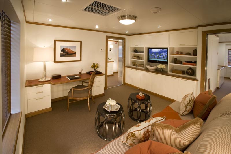

  1. The owners private study is located adjacent to the master, on the port side. Complete with built-in book shelves and cabinets that house a flat screen television, the office is comfortable and accessible with dual entries.

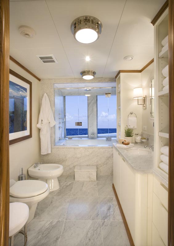

  2. If the Crew of this Crabber turned Escort ever saw a bidet onboard their prior platform, it would likely become a rip-line on an episode of the Deadliest Catch. It's clear the YES crew knew a little more about luxury yachts than a greenhorn here, having been involved with such builds as Oceanco's Lady Lola. The master bath, complete with porcelain that flushes up and marble galore, benefits from one of SuRi's best features... another great view.

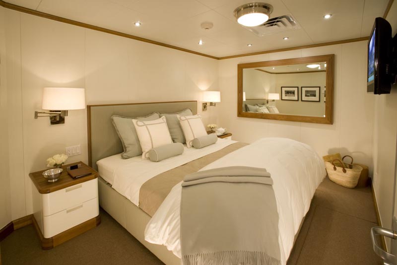

  3. The lower deck is a combination of machinery spaces, storage areas and guest facilities. Forward is the 300 hp diesel powered, direct drive bowthruster. Next aft to port and starboard are large storage rooms with deck to overhead shelves. The following compartments house the air conditioning compressors and MSD system. The fun then begins with a large, fully equipped gymnasium including elliptical machine, treadmill, two Keiser air pressure controlled strength training station, free weights, stretching cage and the obligatory Crestron-controlled LCD TV. Across from the gym is the massage room and beauty salon with a Murphy bed in case additional berthing is required. The steam room, shower and head are access from either the gym or massage room. Forward of the large commercial engine room are 2 guest cabins, one king and one twin, with ensuite heads and walk-in closets.
    Shown here is the VIP guest suite...

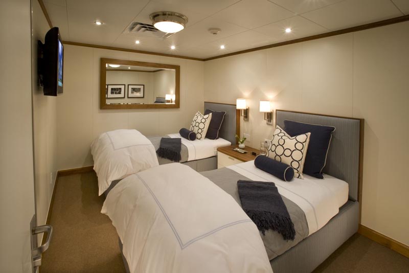

    Shown here is the guest twin, opposite the VIP above...

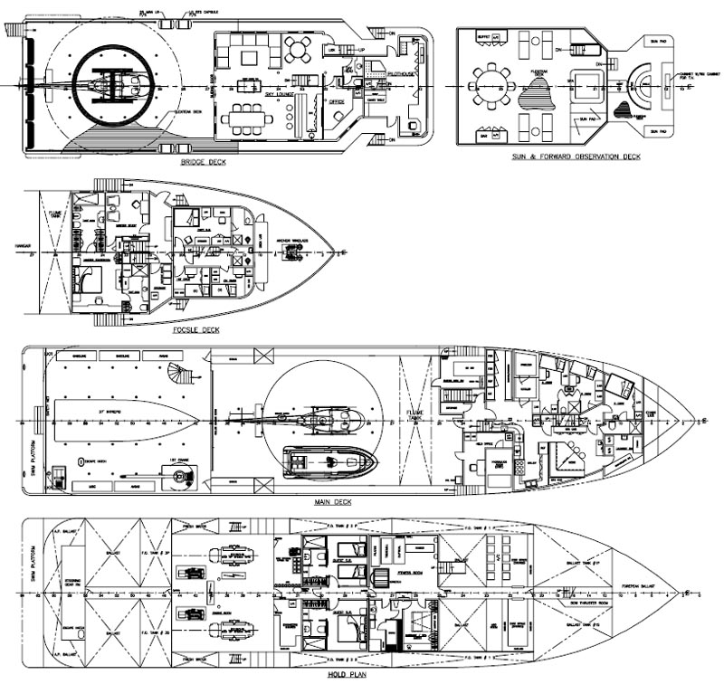

  7. Deck Plans; Top to Bottom...
    1. Bridge Deck, Sun Deck and Cigar Deck
    2. Forecastle Deck
    3. Main Deck
    4. Holding Deck
