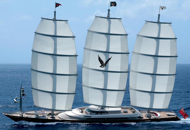

  1. As rigged and sailing, Falcon’s impressive design allows her to sail close-hauled at 45° from the wind, as opposed to the 55° or 60° of the traditional square-riggers of old. Here they show as one complete unit, all holding or changing course as directed by the helmsman at the computer screens. Her masts do bend to a degree under wind pressure, as noted, the 3.5 meters – 11.4 feet at the tip. Sail furling mechanism is worked by the electric motors inside the masts. Perhaps one of Falcon’s greatest advantages over the old style – besides her outstanding freshness and beauty – is her lack of standing rigging; via the DynaRig, invented by the German Wilhelm Drolls.

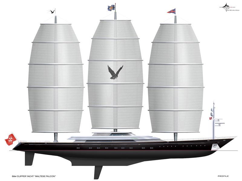

  2. In profile view, the 'Falcon contains many of the same elements as most sailing craft, large or small. The major differences are in the rigging. Each of the three carbon masts are 190’3” (58m) long. Perkins chose Damon Roberts, a practiced Carbospars expert from Insensys, to supervise construction in the Perini yard at Tuzla. Perkins purchased this yard for the project, but later deeded it to Perini.

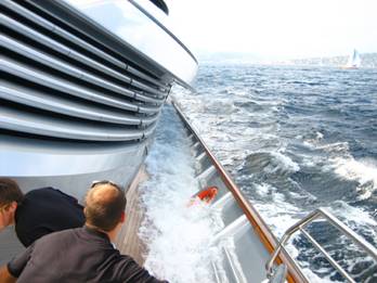

    After 13,000 miles I’m still awestruck. The rig has performed almost faultlessly with only a small glitch in the operating system (designed by Cacini) and a couple of damaged sails (normally due to operator error rather than design or manufacturing fault). We’ve been across the gulf of Lyon twice in a Mistral once with over 65 Kts of wind (max 68) and at one point with only four sails up we hit a record speed of 24.8 Kts. We’ve had the deck under water almost every time we sail (15 degrees of heel) and a couple of times even the capping rail (25 degrees plus).

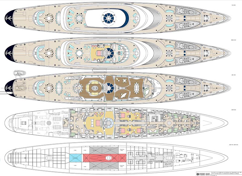

  4. Deck Plans; Top to Bottom -
    1. Plan View
    2. Bridge Deck
    3. Main Deck
    4. Lower Deck
    5. Bilge Deck
