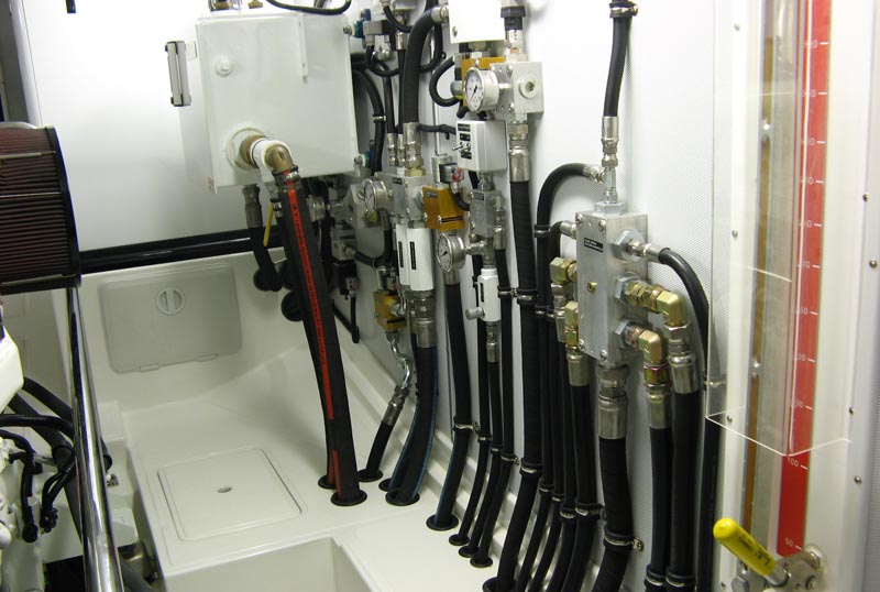

  2. The wing engine provides supplemental power for operating the hydraulic systems. Utilizing the wing engine for supporting the ABT TRAC stabilizers, 12 sq. ft. fins, the Maxwell windlass, the Side-Power 25 HP bow and stern thrusters and the emergency bilge pump allows for the exercising of the engine and subsequent required servicing, so that in the event of actually needing get home capability, the 65 hp engine will be ready to go into rescue action, albeit at 4 knots. At the time of sea trial, there were 200 hours on the Lugger main engine and 49 on the wing for an indication of the use for boosting the hydraulic output. There are 6 intake thru hulls (bronze body with SS balls and Teflon seats): 2 sea chests, 2 water makers, 1 chilled water air-conditioning, and 1 anchor wash pump.

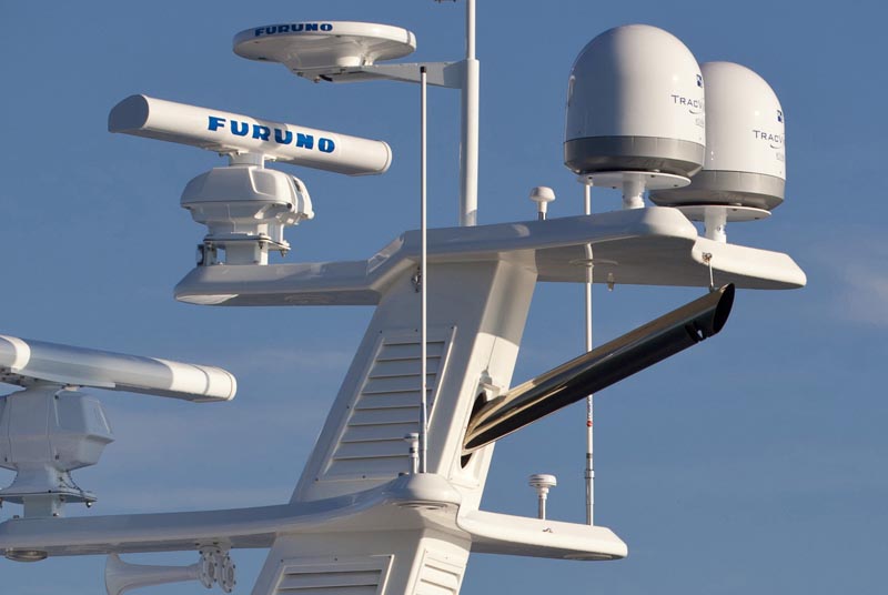

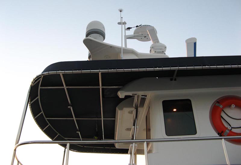

  5. Furuno radar sits high atop the radar arch accompanied by a pair of KVH TracVision bulbs. Just below, the hot-rod exhaust system of the Nordy 63 exits high and aft, keeping decibels as distant as possible.
  6. It's unclear why Nordhavn chose a Stamoid awning for the 63'. While it adds a traditional element, it also adds long term maintenance. The roof of the upper deck was designed as a flat platform to hold a bank of photovoltaic cells, but the awning reduces the available area.

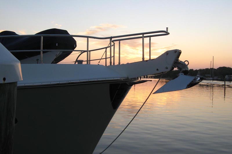

  7. A polished Delta-style anchor is the N-63's hood ornament...

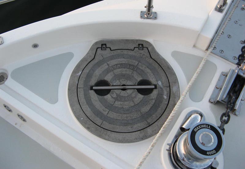

  8. About the only component found that was not of the highest quality is the defacto standard Freeman Hatch, which is of course a rough sand casting, leaving a porous finish that absorbs everything. In this case, remnants of white silicone or paint.

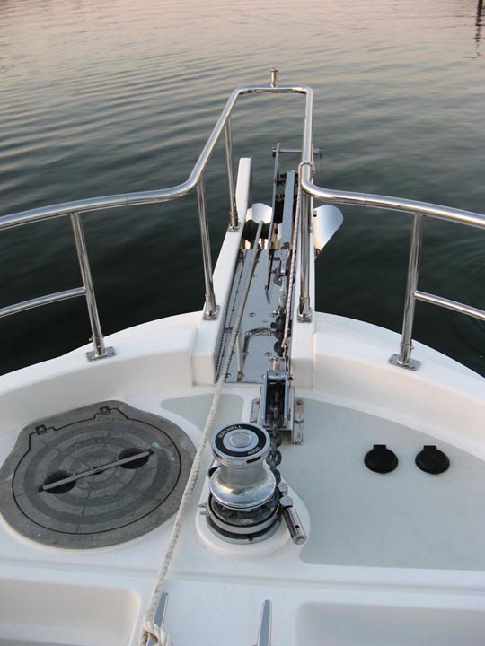

  9. Anchoring is provided by double bow rollers accommodating a 170lb anchor and a lighter secondary anchor. The chain locker is a watertight compartment although there are some penetrations at the top.

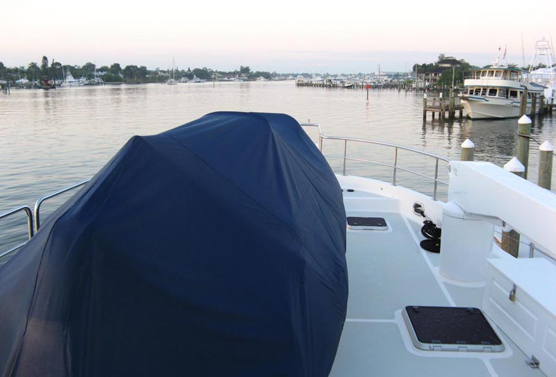

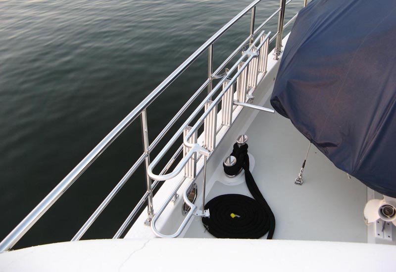

  10. Because the owner chose an oversize tender, access to the boarding ladder was limited.
  11. Rib in a blanket! The foredeck of the N-63' is very large for its size, but an oversize tender overshadows it and frankly, takes away from the N-63's otherwise trawleresque lines.

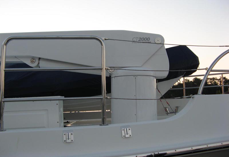

  12. The Steelhead CT 2000 telescopic crane is ideal for launching the Nautica 15' tender, or hoisting heavy provisions.

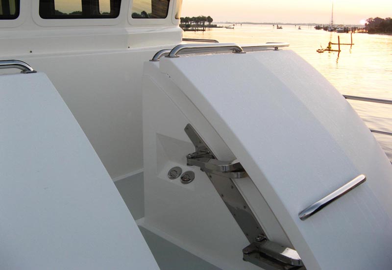

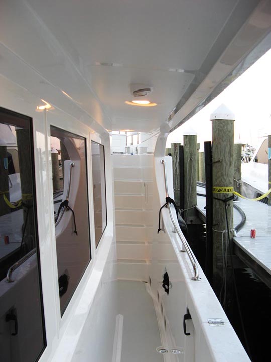

  13. The foredeck is accessed by way of 8 steps up from the starboard side of the main deck or from either of the sidedecks from the pilothouse through the centerline Portuguese bridge pantographic gate.

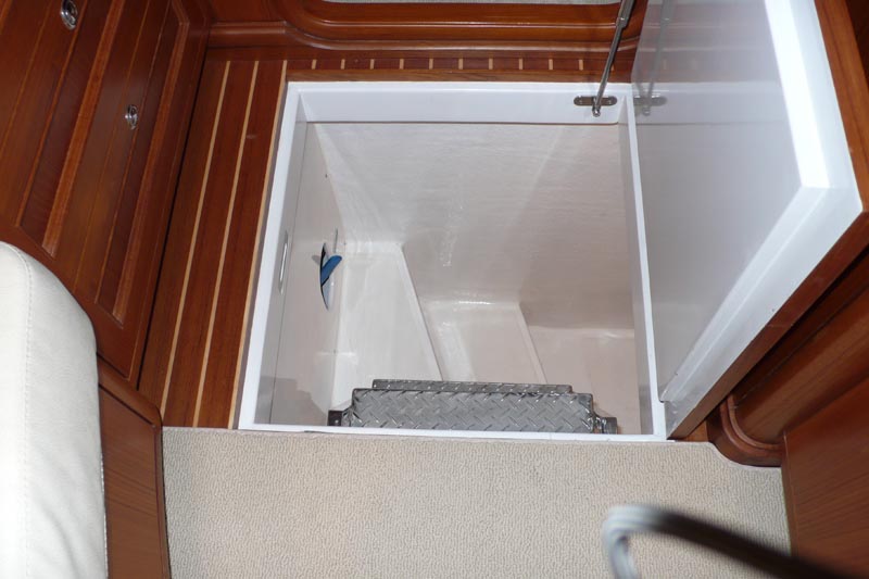

  16. A real surprise found in the guest cabin is the basement. At the entry to the stateroom by the settee is a floor hatch that opens to a large storage area. While this supplies convenient housing for the watermaker, bow thruster, and other components, it also becomes a great wine cellar and stash hole.

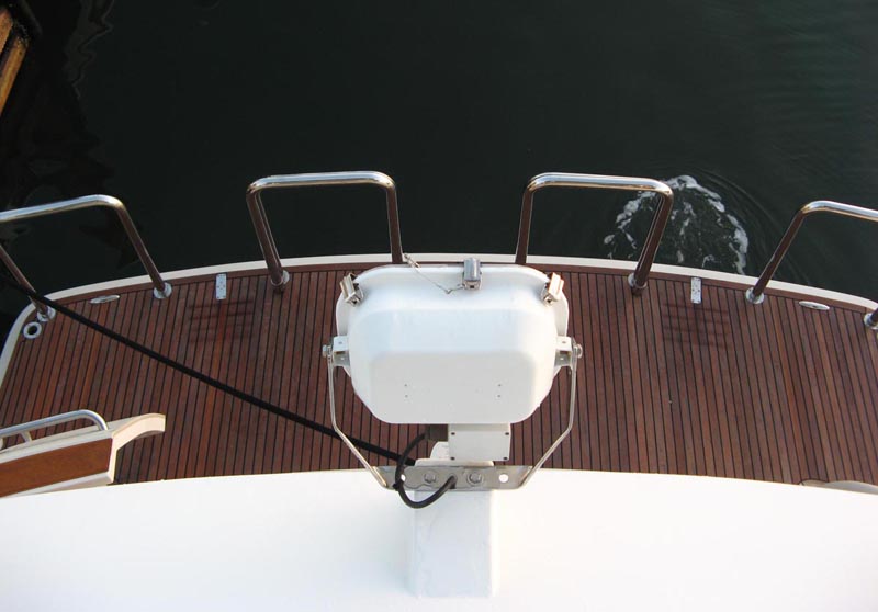

  17. As we come to the tail end of this review, we hope we've shed a little light on the new N-63 for our readers, much like this spreader light for the stern...
