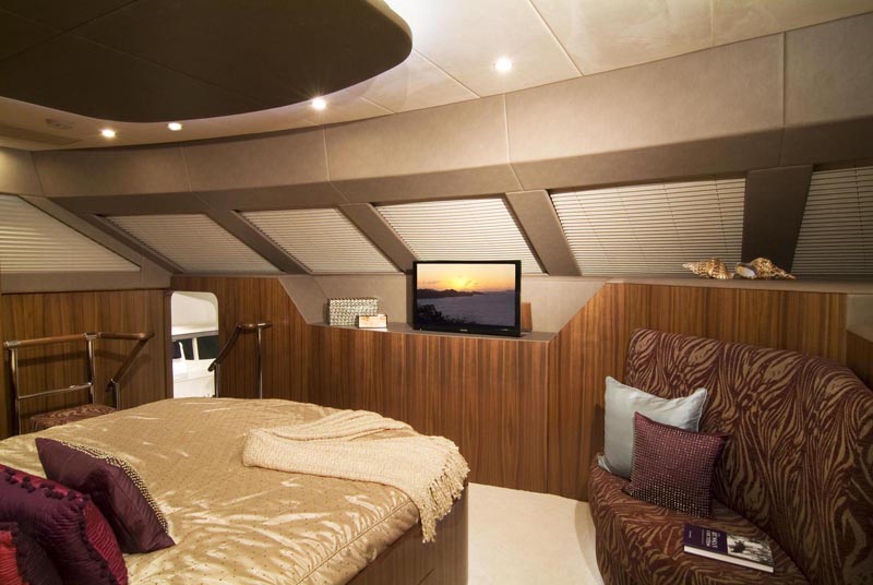

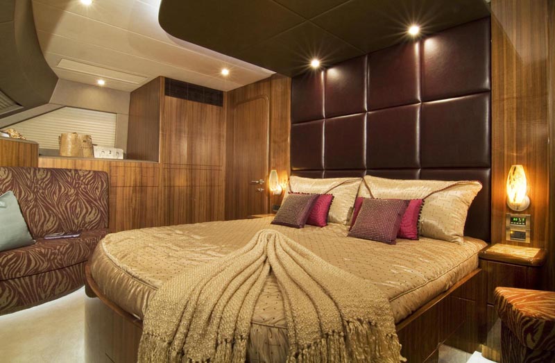

  3. Her rhythm in decor continues in the Master Stateroom with soft neutral tones. The PC-58 is one of only few catamarans in production with a main deck master. With most cats, headroom is often limited to the vertically challenged. Not the case with the PC-58. Soaring ceilings, coupled with a 180 degree forward view, are reminiscent of some much larger vessels. If you look closely at the paneling, you will see the outlines of drawers, closets and lockers. Storage is abundant, seamlessly hidden behind walls, but it's not limited to the master. The entire boat is a maze of well-planned storage compartments. See DETAILS following the review.

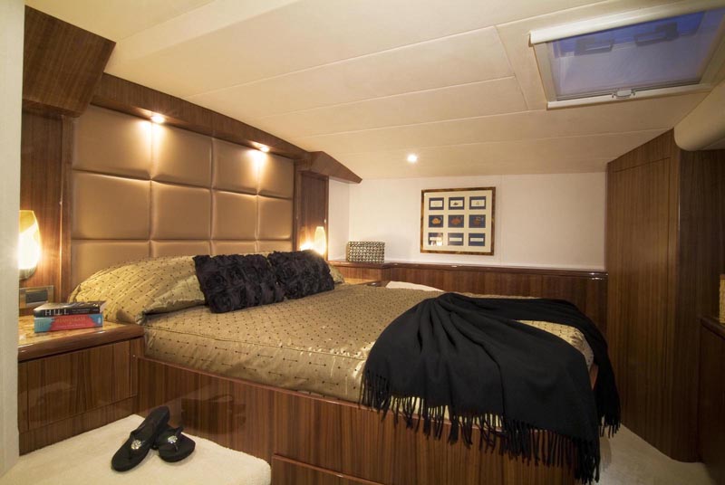

  4. With well chosen patterns and a leather-covered headboard, the master grants a "one with the surroundings" feel. Although the blinds were drawn for these shots, she glories in 180 degree views through wrap-around tinted & tempered windows. Sporting a king size walk-around berth, she also offers reading lights, cabin lights, as well as night stands w/cupboard, light switches and multiple outlets. There’s a bed-side settee plus large separate closets for clothes, towels, linens. And finally, the mattress is hinged, raising to reveal more storage space.

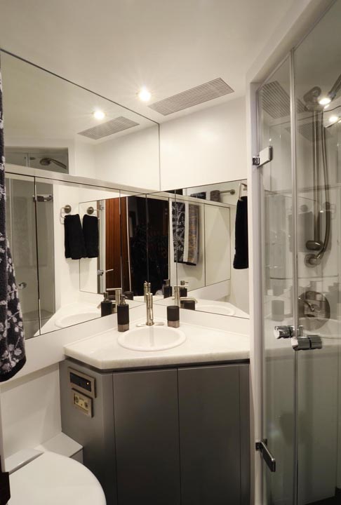

  5. Quite possibly the most exquisite use of space we’ve seen on a cat is the PC-58’s Master Bath. Finally, someone got it right! Believe it or not, there’s adequate room for a couple to get ready, together. It features a separate toilet (not shown), a raised wash basin, cabinets & drawers galore. An ensuite walk-in shower with seating finish off this sponson with a surfboard. I’m 6’2” and had plenty of headroom. A large oval window allows light and outside views. With 110V 20 gallon hot water heater and 400 gallon fresh water tanks, there are no sponson sacrifices in the master bath.

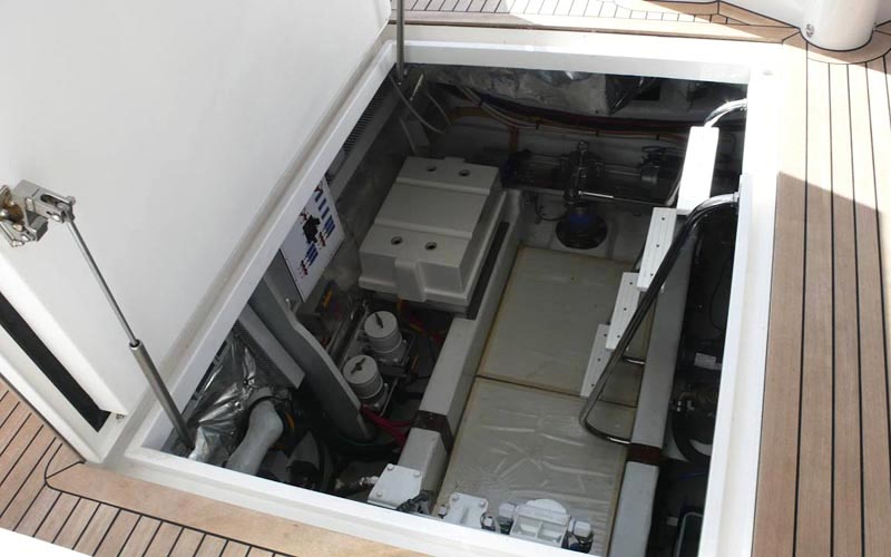

  11. ENGINE ROOM(S)​

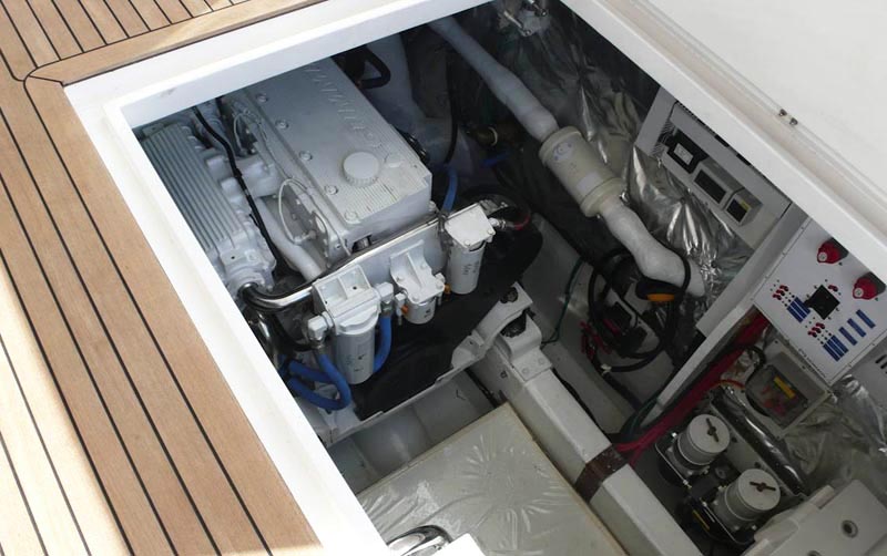

    Engine room access is via exterior, aft deck hatches. If you've ever had to wrench on an engine underway, you'll appreciate the immediate access and quick ventilation this location offers. But there is yet another benefit to this location... sound insulation! The engines are located far aft of the superstructure and accommodations, removed from items sensitive to vibration and nestled in layers of insulation.

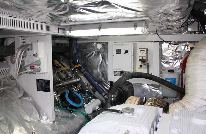

  12. This image is looking aft at the starboard engine hatch. Take four short steps down the ladder and you're surrounded by everything that counts, including immediate access to Racors, control panels & oil change pumps. Getting to the glow plugs is a little tight, but we've been aboard bigger boats with tighter spaces.
  13. Horizon didn't skimp on insulation. The angled wall you see in the lower left side of this image is the inside of the cat's tunnel. Why apply sound deadening material here? Because engine vibration transmitted through this wall will echo into the tunnel (outside, under the hull), which will transmit throughout the boat. The result is one of the quietest rides we've ever been on. Twin Cummins QSM11 705HP diesels spin a set of stainless shafts, sealed by Tide.

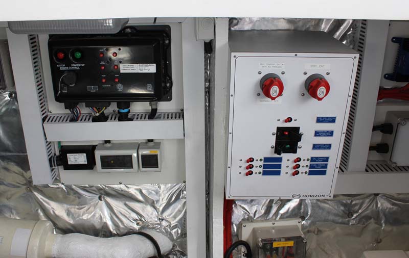

  14. Down the four step ladder is everything that matters; an Onan 21.5Kw(60Hz) generator with Sound Shield and air/water separator, Sea-Fire automatic fire extinguishers, fuel transfer pumps, chilled water air conditioning compressors and circulation pumps, as well as AC and DC distribution panels.

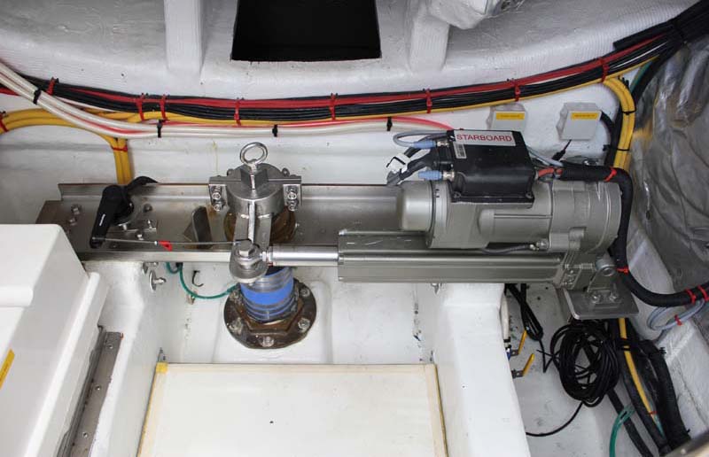

  15. A close-up of the guidance system, the PC-58's power steering assembly directs a pair of stainless rudders. During our sea trial, response was immediate and tracking was excellent. This boat requires very little input to hold true course, which is also a by-product of twin, narrow chord hulls with keels.

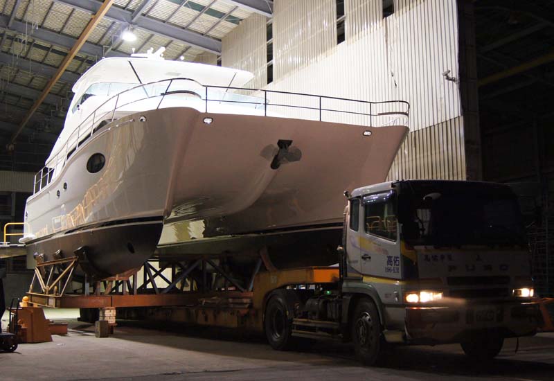

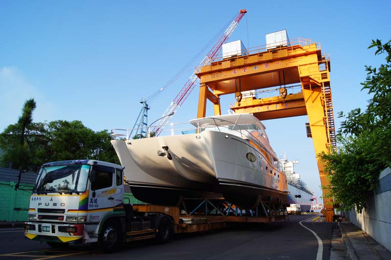

    The following series of shots were taken during the initial transport and launch of Horizon's PC-58 catamaran. I'm supplying these shots to provide a better understanding of the hull design, along with some video links to hull testing and offshore running footage. In this first shot, you can see a spray knocker just above the boot stripe. It's very effective, as you will see in the video links supplied. This is a very dry running boat.
  17. The sponsons are wider than one would expect for a 58-foot cat, leaving realistic, human-sized space for lower accommodations. The entry of the subsurface hull compensates for the width of the sponsons, then gradually tapers back to full planing surfaces. This combo gives good penetration forward, as well as added lift & stability aft. Backing down the slipway, the reflection of the bushes along the side of the hull mirror the finish on this boat.

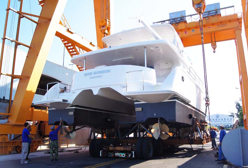

  18. Horizon Yachts is using modified flat-tunnel pockets that reduce squatting, but still offer ventilation properties. Note the tunnel clearance here. This is an important consideration when comparing catamarans. Freeboard is your friend! In yet another well-engineered hull dynamic, even the swim platforms offer buoyancy. Why does this matter? At rest, this will help further isolate lateral motion. If you study this carefully, you can barely make out the keels behind the cradle. They extend down to the same level as the props.
