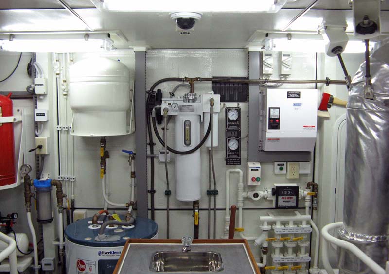

    Aside from the 6’5” headroom and gargantuan size in general, noteworthy features include the centerline stainless steel work station and sink, meticulous labeling on all pipes and equipment, excellent wire bundling, and the sea chest as noted earlier. The sea chest intake picks up for the air conditioning (seven air compressors), the two main engines and the two 20kW generators. The discharge posts, standpipes, are for the air conditioning cooling water, galley sink, dishwasher and engine room bilges, where the ac condensate flows. The only other thru-hulls are for head discharge.

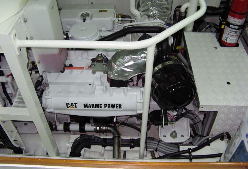

  2. The engines are continuous-duty; D-rated 315 hp and are each surrounded by a safety rail for working in all sea conditions. The fuel system is simple and redundant. There are two saddle tanks, a forward and aft tank, and a day tank. There is a manual and electric fuel transfer system, primarily used for adjusting trim; the feed into the day tank is manual, electric, or by gravity. The exhaust risers are simple yet well supported and a testament to the Cheoy Lee engineers. The wet exhaust exits hull-side just below the waterline, with barely audible subsurface gurgling without the soot.

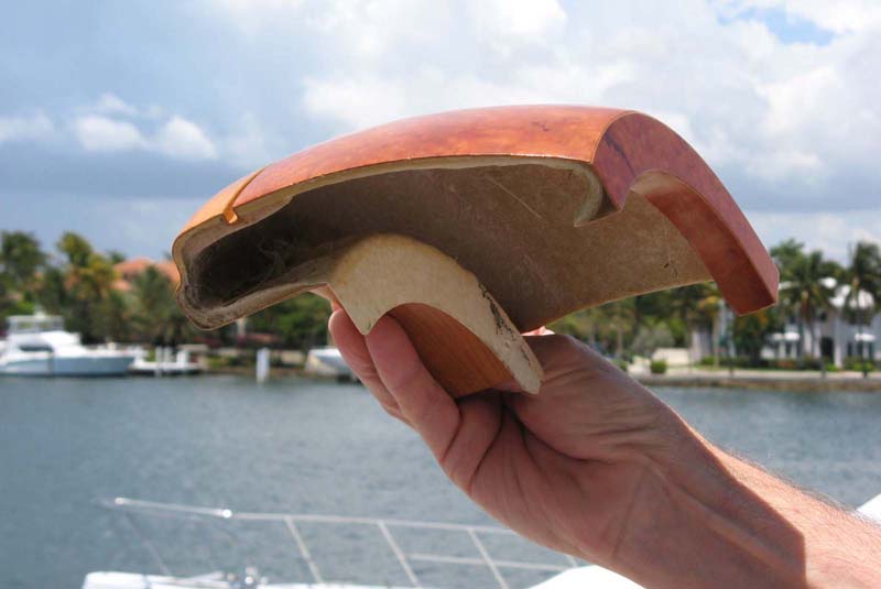

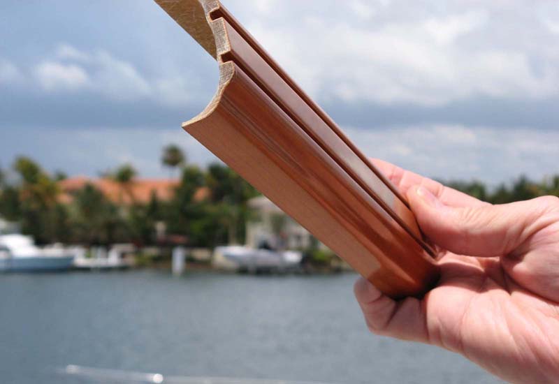

  6. Improvements throughout the yacht are evidenced by technological innovations. For example, the trim is comprised of a teak veneer over a resin-infused FRP base. Amazingly, it is seamless, even on compound curves! Why go to all this trouble to simulate wood? Because fiberglass eliminates the potential for water absorption, swelling, warping, flexing or any of the other detrimental potentials present in wood. Although this costs significantly more to manufacture, it affords durability and sound reduction, as well as significant weight savings. Look closely at this picture. This is a crown molding corner piece... and it's NOT wood!

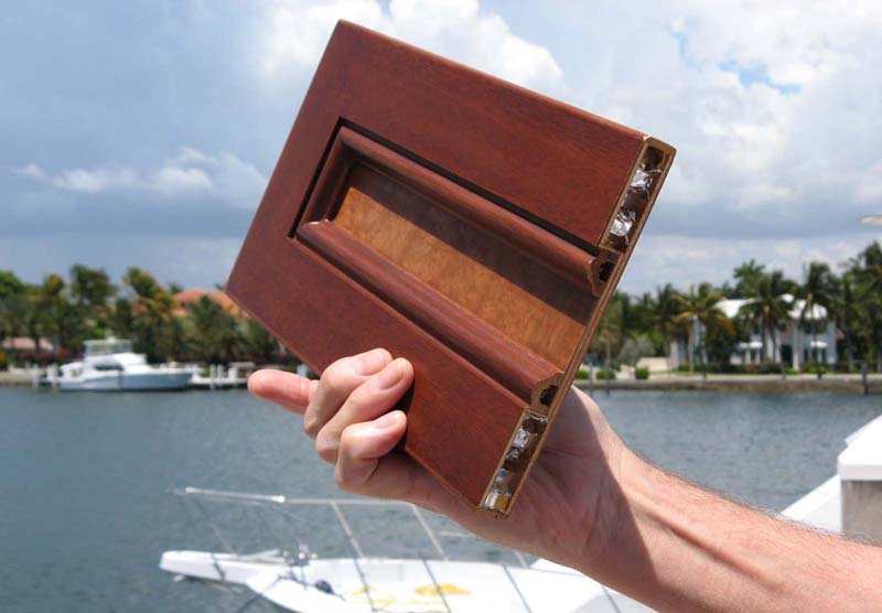

  7. And yet another example of weight reduction, while maintaining the strength, solidity and look of real wood, this cabinet door cut-out simulates mahogany and burl wood. Using an aluminum honeycomb laminate for support, the fiberglass panel is covered in a veneer process that is super lightweight and structurally rigid.

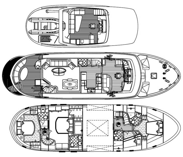

    Deck Plans: Top to Bottom...
    1. Flybridge
    2. Main Deck
    3. Lower Accommodations
