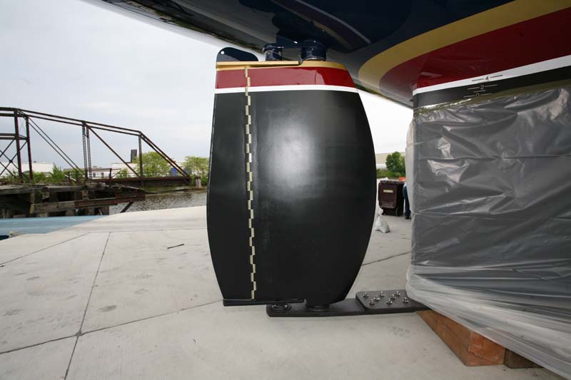

  1. Due to Sycara's twin engine, solo rudder configuration, an articulated rudder was incorporated. This is a hinged-tab system that extends farther into the thrust line to provide increased deflection. Moving the massive tab is a Jastram steering system. And when the going gets tight, a pair of duo-prop Quantum thrusters, both fore and aft, swing Sycara on her axis. A 20" QT120 with 116 hp points her sprit a 12" QT30 fans the tail.

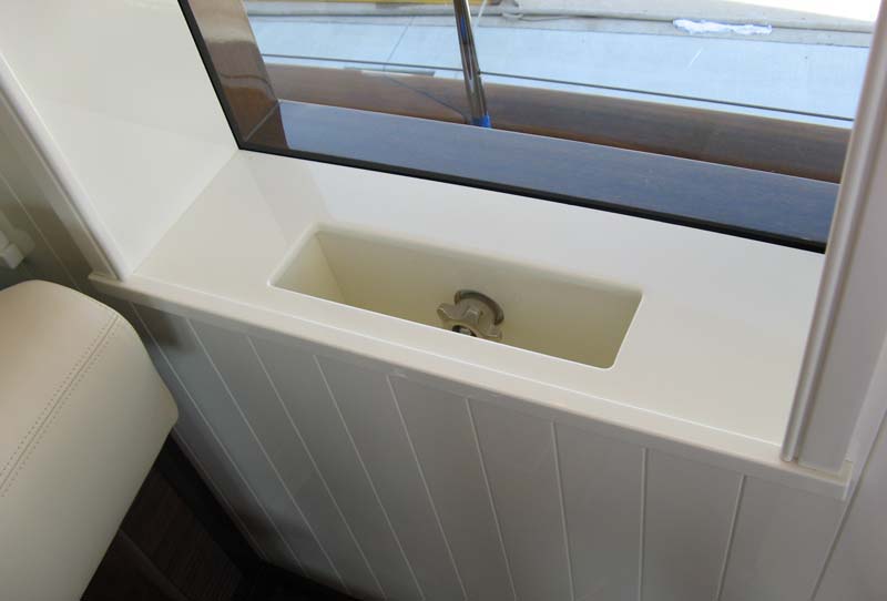

  4. What's this? It's a knob for rolling down the side windows on the bridge. When was the last time you saw roll-up windows on a boat? Also, notice the lapstrake walls and ceilings throughout the vessel. In the old days, this would be tongue and groove. Nowadays, it's plywood core with an HDF skin to accomplish the effect.
