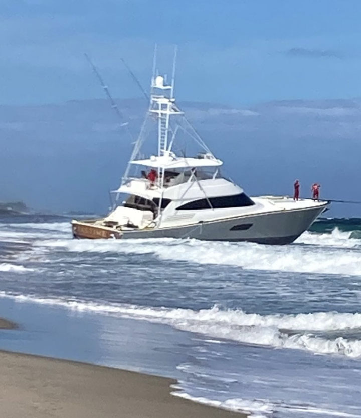

    Surprised nobody posted this.. no idea what the story is but…
    CSWO likes this.
  2. Norseman
    Norseman Senior Member
    Feb 24, 2005
    2,938
    They lost power, and was unable to deploy the anchor, according to internet gossip.
    It should be off by now.
  3. Pascal
    8,167
    If hydraulic windlass, no power = no windlass but still should have released. Now of course pretty much all SF have ridiculously small anchors so considering the conditions it would have helped much.

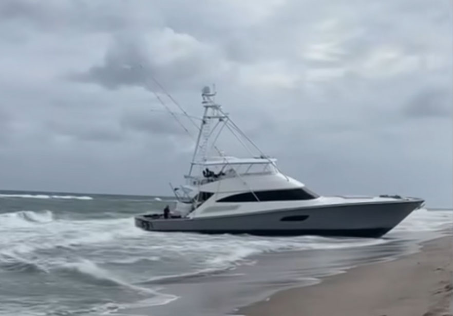

    A video showing the rescue , looks a bit rough, but nothing extraordinary..
    I have always thought it was nutty not having proper railings and handholds all the way around these sport fishers, or any boats, as anchor handing could be compromised in challenging conditions.
    (I sure don’t think it looks good or sexy with a naked foredeck, is there a reason, like a fishing reason for it?)

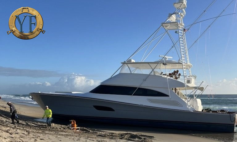

    curious why they were trying to pull it off the beach from the bow? Looked like stern was floating when waves came in. Seems like it would pull easier from stern? Maybe they were worried about waves swamping over the transom?
  10. Liam
    Liam Senior Member
    Jan 13, 2010
    637
    Malta
    More that the transom will dig deeper for a few reasons, first for its vertical shape, also with the pulling the stern will dig lower and ultimately create a larger problem, with the propellers and rudders buried further in sand.
    An idea would be to try to lift a bit the stern with some air balloons and pull her from that way, creating a serious of balloons to keep her lifted. They need to be huge cause the video and photos do not actually picture the real size of a 92 feet sized vessel.
