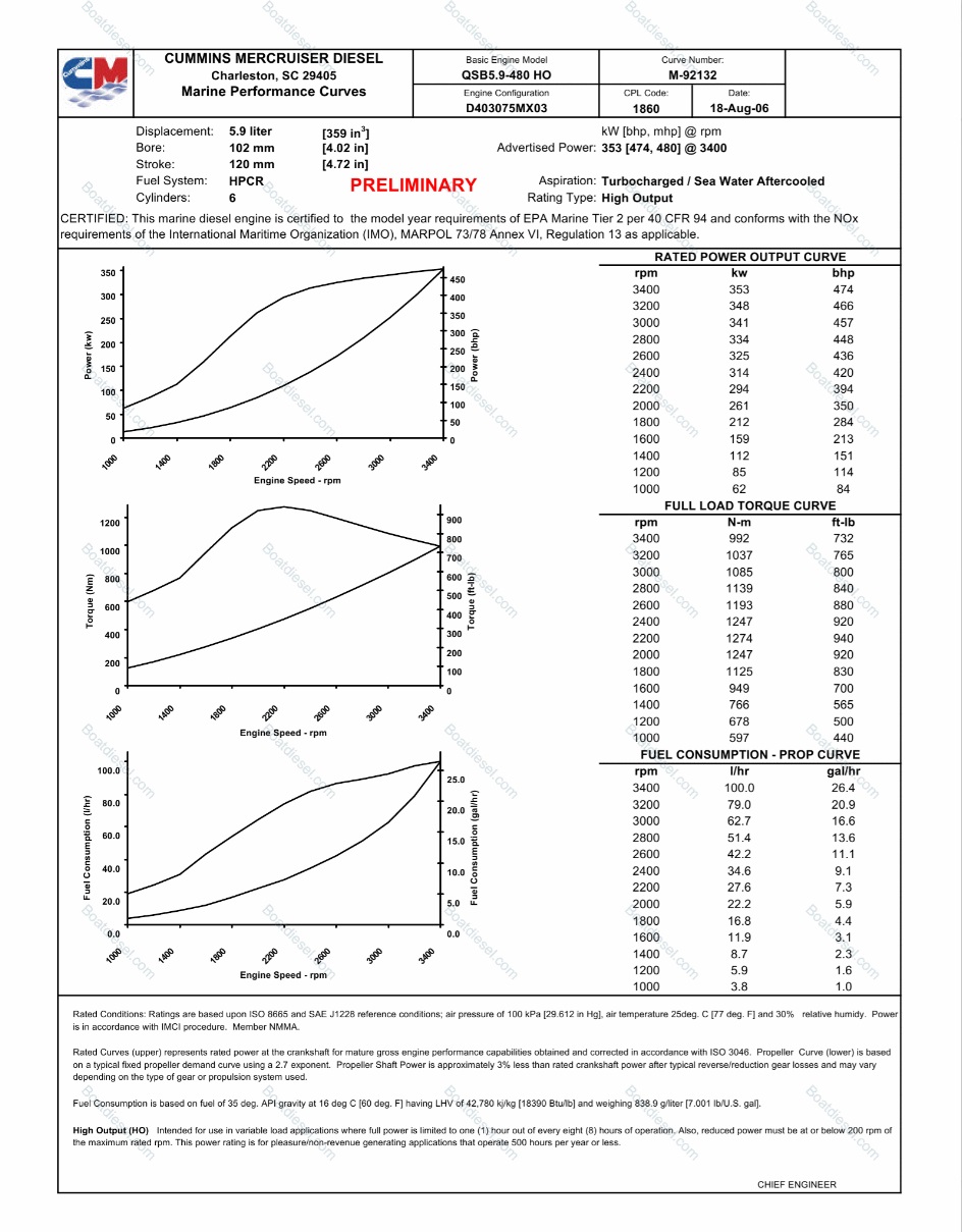

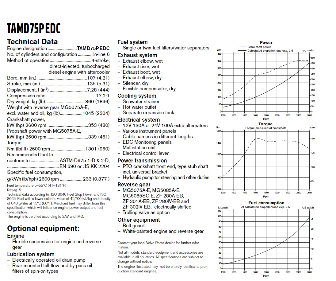

    To investigate further, I pulled up the data for each engine
    The original Volvo TAMD 75 makes 480 hp and 960lbs of torque at 2600 rpm. max torque at cruise speed (I'm guessing original cruise speed was 2000 - 2100 rpm) is about 1050 ft-lbs. max rpm is 2600.
    The current Cummins QSB 5.9 makes 480 hp and 800lbs of torque at 3000 rpm. max torque is 960 ft-lbs at 2200 rpm. max RPM is 3400, but I see on the forums people running them at 3200 max to be safe.
    I pulled up the hp/torque and prop curves to investigate. ill attach the data sheets.
    from the data we can see that:
    1. Volvo torque curve flattens out from from 1600 to 2400 rpm where it makes about 1000 to 1050 ft-lbs torque over that rpm range
    2. Cummings torque curve isnt as flat. it makes 830 ft-lbs torque at 1800 rpms, toque peaks to 940 ft-lbs at 2200 rpms, and then makes 840 ft-lbs at 2800 rpms
    I'm a little foggy on this, but as I understand it (correct me as needed), prop demand will be significantly less than peak engine output in the cruise rpm range. so even without any transmission or prop changes, the Cummins engine could still run the boat.
    however the concern is to not overload the smaller engine in the cruise range, which could happen if the prop was too large.
    We want the Cummins engine to reach peak rpm around 3200 and be fully loaded at that rpm. the measured fuel burn of about 25 g/h at 3200 rpm is about right from the engine data sheet.
    We want the Cummins engine to be running at no more than 80% of peak output in the cruise range. the fuel burn rate of 12 GPH at cruise is 50% of peak burn rate of 25GPH, so that seems ok.
    The fact that the Cummins is able to get to 3160 rpm and also be running at full load (based on observed fuel consumption at that rpm), would make it appear that someone did change or rework the prop (or possibly change transmission ratio?) to accommodate the different engine.
    At cruise rpm, it looks like the Cummins is making about 10% less torque than the Volvo. this is significant, however I would think that could be adjusted for by reworking the prop or changing the prop.
    Transmissions are the ZF280IV with 2.063 ratios, as was listed on the prior survey.
    I will research these further.
    Maybe someone who better understands prop matching than me can take a look at those data sheets and advise.
    I also plan to call Seaboard marine and send them all the numbers and data and get their opinion on it before purchase.
