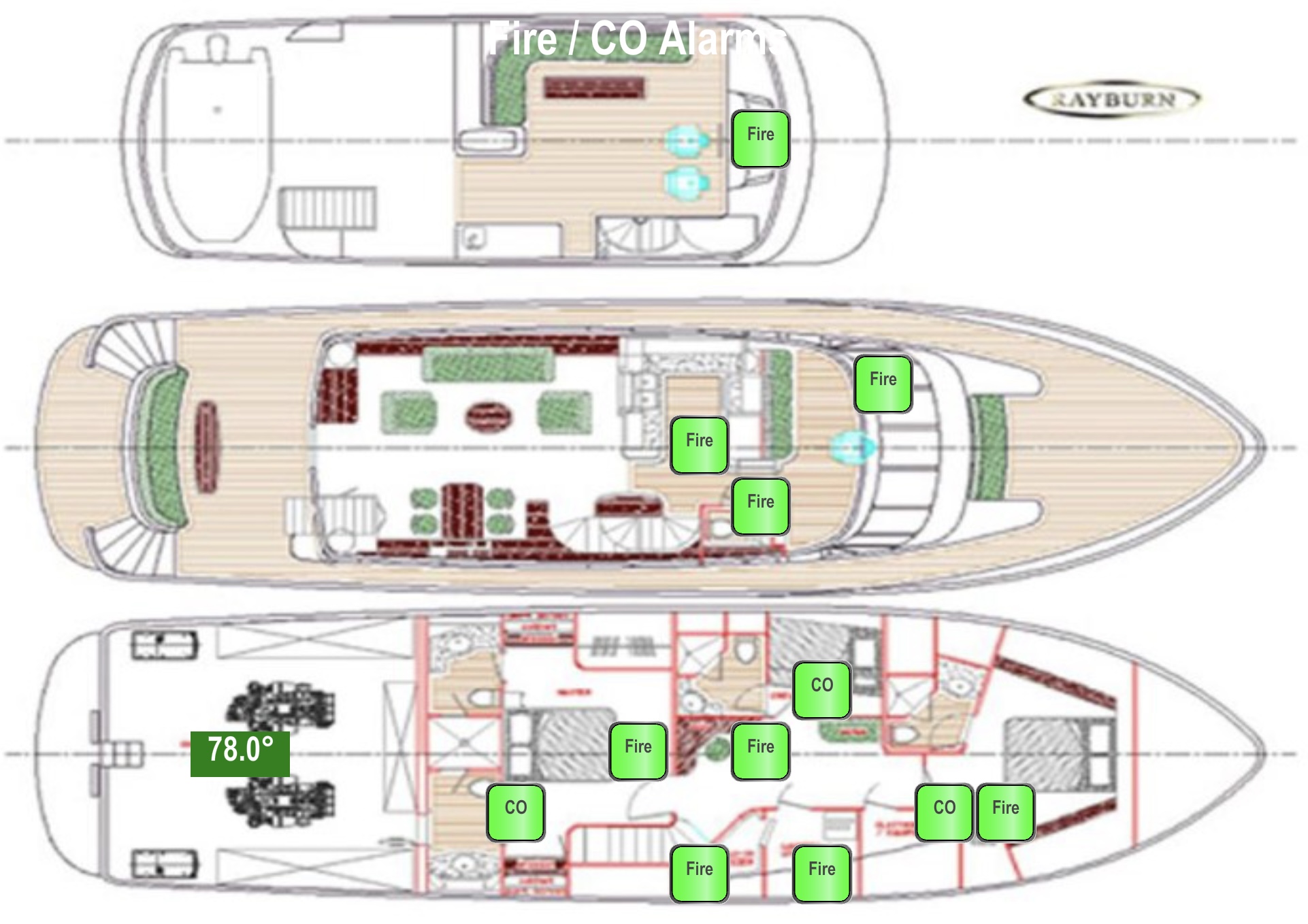

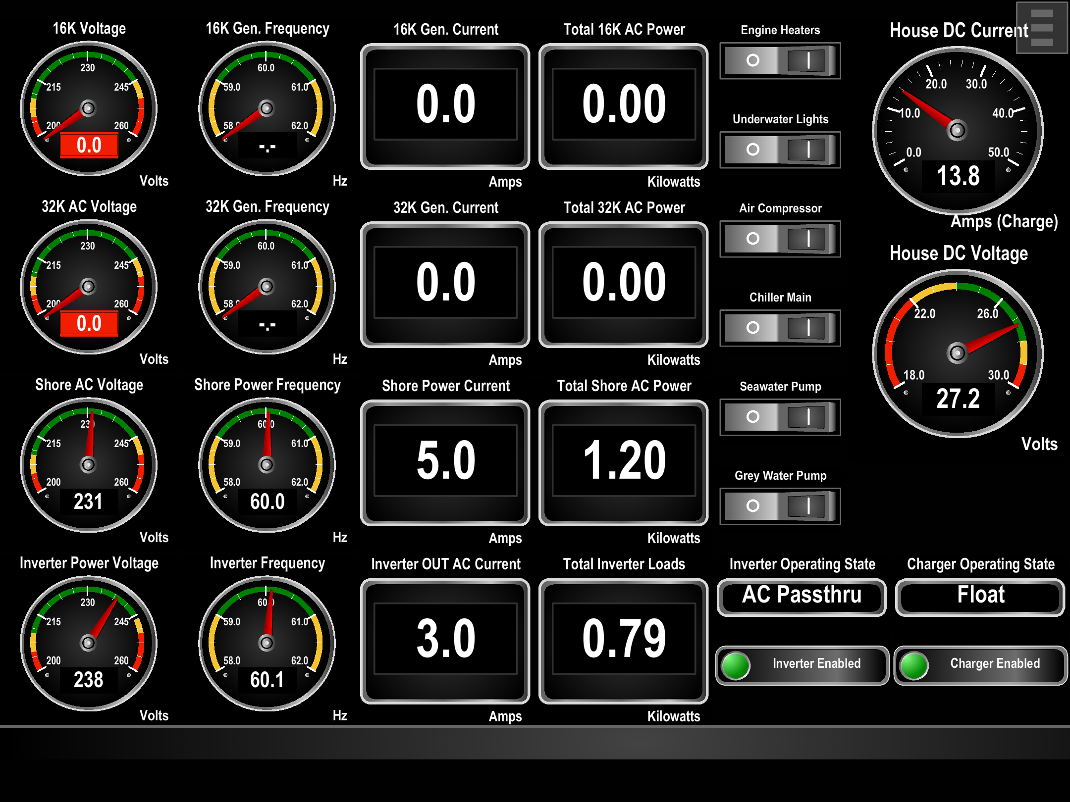

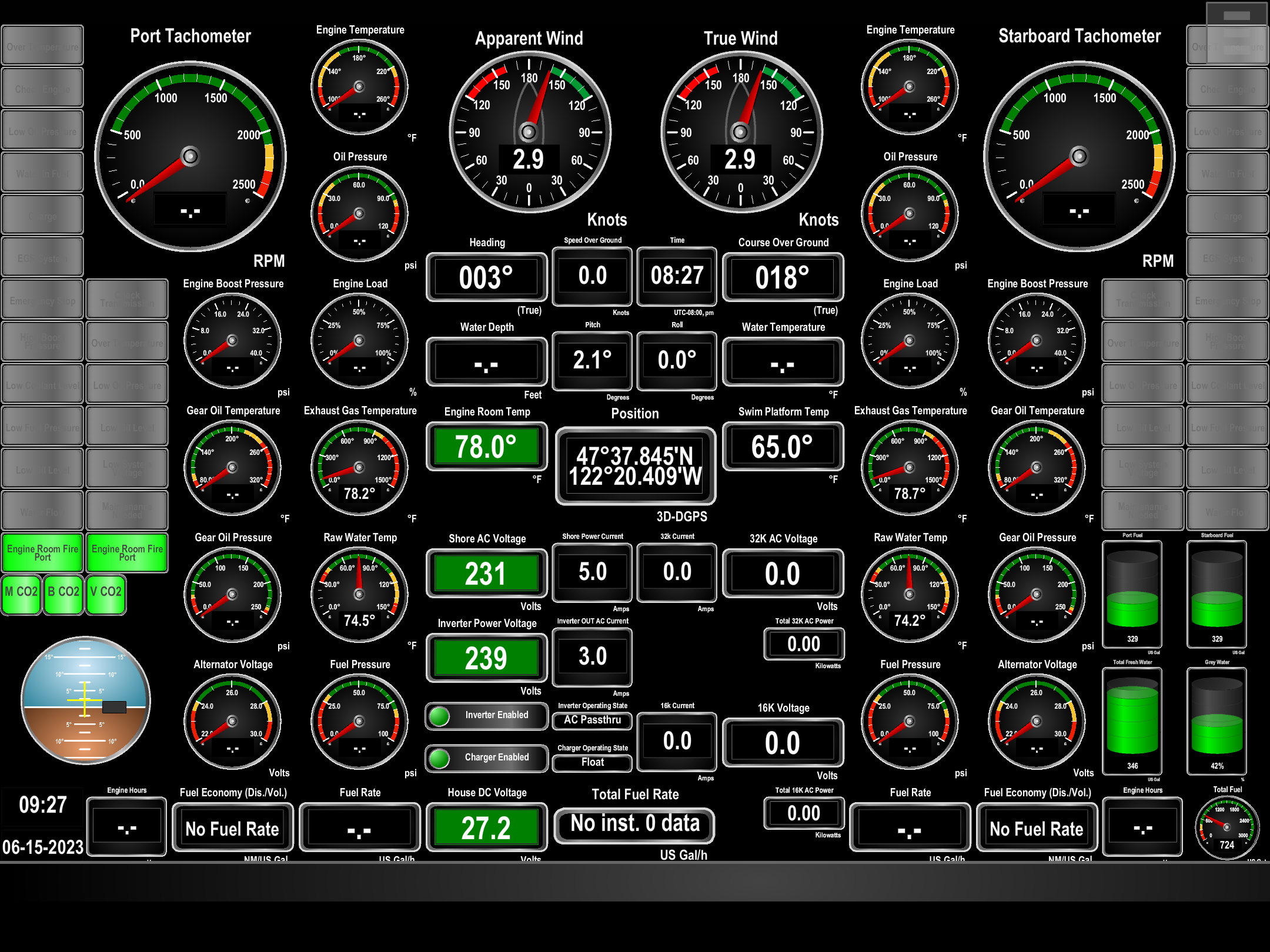

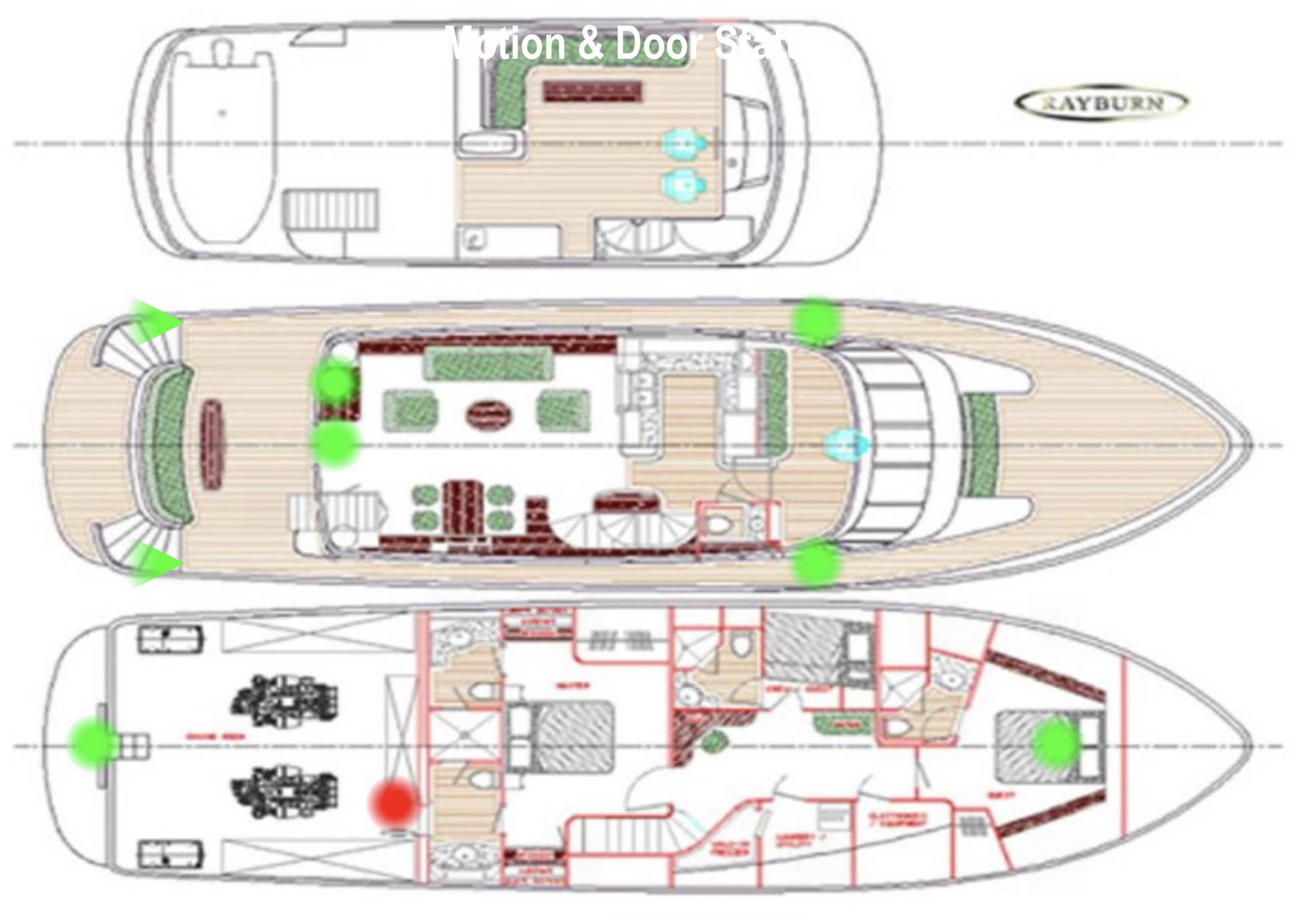

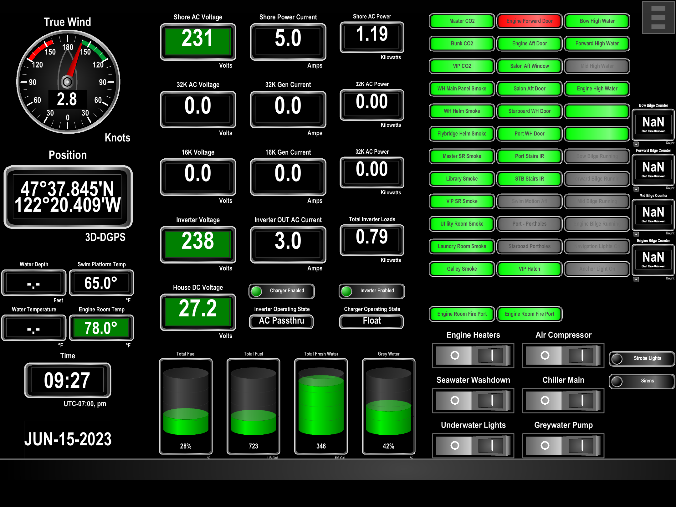

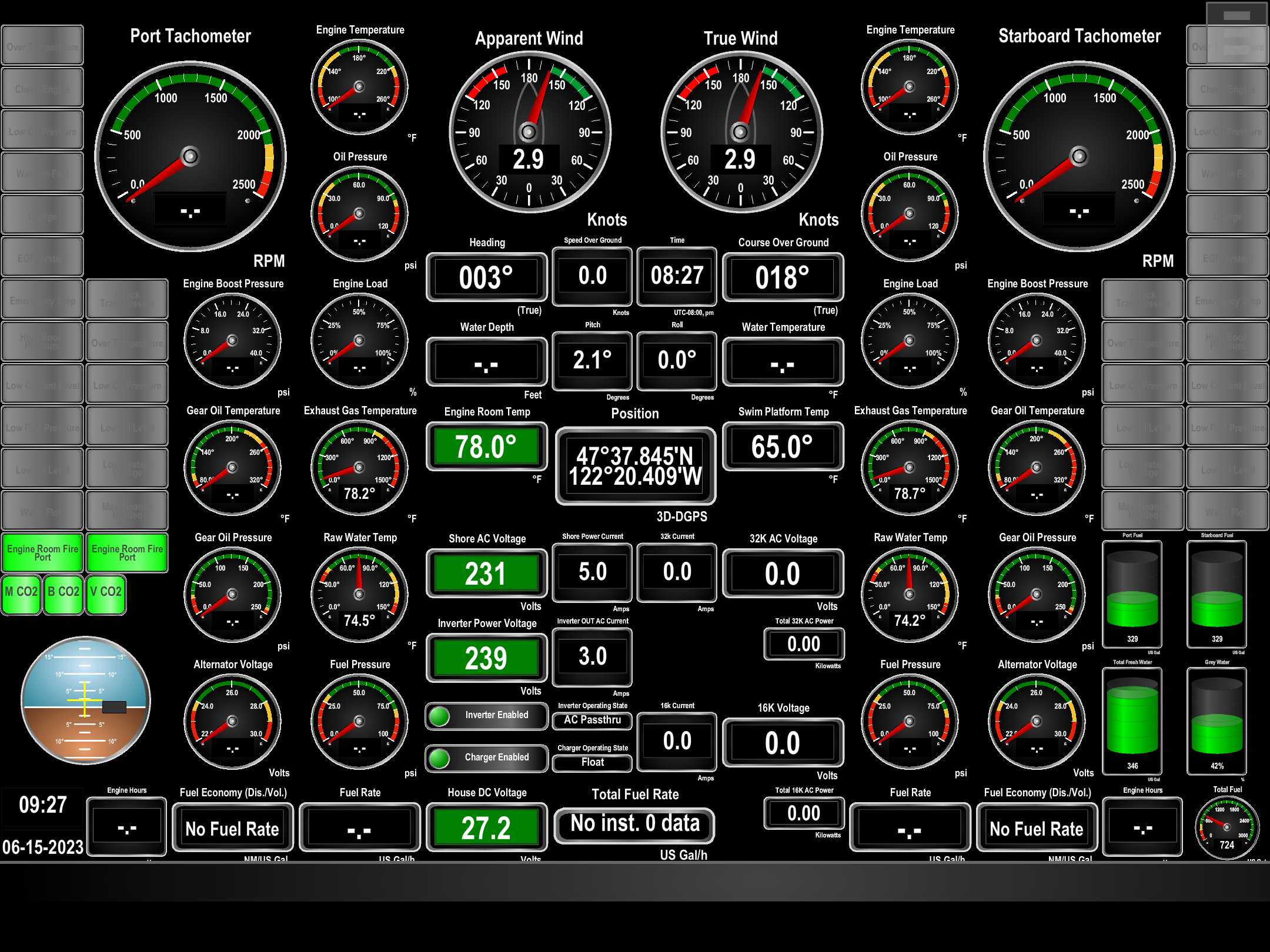

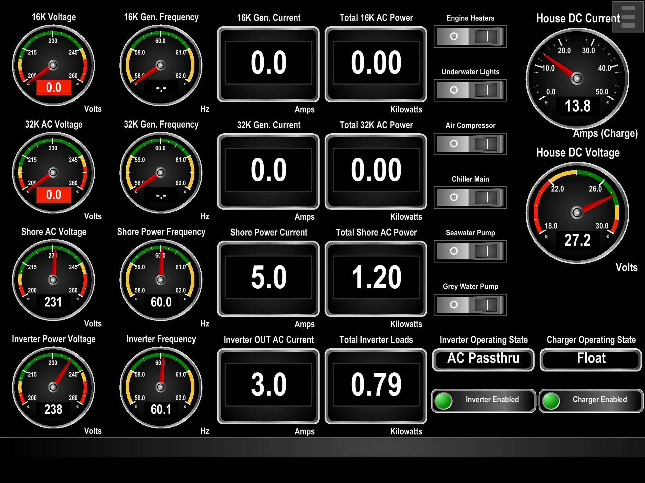

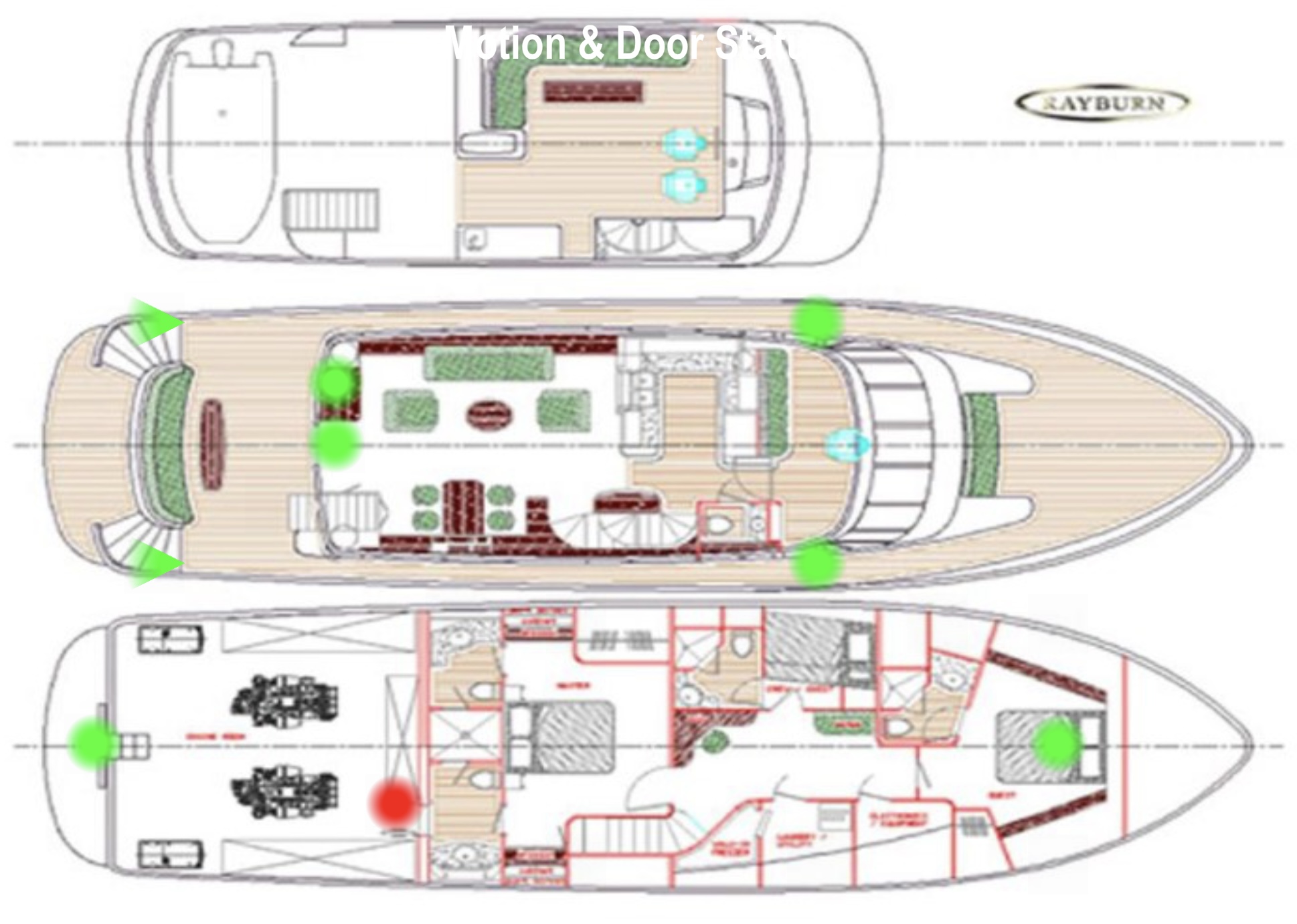

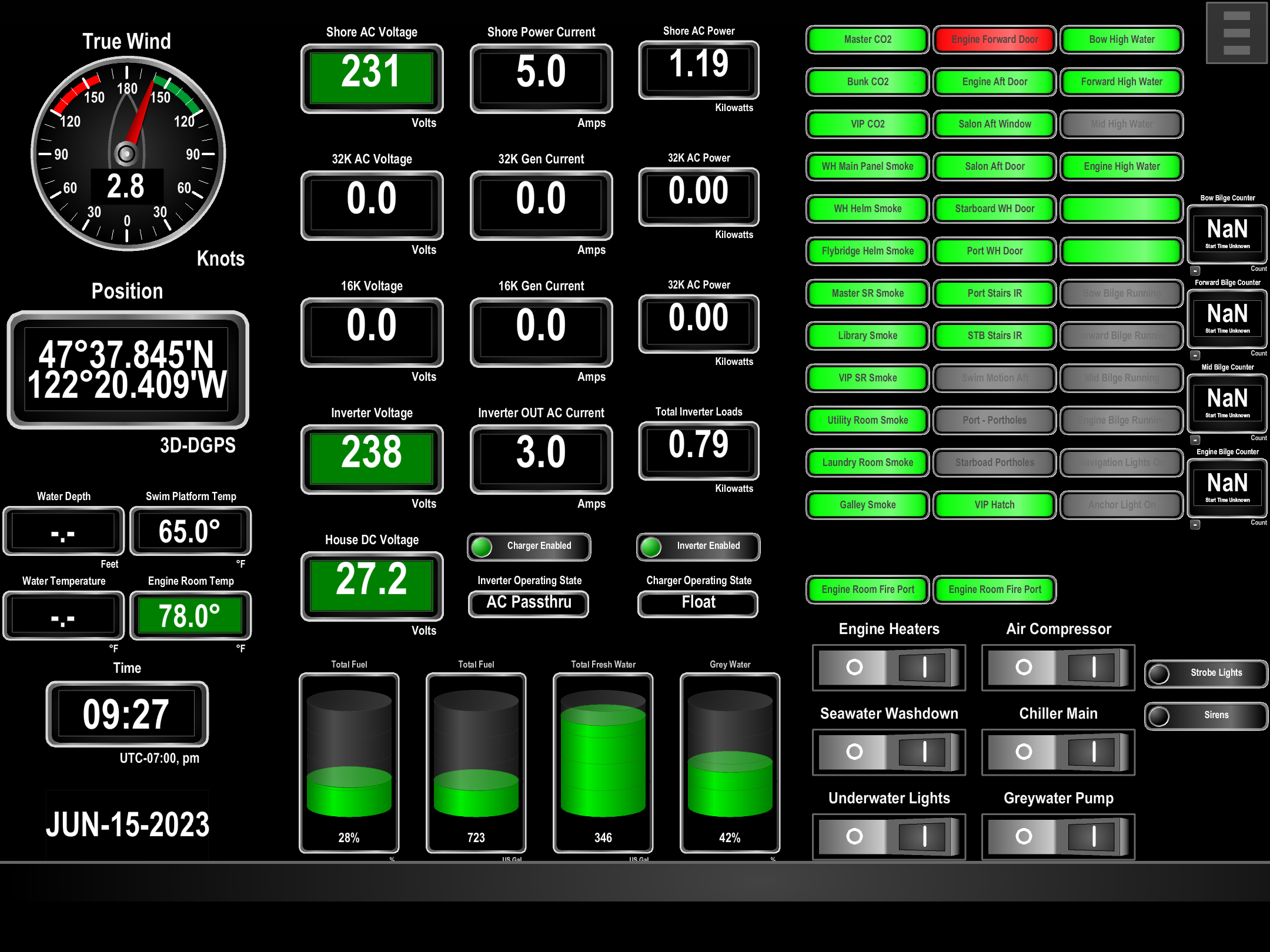

    Yes, I actually did a pretty extensive Maretron system. Added SIM100 devices to monitor contacts for doors, smoke detectors, Motion Sensors, Bilge high water sensors and CO sensors. Also dropped in tank sensors to all 4 fuel tanks, fresh, and grey water. Hooked up sensors to all 3 ac systems (shore, and both gens), as well as dc monitor. Then added temp probes for engine room, egt, raw water sensors to detect failing impeller etc. Run indicator modules to track bilge pumps, and one of my favorite, used DC Relays to and relay contactor breaker switches to control many AC circuits on the vessel. I can now from anywhere turn on engine heaters, the chiller system, Air Compressor (for horns), underwater lights, sea water washdown etc. I also put on J1939 sensors to feed in all the cat and twin disc data. I must say i am VERY happy with the results. I love that I can just have an ipad running at home on my desk constantly displaying my Moored screen (top pic below). I can instantly see what's going on, if power is out etc.
    The vessel made it pretty easy. There was a central utility room with hard wires run to every door, window, port hold, high water sensor, bilge pumps, CO, Smoke detector etc. Just had to tone out a ton of wires and it went together well. Then got a NMEA drop into the engine room and could wire up the rest pretty easily. Also added some automation like detecting when grey water tank is 60%. Hooked up strobes, and sirens as well for added functionality. There is so much that can be added, and the interface to program / set everything up is pretty straightforward and intuitive. (ok, I spent my life in tech so that certainly helps)
    I have a few more things I will continue to add and tweak, but overall I'm pretty happy and I think I have maybe around $8k total into it including nice big bright touch screen monitors that look great next to the big Garmin screens PO put in.
    Here is a look at some of the screens I have setup. I have alarms set to trigger based on a ton of events. While underway, moored, and away from vessel.
